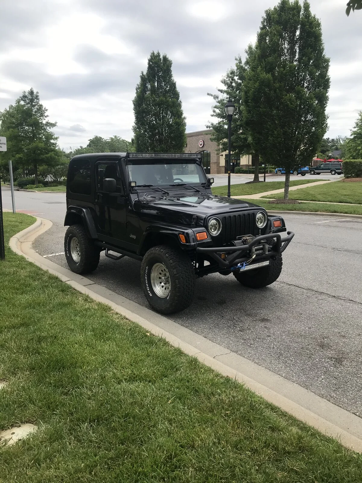

Bought a new to me 2003 Sahara a few months ago. Kinda bought it on a whim and had no idea how much it costs to have a Jeep regeared. It underwent a frame off restoration two years ago, very fresh build just ratty stock paint since he was aiming for more of a trail rig.
So far all I’ve done to it is replace a few lights and replaced transmission pan gasket since it was leaking. Turns out a few holes were stripped but they happened to be 8x1.25 which are the same as Yamaha superjet cylinder head bolts so I had plenty of time serts on hand.
Tonight’s project is a new oil pan gasket and rear main seal. Pan and pan gasket were recently replaced however it has a small leak still, I don’t think anyone changed the rms.
It’s going in to get regeared this coming Monday to 4.88’s. I have the 42RLE with 33x12.5 bfg ko’s. I’ve been told by a different shop that is the deepest gear I can go with the stock Dana 44 rear/Dana 30 lp front combination. Is this true or can I go 5.13? I’m contemplating having an Eaton trutrac installed in the rear since it will be apart and then I may throw in a spartan no slip up front later. Trying to stay within a budget since gears themselves are 1600 parts and labor. I see online people sell 5.13 front and rear for non rubicon TJ’s. In hindsight I’d have spent just a little more and bought a rubicon..
thanks!
