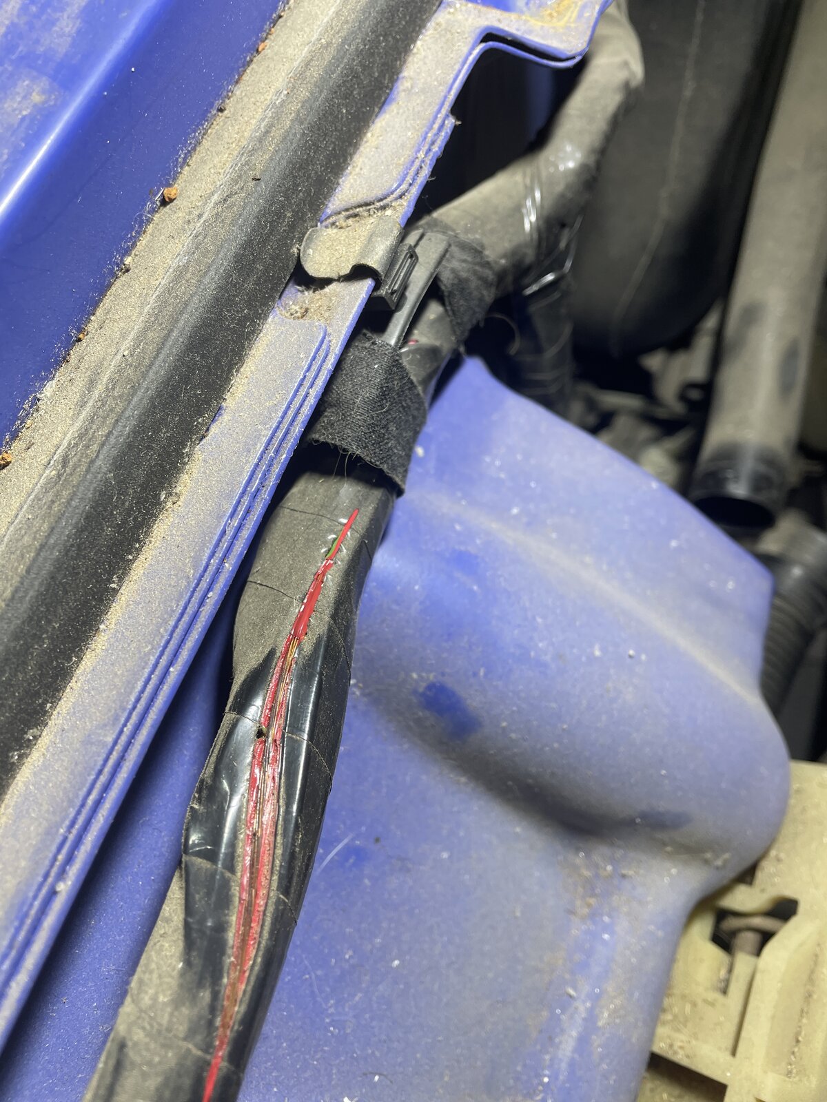

After fixing numerous bare wires in the "under body harness" I finally set out to actually start the Jeep last night. It cranked & cranked & cranked but never would even attempt to catch. Have never had this problem before. Left the key ON to see if I had any new codes while I was contemplating, and was surprised to find smoke coming from the back of the dash, roughly around the area left of the gauge cluster. Upon further inspection I see the pink/green wire (at least I think that's what color it is) shows signs of melting. I'm guessing that's the source. I plan to open up the engine bay section of the harness next to inspect the rest of those wires, but I'm wondering if any other symptoms might point to a specific cause or troubleshooting steps. I should add that while I significantly infiltrated the wiring over the last few days, I never had more than one wire detached at a time so I know I didn't criss-cross anything. I also didn't dig into anything other than what goes to the transmission plugs and the run to the drivers side tail light plug.

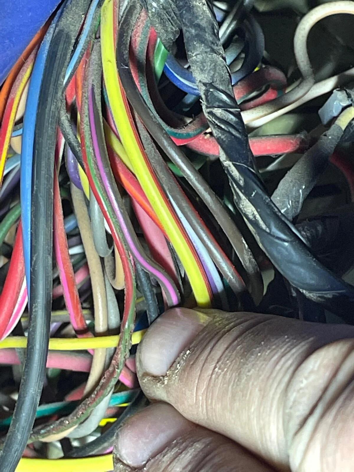

No success yet...but I think it is actually a green/red wire, or possibly dark green/dark red. These things are subjective. The melted section isn't on the portion that comes through the firewall, it's on the back side of that whole massive connector assembly which is behind the driver's side speaker area.
CALL FOR HELP: if anyone can identify that wire & what circuit it's part of, I would greatly appreciate it. The way the FSM wiring diagrams are structured, it's just about impossible to find any wire if you don't already know its purpose. It's now stuck to the pink/brown wire if that helps.
I spent way more time than I should have looking unsuccessfully through all the circuits for a green wire with a red tracer. It's there somewhere but looking blindly it not my cup of tea. Please try to trace that wire one way or the other and figure out where it starts or ends.

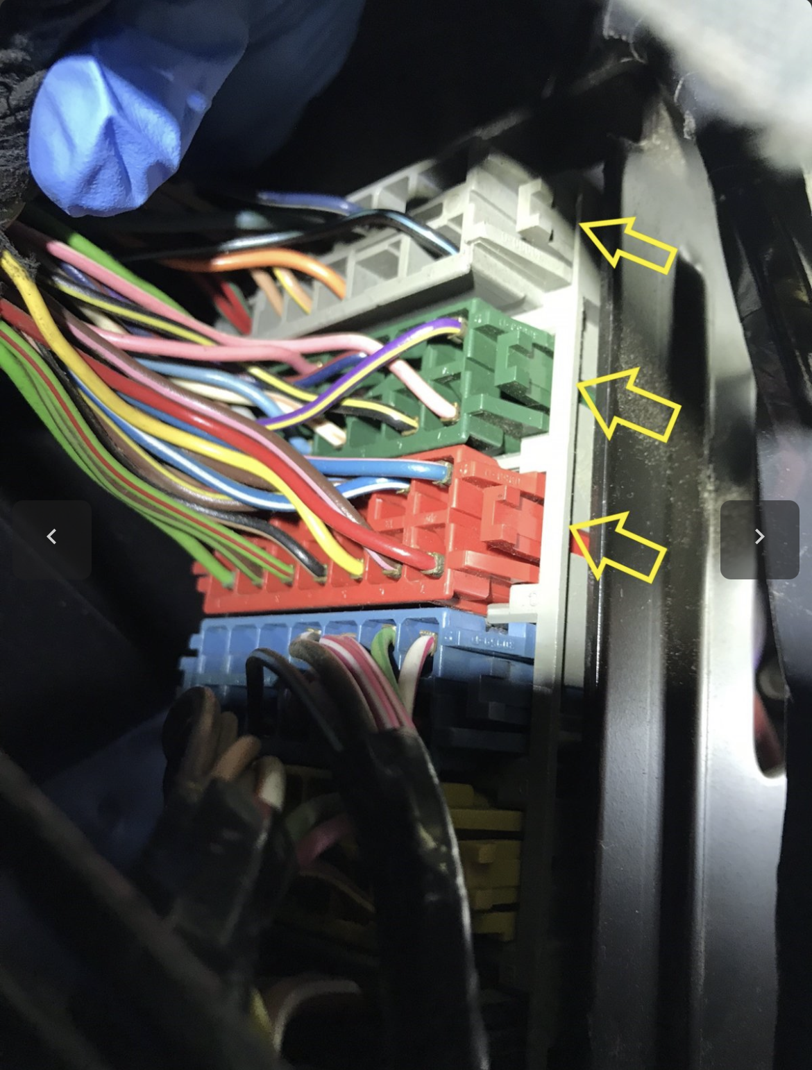

The other end goes into the back side of a massive connector array that holds like 6 wide rectangular plugs. That “connector array” appears to be mounted to a metal bracket that is bolted to the side of the tub with three 8mm bolts.
I found this pic on another thread here. The wire in question can be seen in the upper left.
Does this whole thing have a name?
Ok, it’s the heater circuit, F24. The connector is C202.

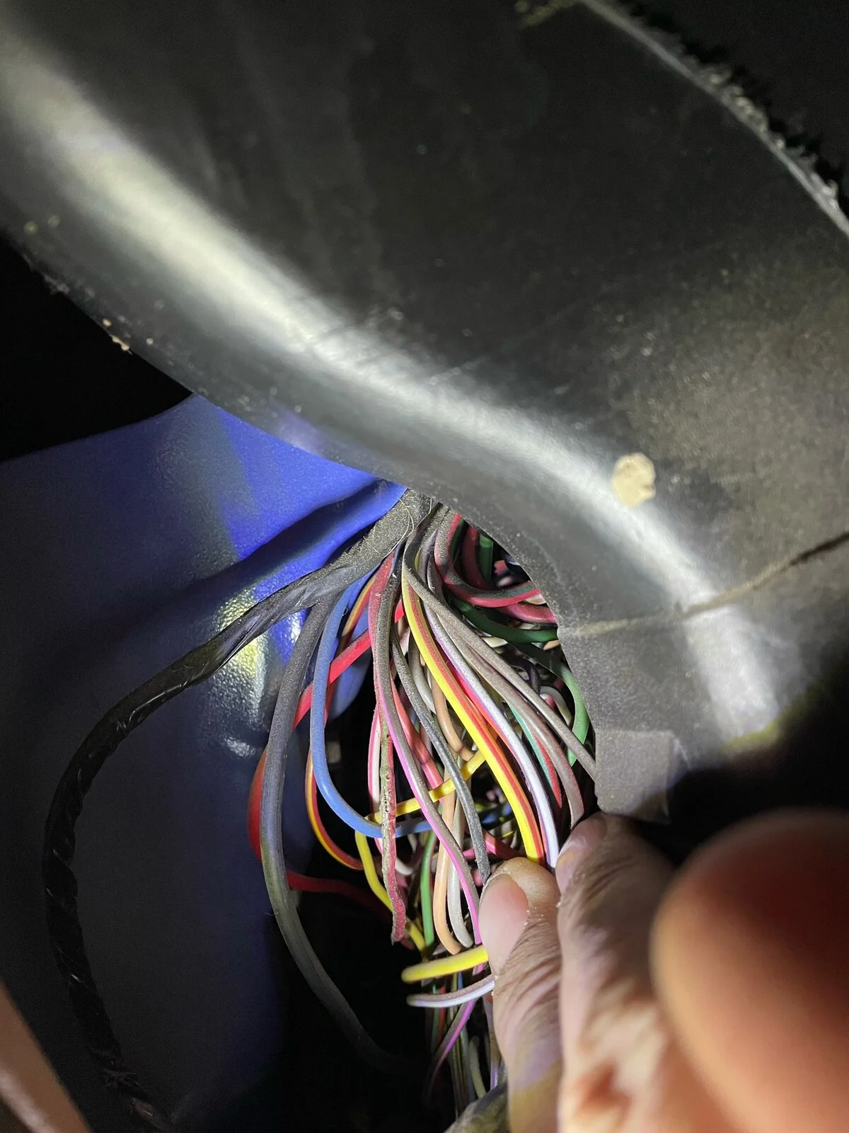

Also look to have some burning across the section that runs across bottom edge of the windshield behind the dash. Completely baffled how this got introduced based on the stuff I touched, but here we are.
I guess I get to finish removing the steering wheel and dash and start digging into the harness. No amount of troubleshooting will matter if I have known melted wires.
