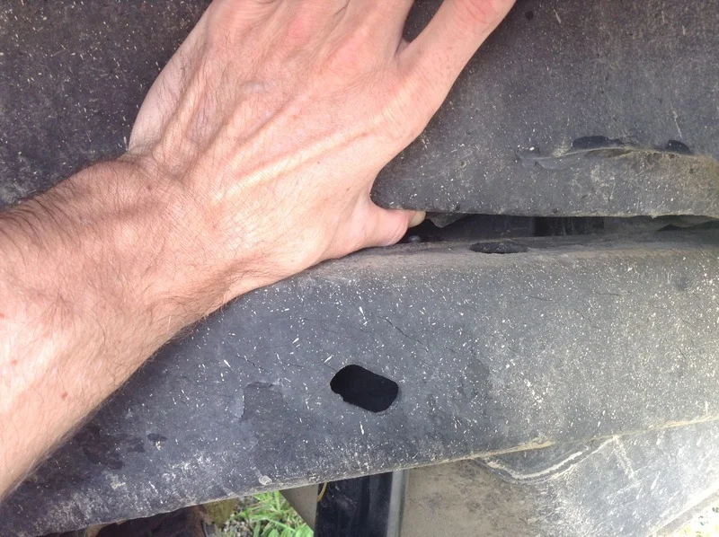

Alrighty then. New shocks and springs are going in the SE momentarily, so the ritual of spraying the mounting fasteners with a good penatrant was going to start. How in the world do you get to the upper rear shock nuts to spray them down? Can't even get my hand in there to feel them, let alone see them.
Sit in front of the tire and follow the shock up to where it mounts (visualize it since the frame is in the way). Lift the plastic fender right above the frame and peekaboo, nuts.

Actually you can, Jerry. Just pry up the plastic above the frame and spray away. You need the long tube on the nozzel to reach the other nut.
My picture sucked cuz I couldn't get the big ipad in close enough. I need more lift. LOL

Thanks Jerry. I went out and poked at it some more, and it appears that if the plastic fender wells are removed, there may be a bit better "view" into that area as well. This TJ is bone stock and unmolested, so I get to deal with 17 years of accumulated corrosion, crap and rust. It looks like new jounce bumper cups are in order for the rear as well. $41 a pop unless the local u-pull-it has a wrecked TJ or ZJ.
Nice! Thanks a bunch Ahoragi. The picture always helps, me anyway.

Edited to add: So, I went out and poked at it some more, and Ahoragi's advice is right on. A little pushing and prodding and hey bingo! Nuts! They don't even look that ugly from the top side. Just normal Jeep corrosion.
