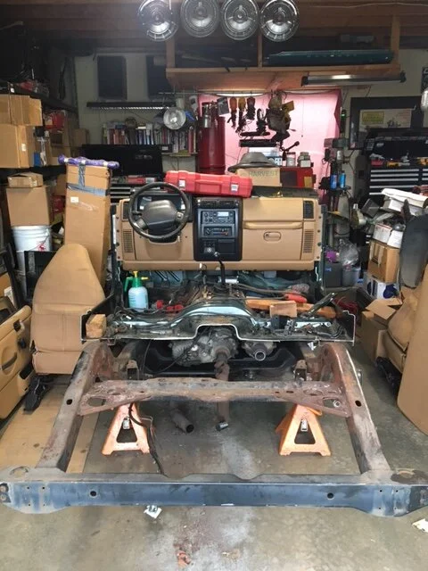

Stupid broken bolts. I may have gotten a little carried away with the Dremel...;)
