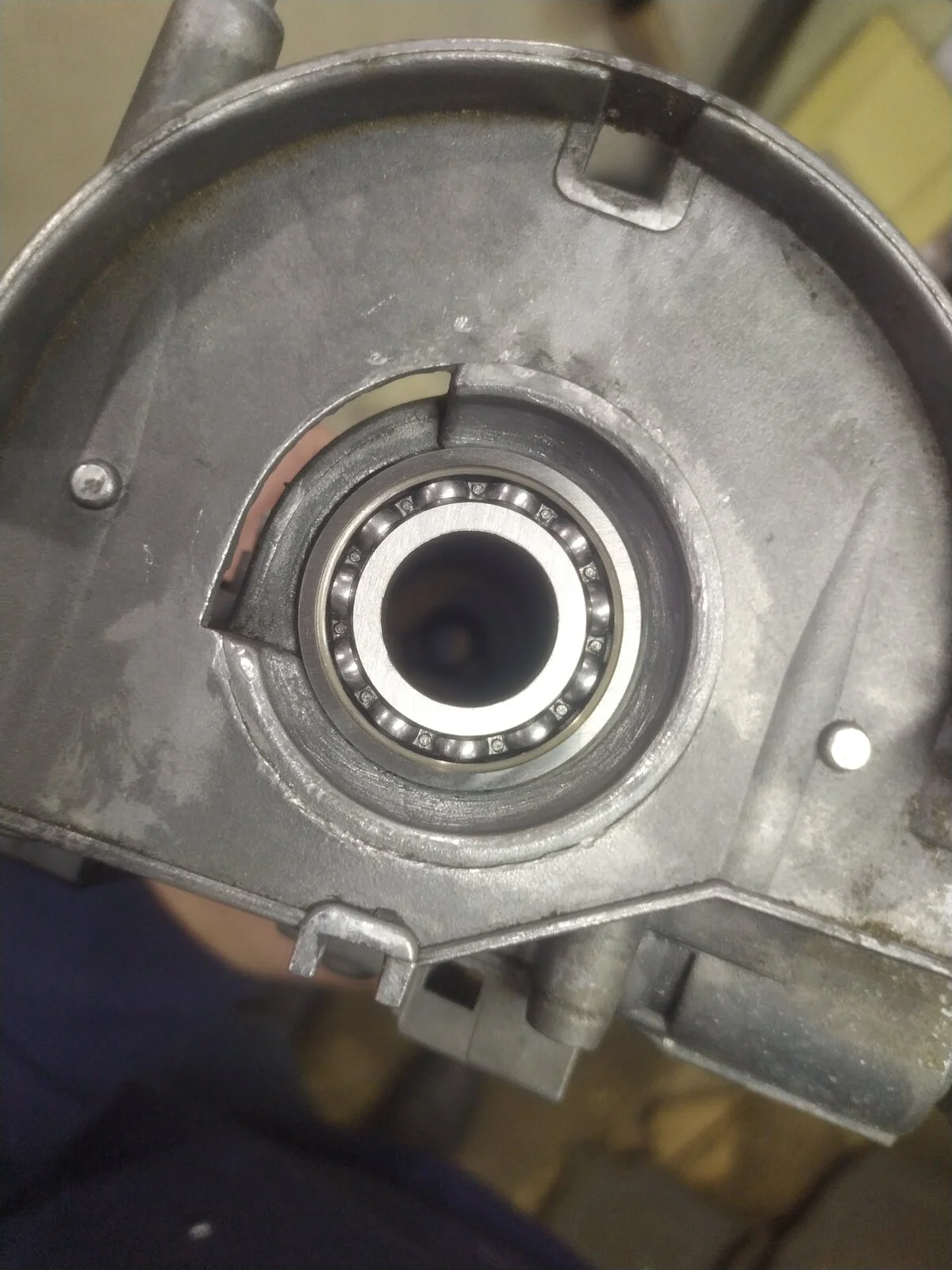

Hi. I also lost this bearing.
I used a 19.05*37*9 mm bearing.
he just didn't turn out like that. I gave it to polishing. and reduced its height to 7mm.
also because the steering shaft has a diameter of 19mm. I applied copper to the steering shaft to seal the fit. but this was not enough and I put the retaining ring. I will take a picture one of these days as it is installed. I also slightly increased the outer diameter of the fit. by hand with sandpaper.
Part number bearing.
MR1905372RS
