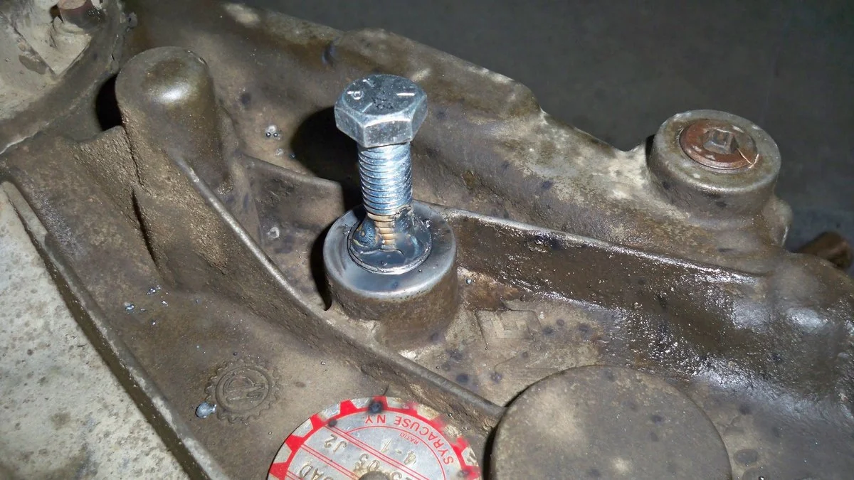

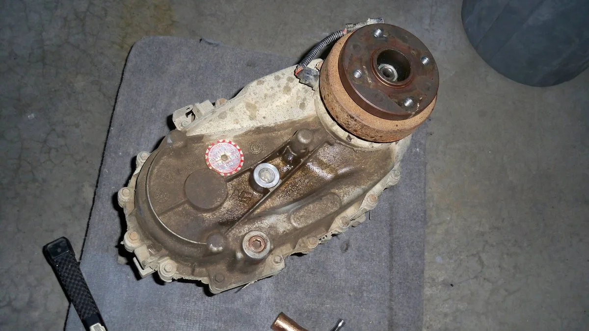

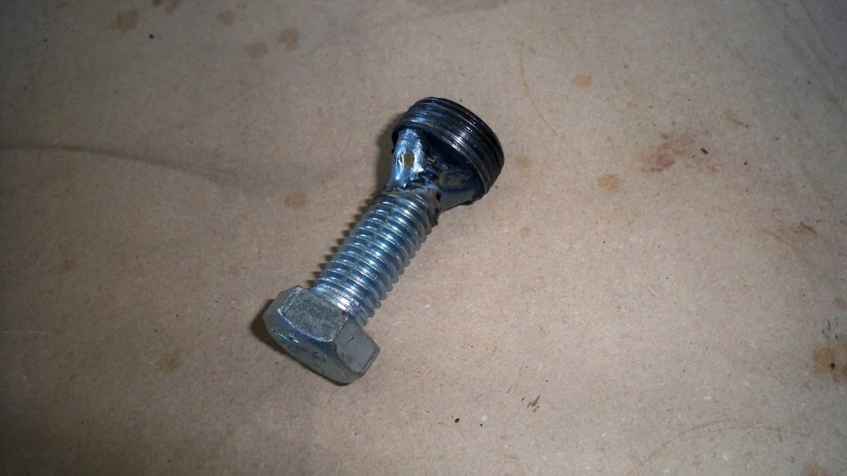

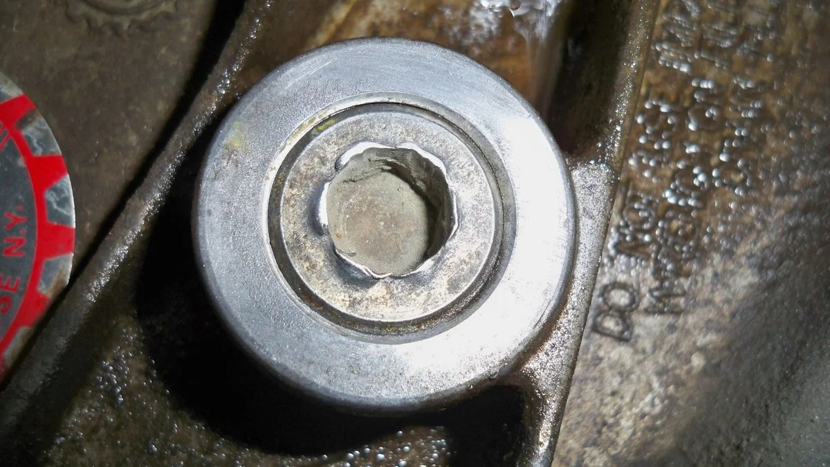

I dealt with both drain and fill plugs stripped and seized on my Rubicon when I bought it. I welded 1/2” bolts to the plugs and they both came out ridiculously easy, I suspect a big part of that was the heat from welding the bolts. I pulled the case to change the clutch but I don’t see why it couldn’t be done with the case still installed.
