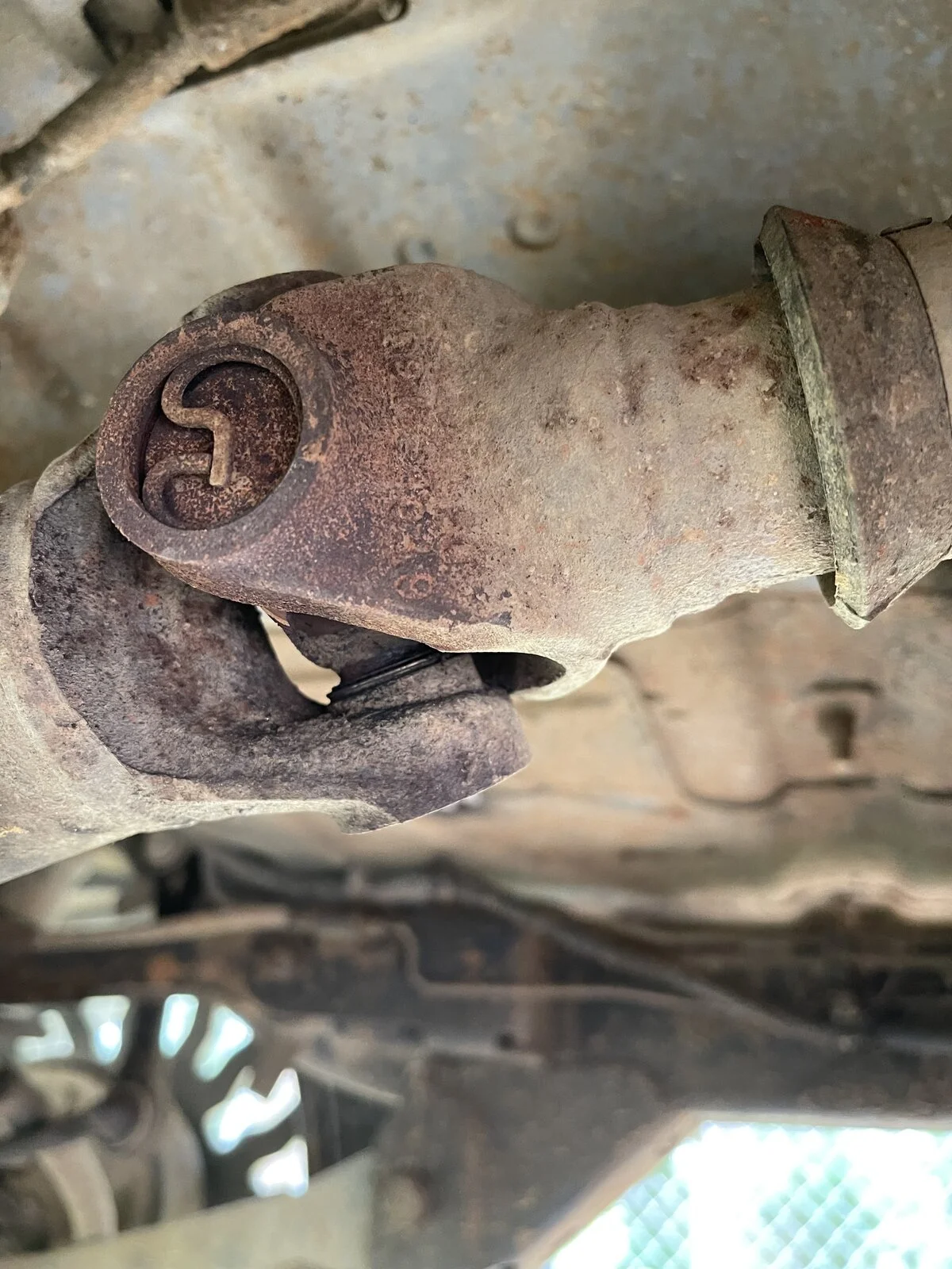

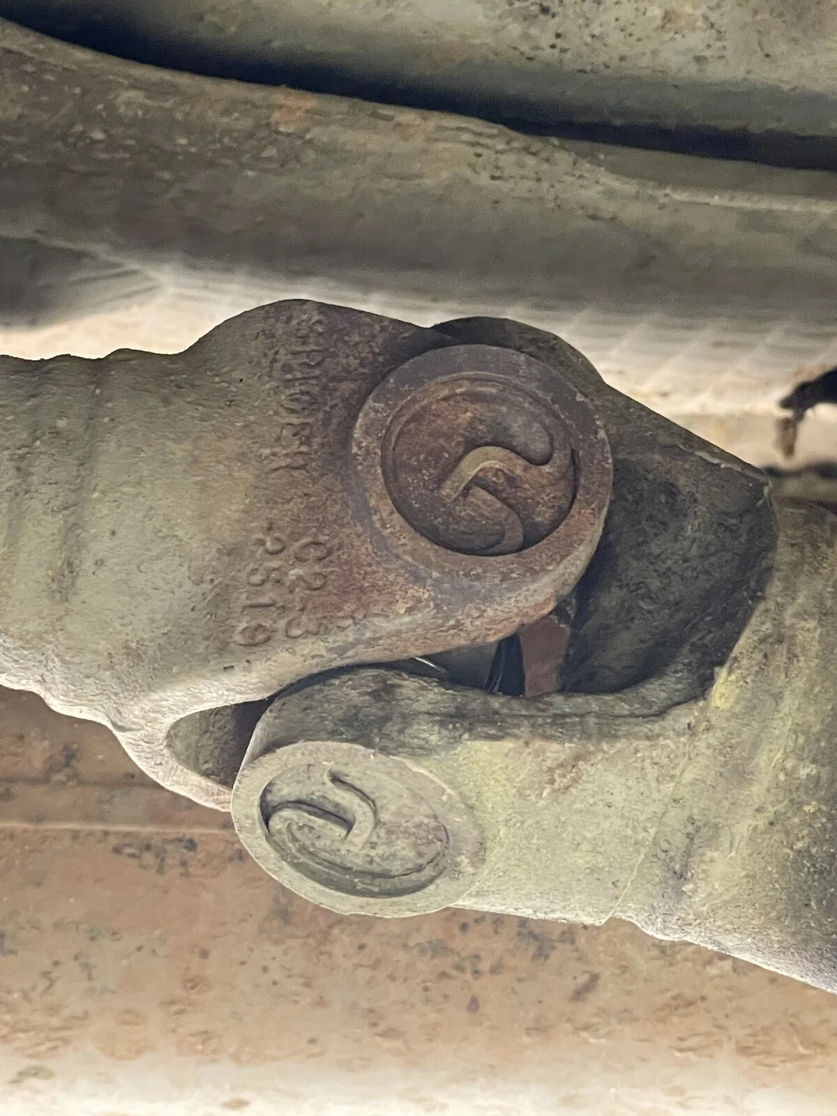

Out of nowhere my 2001 Wrangler has started vibrating as soon as I push on the gas. I got under it and the rear where the slip yoke is at the transfer case the u-joints are touching. All of the other ones seem to be fine.
Here are pics I took
I’m no expert, but it looks to me like you need a new set of u joints.
I prefer spicer u joints, but I understand NEAPCO u joints are good too.
