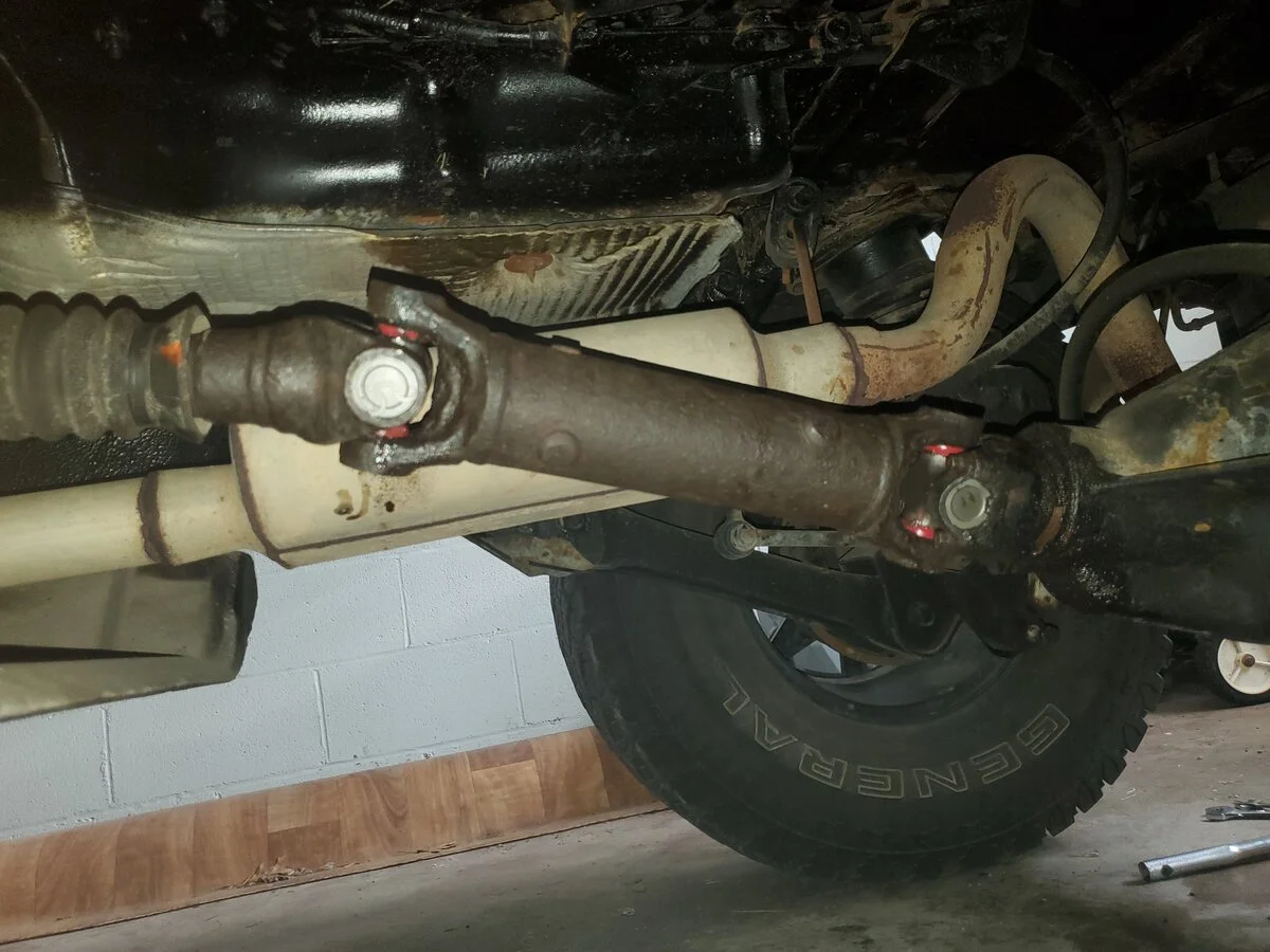

Are you able to post a picture taken from the side that shows the entire driveshaft, and axle in one photo? So we can see the angle of the axle in relationship to the driveshaft.

Best image I could have the old lady take while I was gone from home. I know just by eye balling the angles are less than ideal, but I've had no problems like this until now and nothing has changed except now I get the aforementioned vibration. I should add it does have a t-case drop kit already.
Do you have the full weight of the Jeep on the suspension in that pic? If so it looks like your pinion angel is off but I forget how much angle the stock drive shaft can take.
Yes full weight of jeep is on the suspension. I know the angle isn't perfect, but the burning question is why would this problem not have arisen before? I would think the vibrations would have been present all along if pinion angle was the problem
