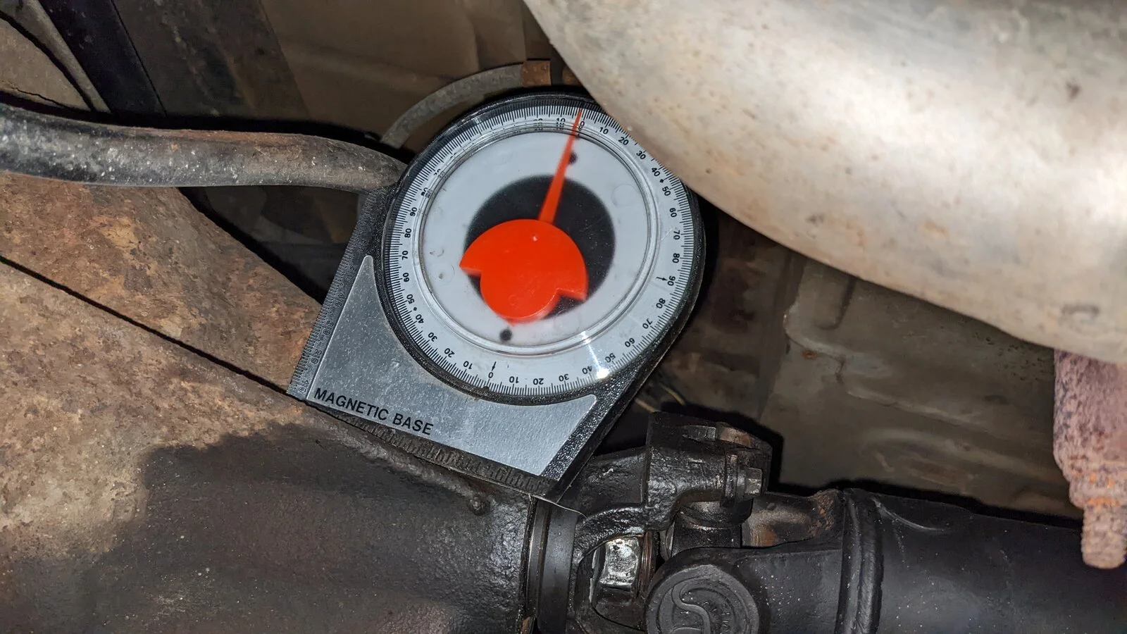

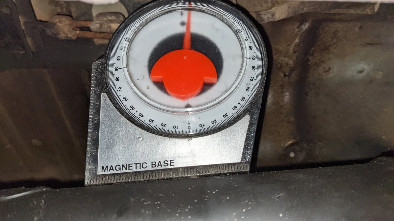

Can you post a pic of your rear drive shaft angle- if they did new control arms it is possible the rear pinion needs adjusted- it’s a Jeep is no excuse - a TJ is as mechanically sophisticated as a new Ford F350 as far as the driveline, steering and related parts -they are designed to drive fantastic, smooth and quiet.

The first one is the on the rear end. The second is on the drive shaft. I will have to put it on the lift to get the angle of the transfer case.
Your rear drivetrain angles are fine if you are still running the factory control arms and factory rear driveshaft.
I suspect a front end problem or an out of balance front tire.
OP note this post-stock arms set the angle pretty close
Also you can look and see if the shaft had ever been balanced and maybe appears to have lost a weight- also be sure the joint bolts are snug and seated properly-
