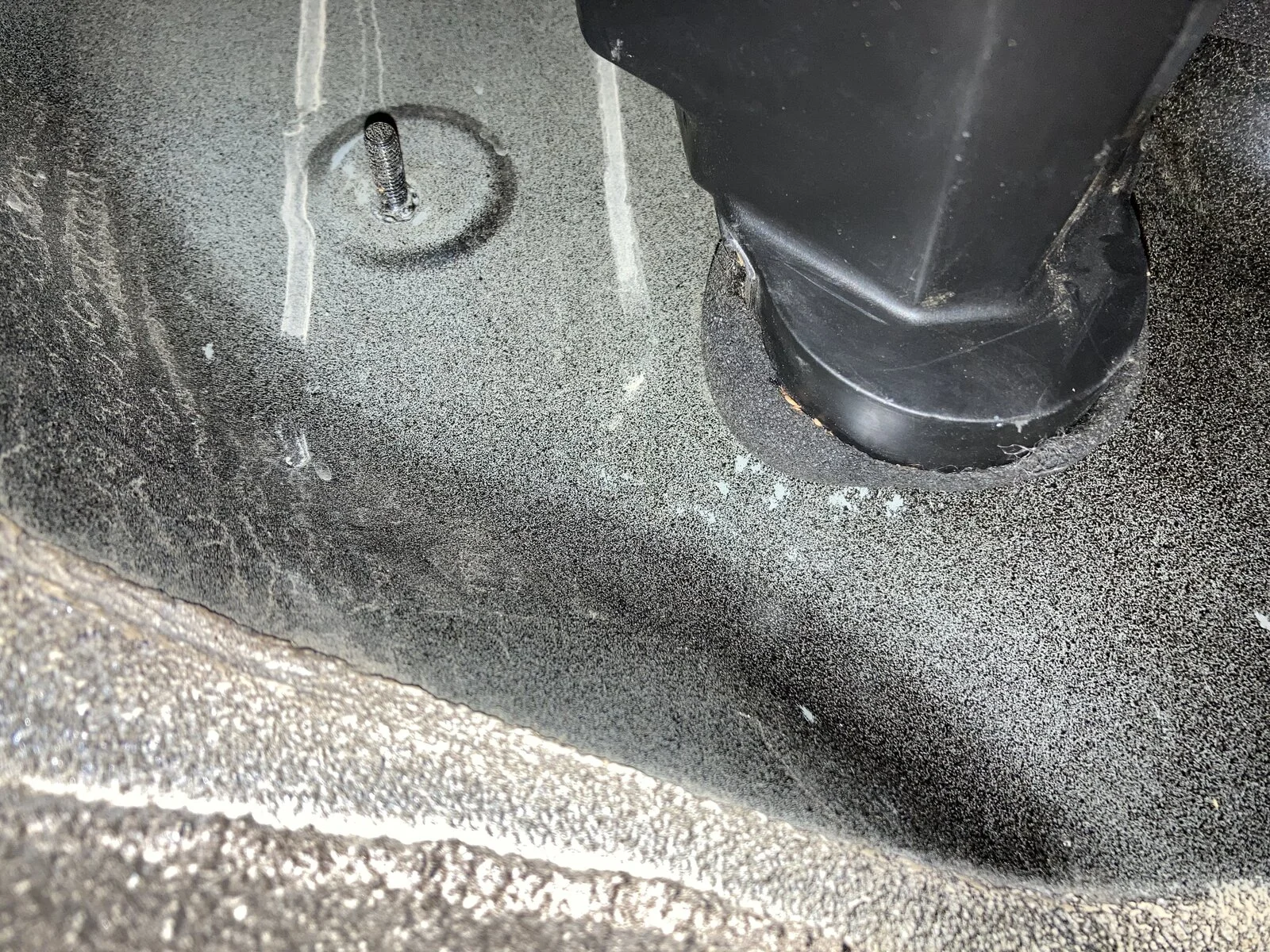

Here is a pic that shows my leak location from passenger side footwell.
Just realized that your post was from another member, I'll track that one down and reply there
