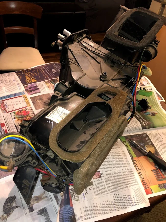

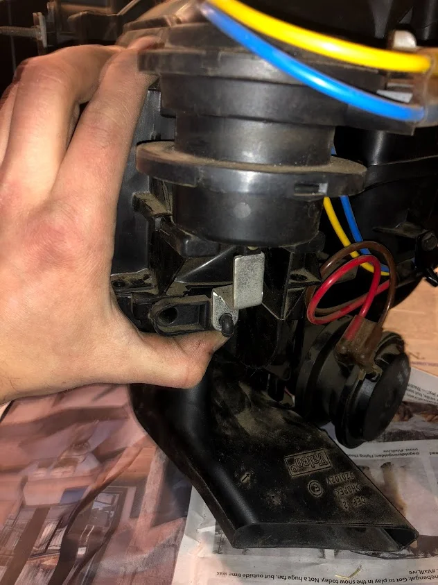

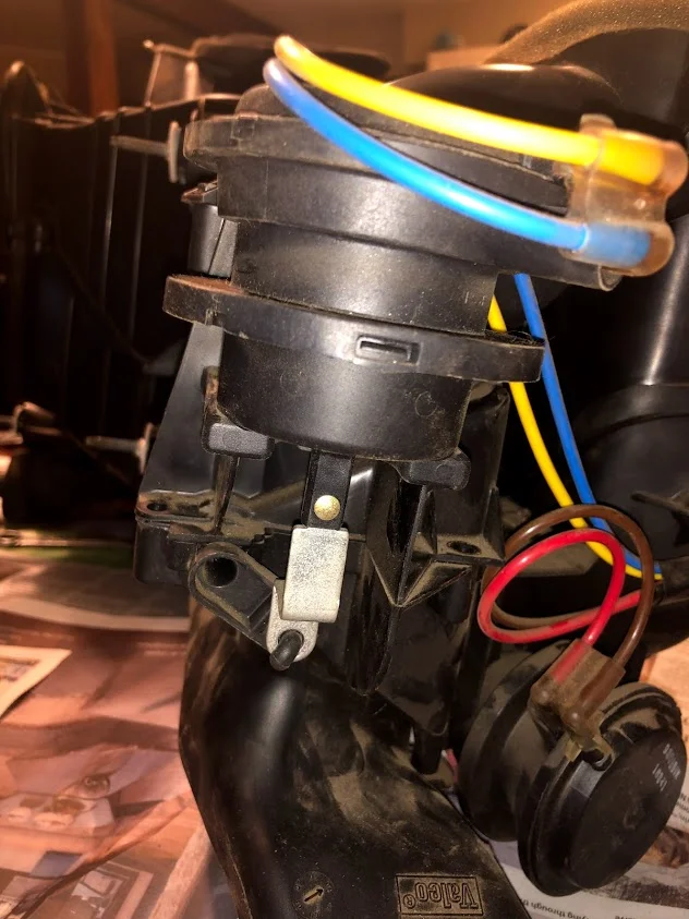

So I got the hvac unit out... but i ran into another problem. I am not sure what this mechanism is called. but looks like a plunger directing heating/cooling. its hooked to both sides of the housing. i cant unhook the lever from the metal arm.
any advice?
I didn't have to remove that when I took my case apart. I just unhooked each of those colored vacuum lines from one side. Just take a picture of it or make a drawing so you know how to hook them back up correctly.
