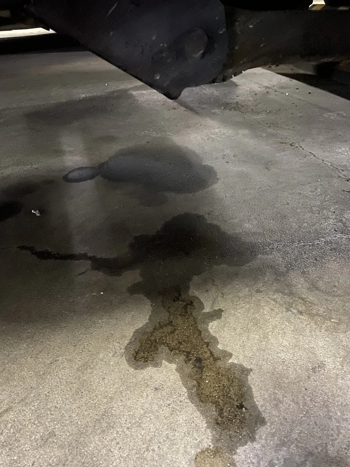

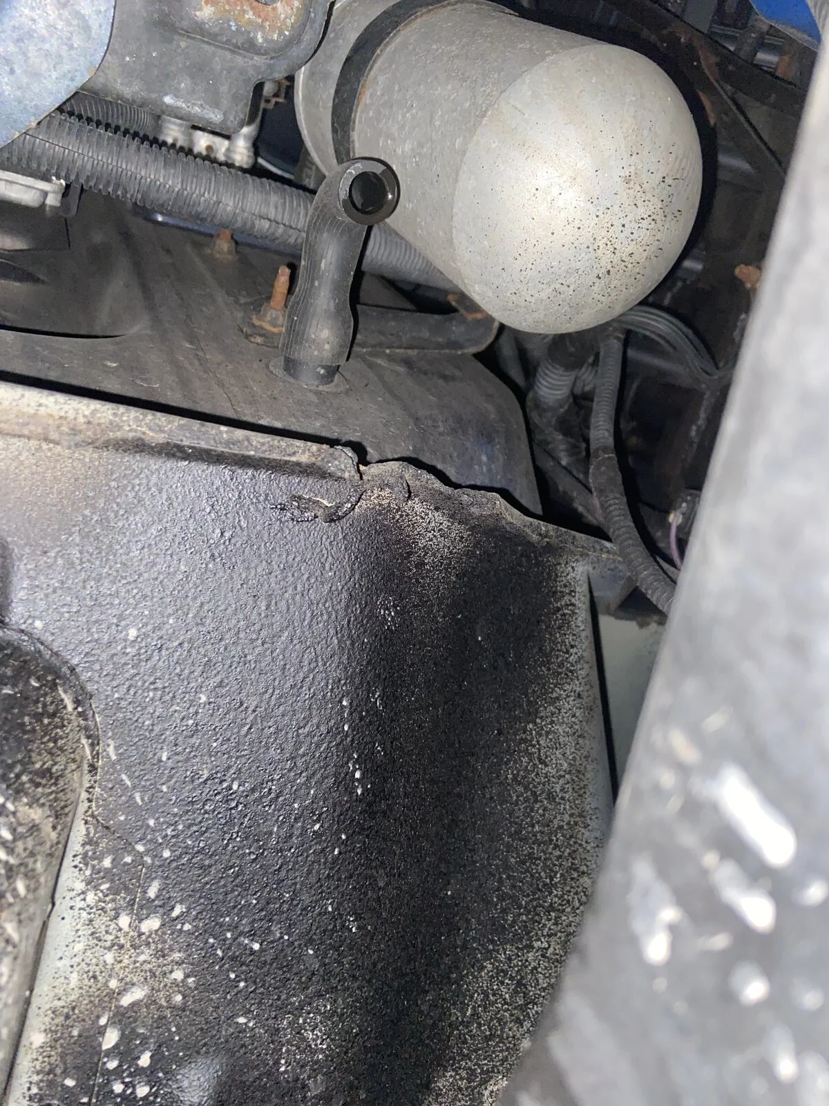

Does this look like a heater core leak to you guys? It’s orange (antifreeze). Was parked for 3 days (forgot to turn off the heat but don’t think that should cause it). Does Blue Devil sealant work? This is my first Jeep. Don’t make fun of me lol. Thanks!
If it is coolant you need to replace your heater core. Do not put any stop leak in your cooling system. It tends to plug up things that should not be plugged.
