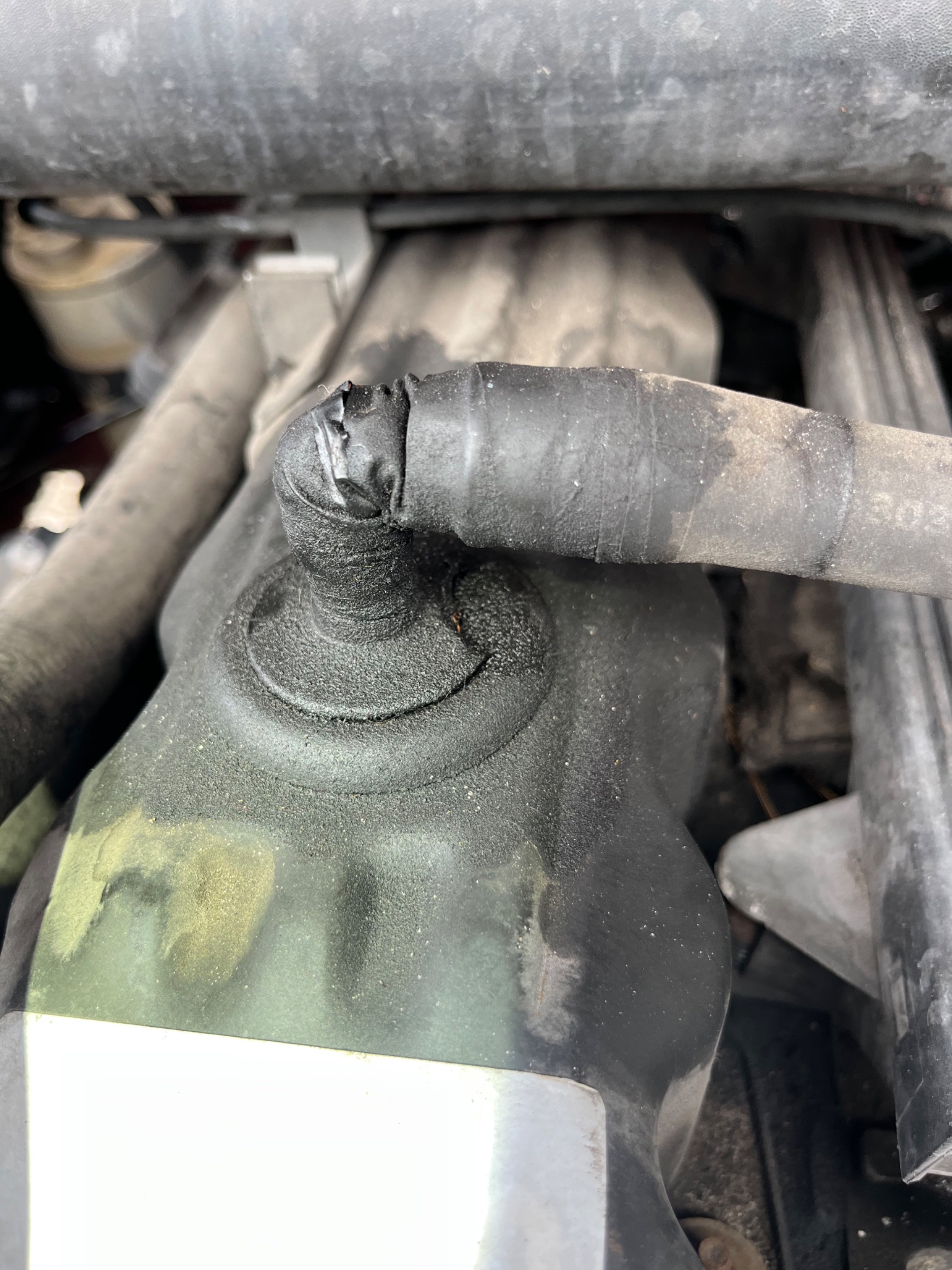

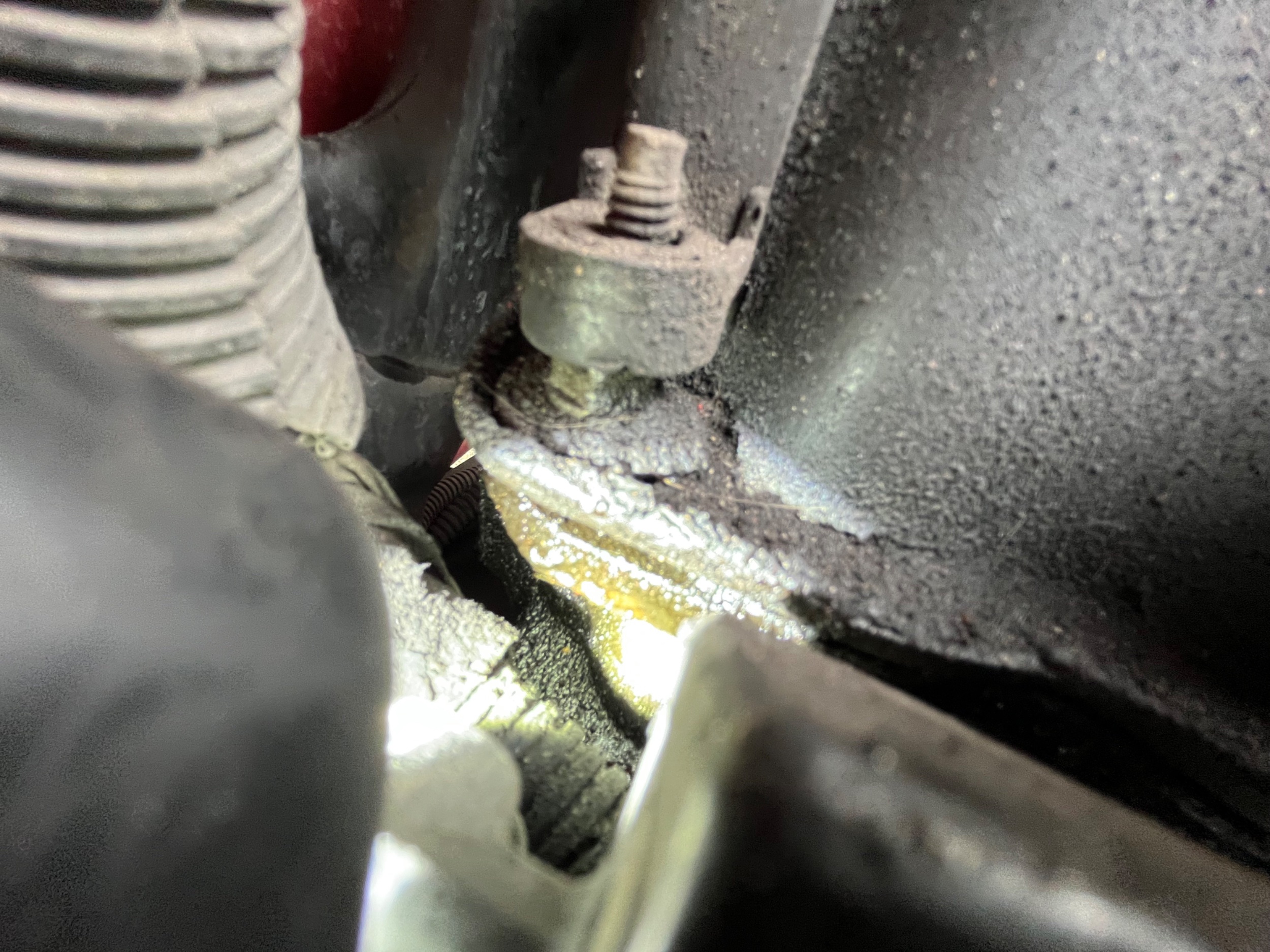

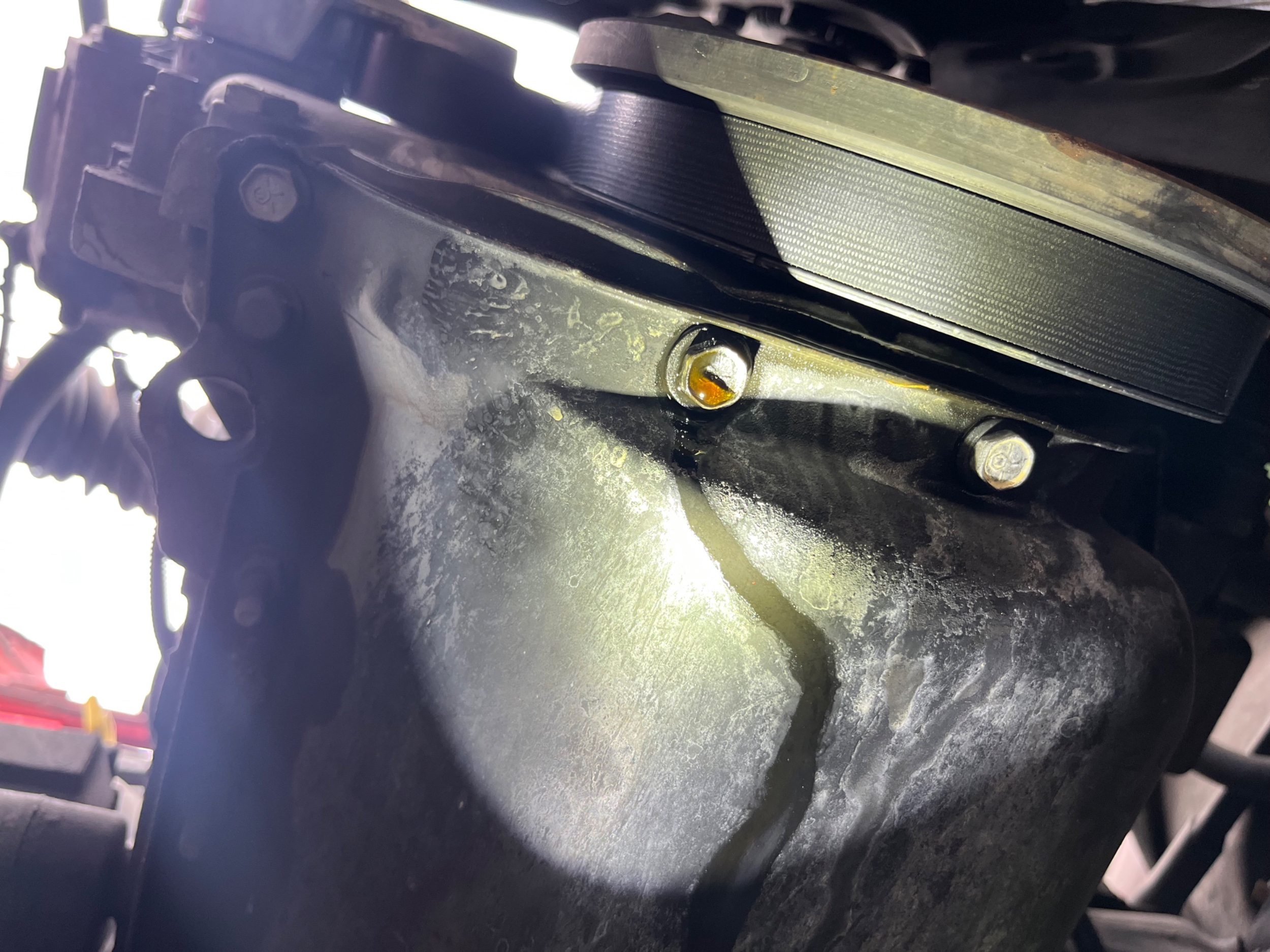

Besides the overheating problem, it runs fine and strong. Heres a few spots I've noticed fluid 1. The thermostat area 2. back right & left of engine 3. theres also oil on the front of the oil pan, not sure where it started from though.

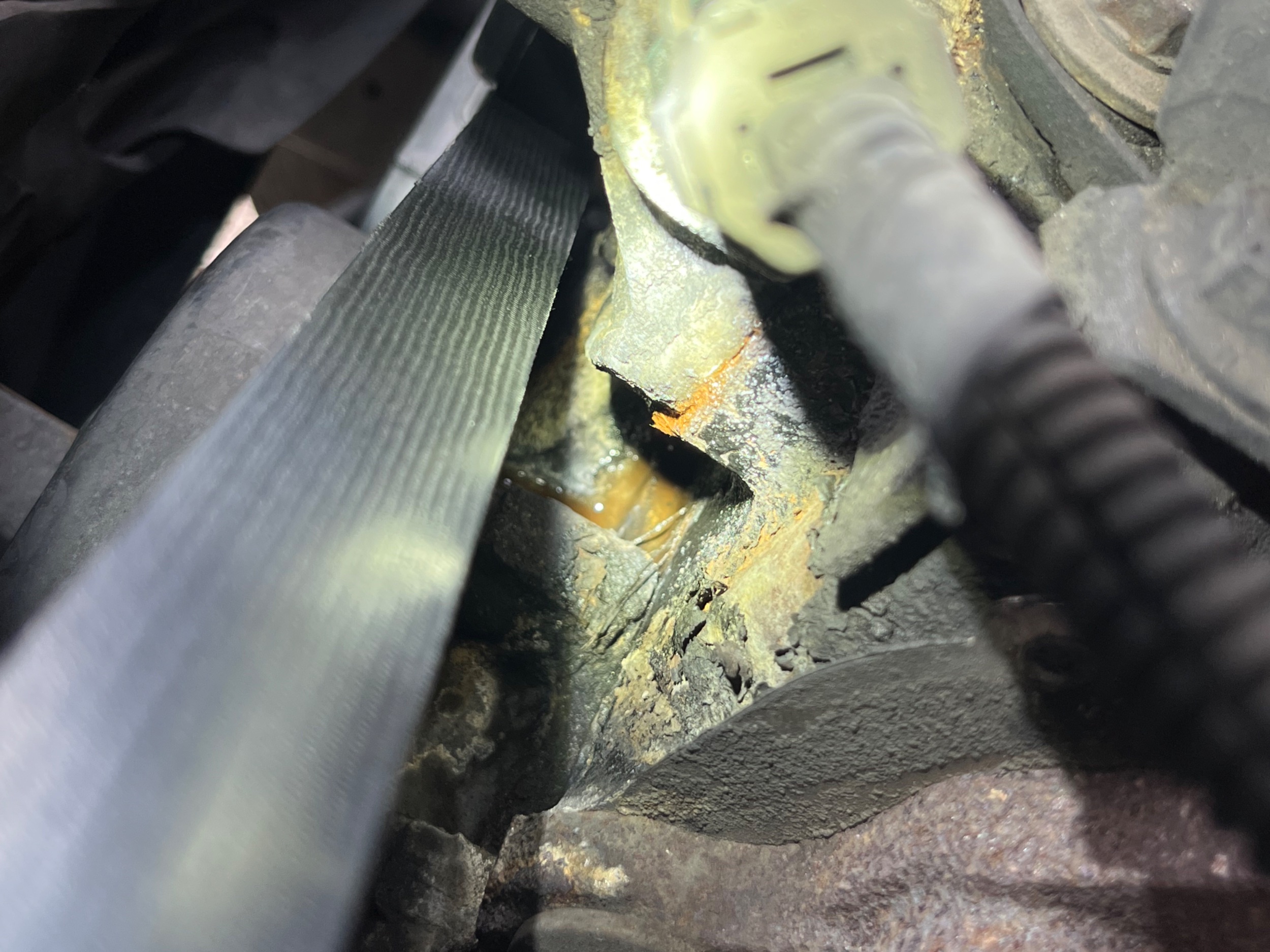

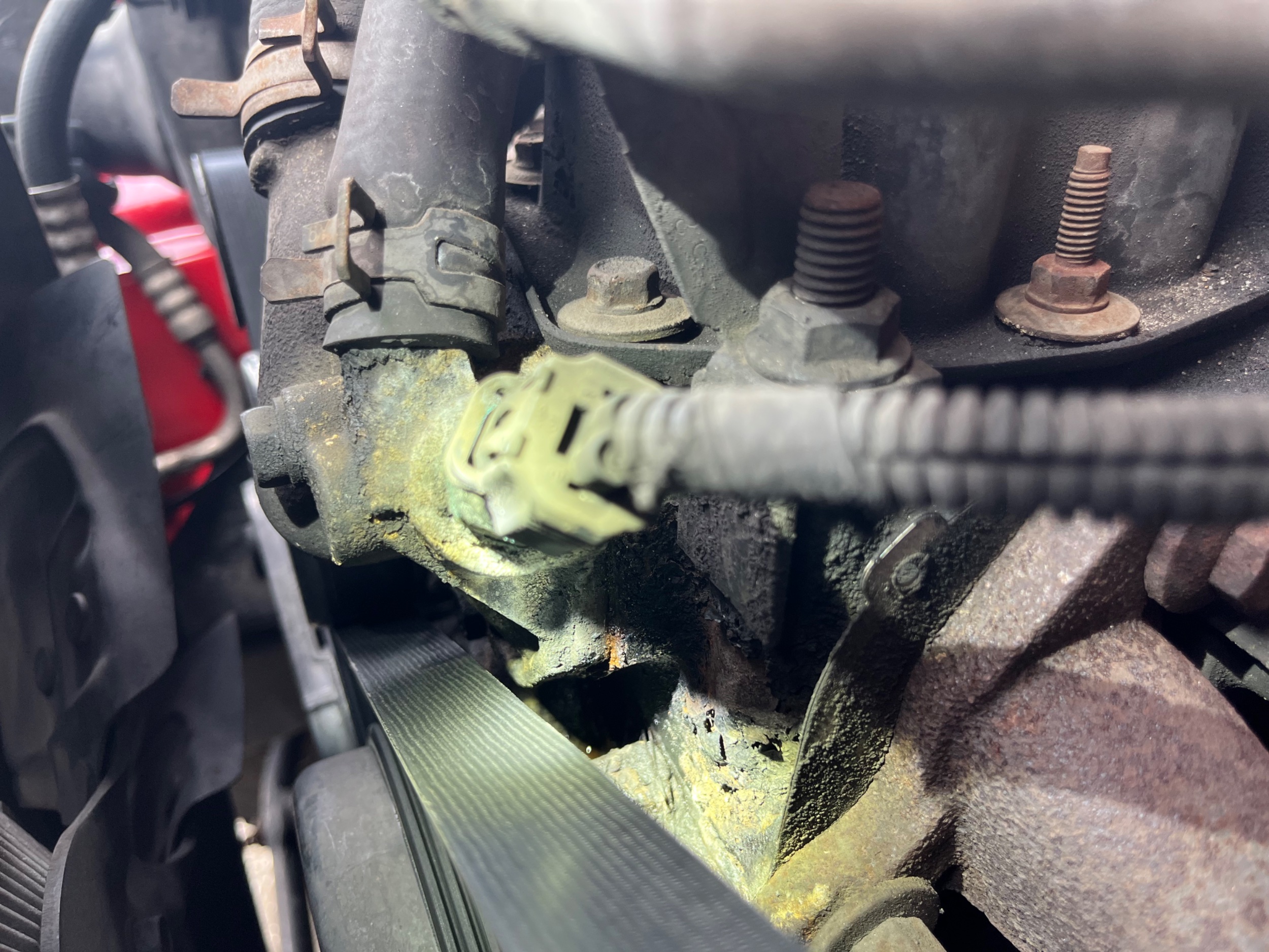

Kinda looks like water pump leaking out of weep hole

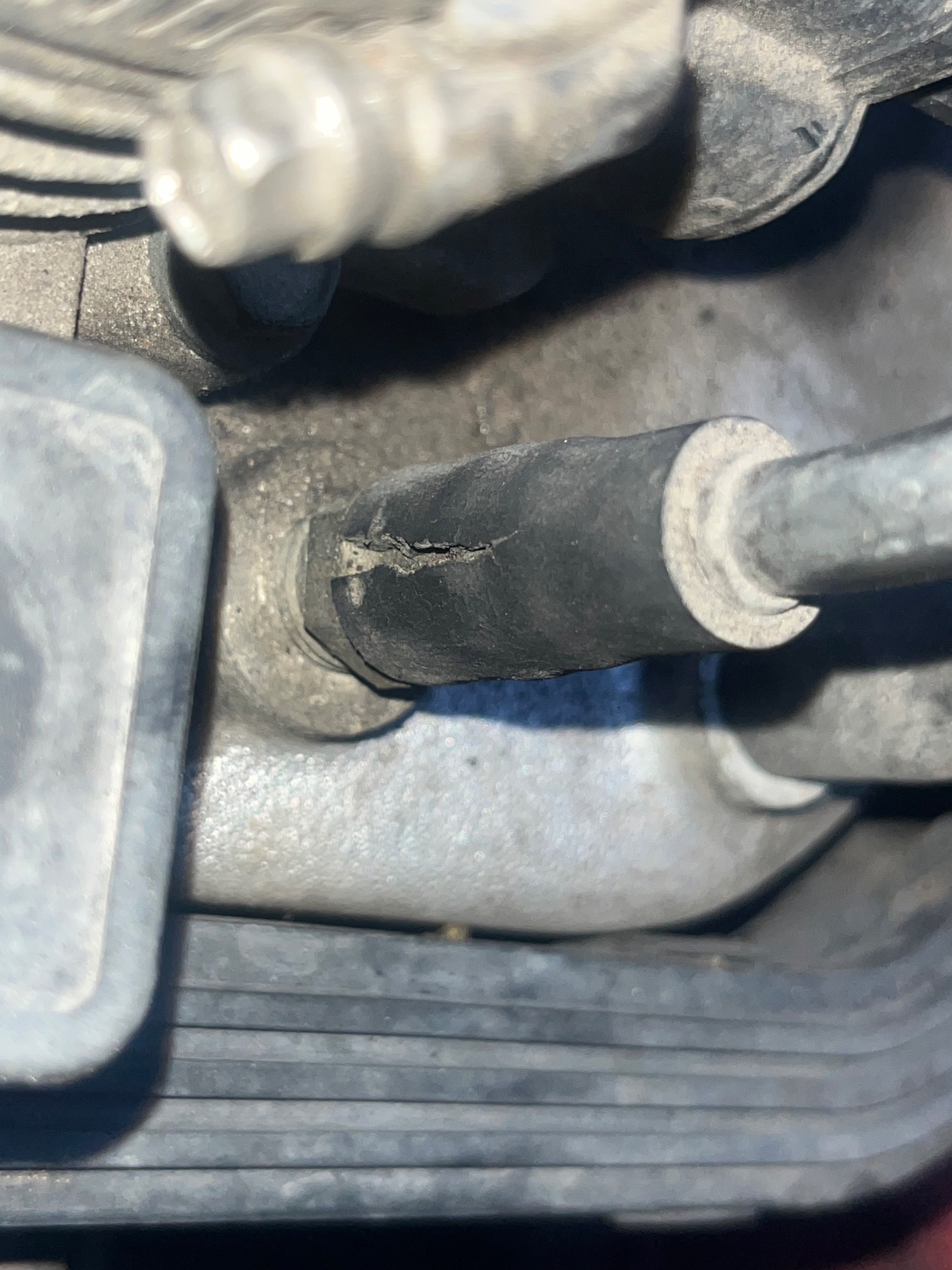

The thing on your valve cover is your PCV. It vents excess crankcase vapors, and if it gets stuck closed, it can blow seals out. If it gets stuck open, you'll burn oil. I'd replace it at that mileage.

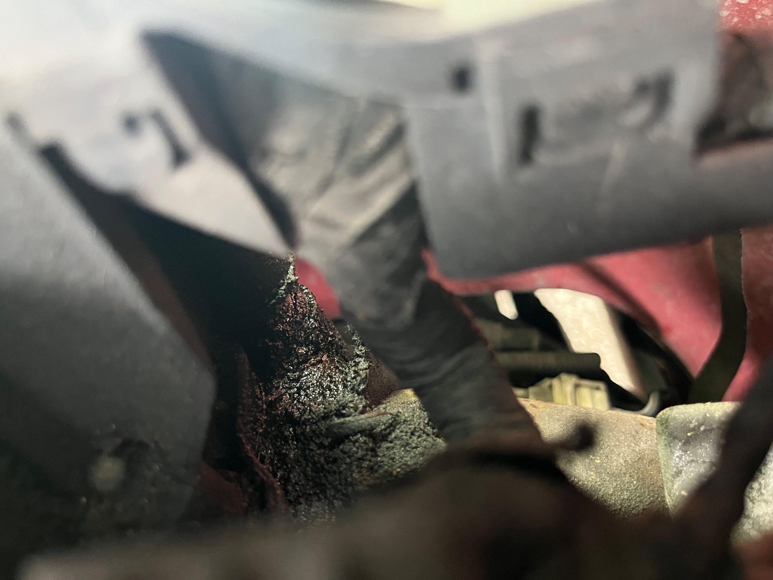

For the oil pan, a leak at the front is probably the oil pan gasket itself. Make sure the bolts are tight. You can narrow it down with UV dye, in case its the timing/valve cover or front main seal.
As for your coolant, which isn't a great color to begin with, I suspect a water pump leak. Probably time for a thermostat, WP, and a good flush.

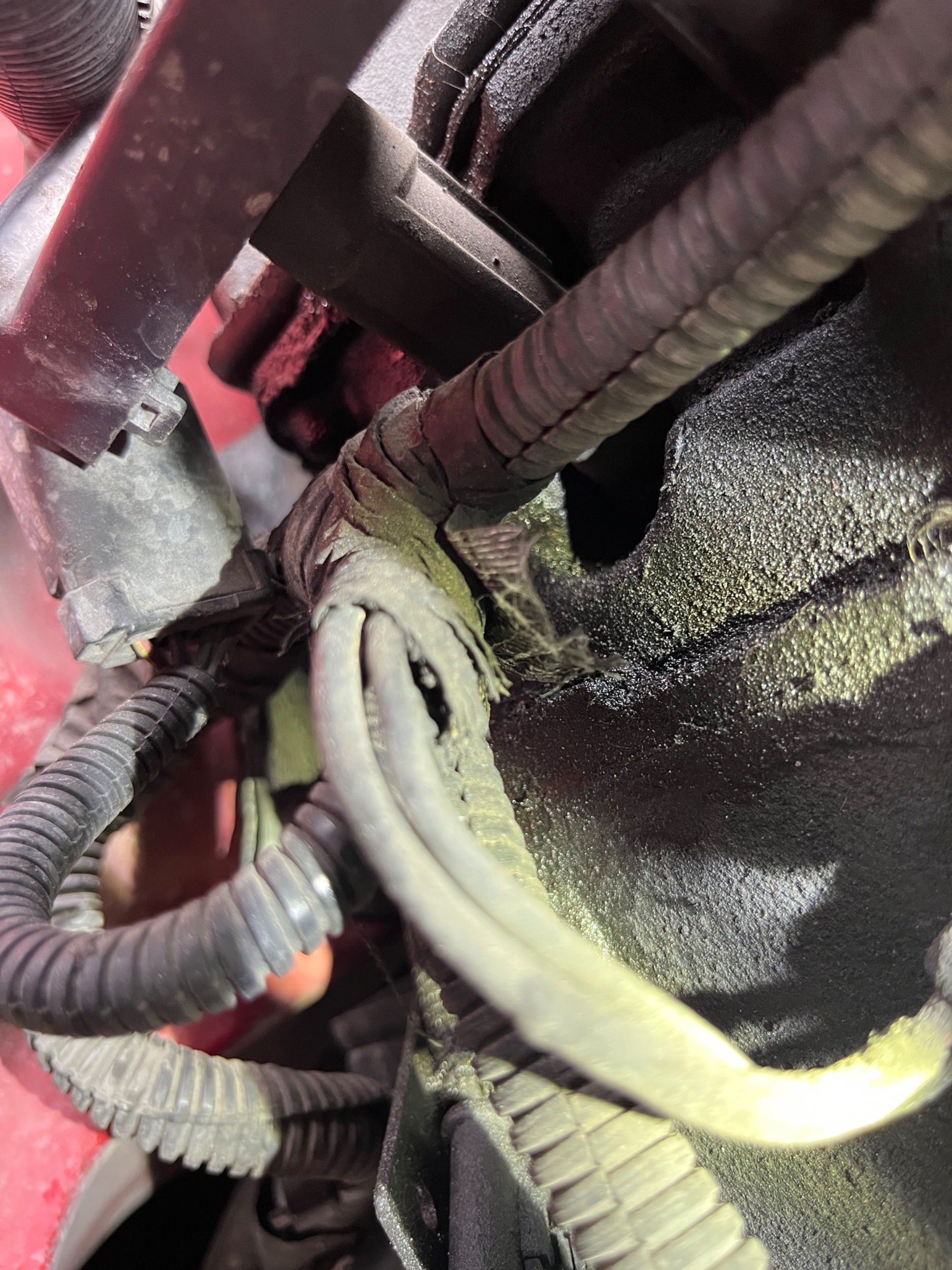

Well I guess it's either the water pump or the thermostat, do you think would cause the oily leak in the last photo? I guess my first step would be to get it cleaned up really well
Replace the water pump and thermostat and flush the cooling system.
Clean up the engine so you can see what's leaking.
The leak at the front is either the oil pan gasket or the crank seal in the timing cover.
The valve cover elbows and grommets need to be replaced. The one with the small hole goes in the back.

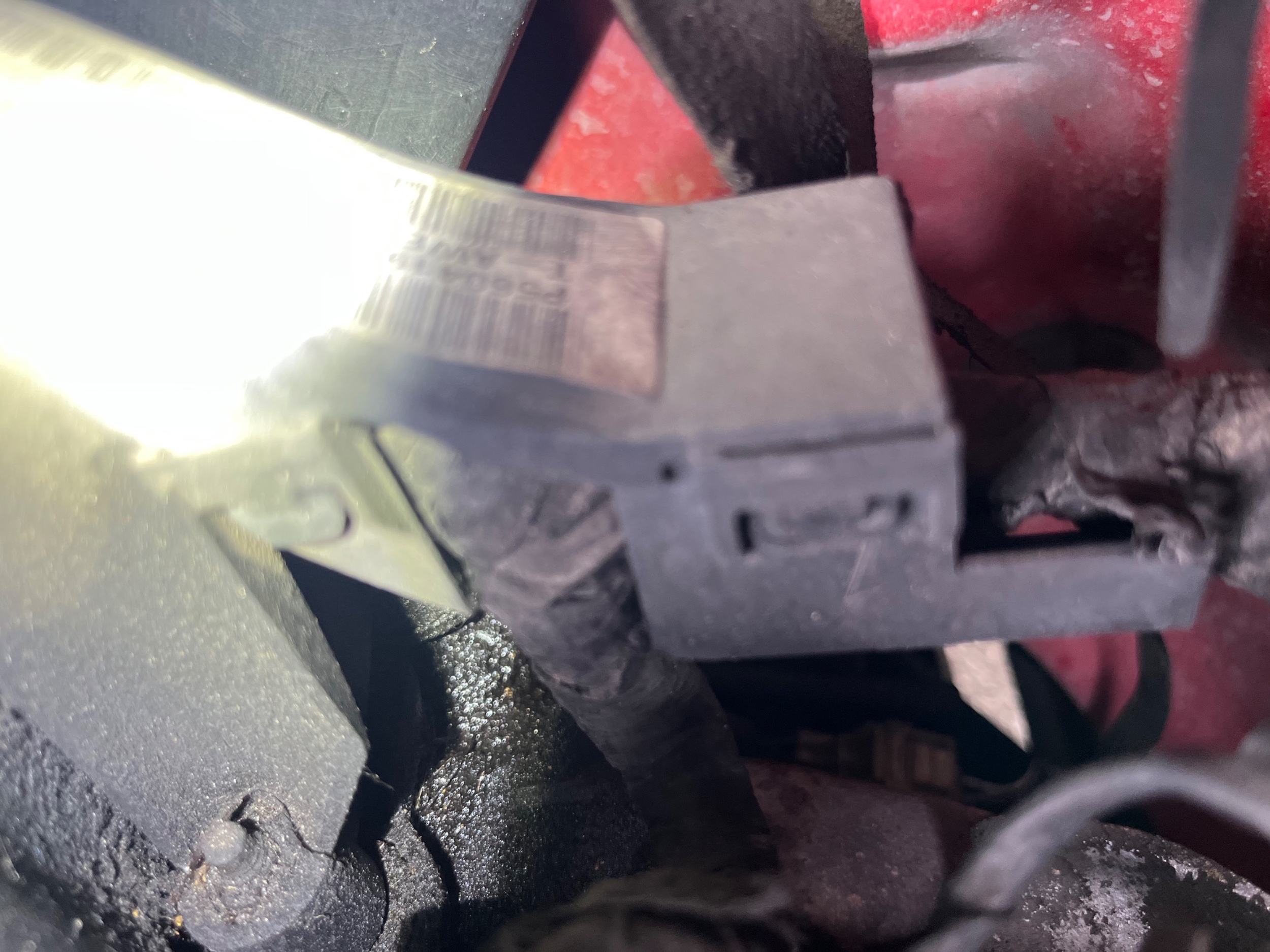

It probably is rusty coolant, It wasn't that thick. Did you see the other two pictures just posted?
I did.
I agree with the guy above that you should tackle the water pump first as that is critical.
Then clean the engine up so you can identify wher other leaks are coming from.
If you are taking to a shop, clean it sll up so they can identify the leaks and fix them all at the same time.
When there is one leak it slobbers all over disguising itself as multiple leaks. So much easier to identify and work on a clean engine.
The last pic i believe is a protective cover. I believe under the cracked piece is metal hardline.

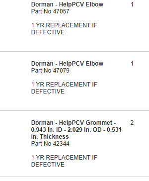

I have that piece on order from Rock Auto. along with the water pump/ thermostat & PCV elbows. I'm going to do that part myself. I found a good video off of YouTube! I'll be doing those repairs first.

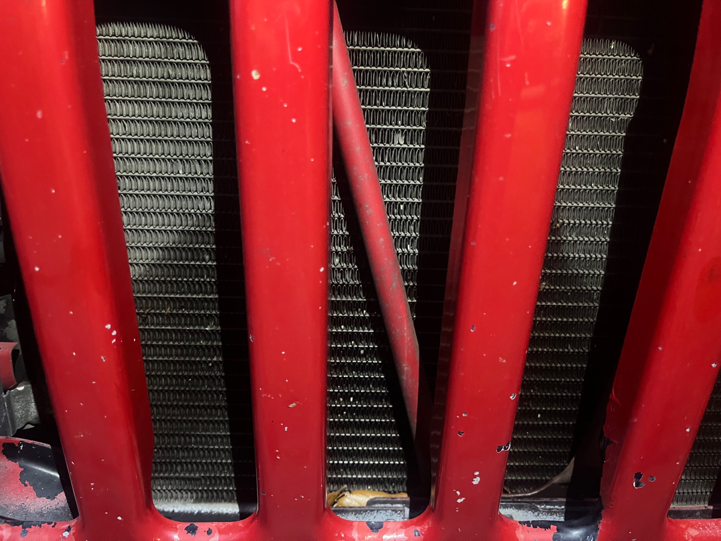

I was hoping to get my A/C done next though, I had a bad heater core. So I have a heater core and evaporator ready to go in, then I was going to have a shop find out why i'm not getting power to my A/C compressor. I at least need to get the heater working for winter.
If that is oil all over the AC condenser, you have a leak in it and your system is out of refrigerant. The AC system has a low pressure switch that prevents it from running if the refrigerant level is too low.
Go to the Resources section and download the FSM, it will come in handy.
The dampness in front of the condenser (behind the front grill) shows signs of oil seepage which can be an indication of a refrigerant leak.
The low refrigerant pressure stops the A/C compressor clutch from engaging (safety feature) by the LPCO not transferring power to the clutch mechanism.
You can jumper out the LPCO by removing the electrical connector on the accumulator/drier filter assembly near the firewall (right of battery tray) and place and wire or paperclip in and briefly test to see if the compressor will start. This confirms the LPCO is seeing low refrigerant pressure OR the LPCO is bad.
Either way the A/C system will require servicing; finding the leaks, purging system and adding refrigerant OR a full system service which involves O rings, filter drier replacement, expansion orifice replacement, purge and adding refrigerant.
