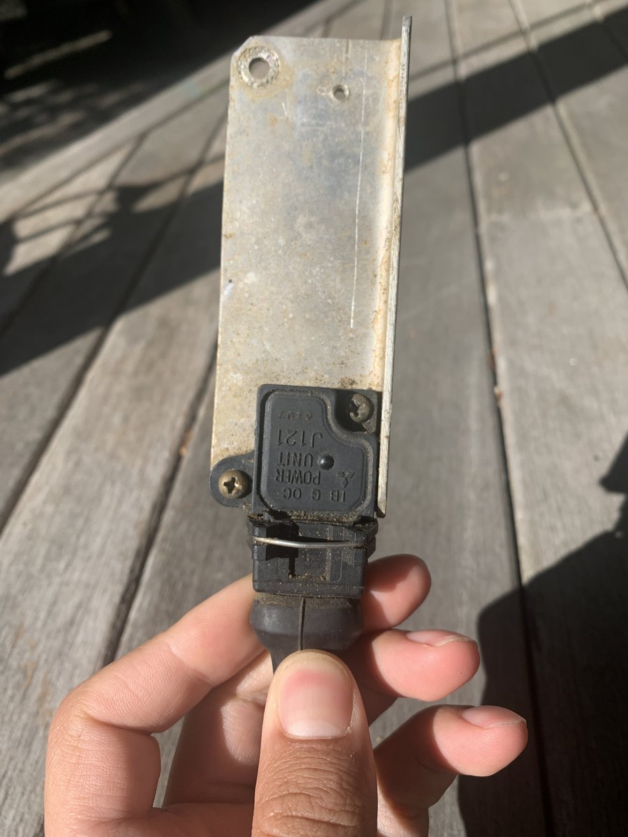

Working on a 2004 TJ rubicon manual transmission. I’m working through the wiring harness behind the dash and came across this wire connector. Can some wise TJ wrangler enlighten me?
Doesn't look familiar to me off hand. Try taking a look at your factory manual, it's available for free in the TJ Resources sub forum. Page 8-W80-1 has a representation of every connector, you can scroll through there and see if you find it.
Edit: if you scroll further you'll find diagrams off all the harness locations & their termination points, might help you narrow it down further based upon its location.
I have an 04 Rubicon with a manual as well. I've looked at qslims suggestion. Not one harness listed matches. Where did you find it? I see the airbag module in the background. Was it right there? I can look to see if it's in mine too.

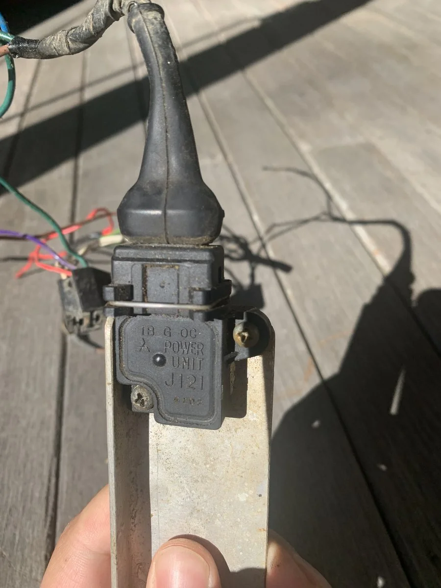

Does it look factory? Or like someone has installed it after the fact (albeit, well)
I ask as I just pulled a Mitsubishi Igniter out of mine, which uses the same plug, but was definitely a home job.
I'm now wondering if this was some sort of "performance" upgrade, or maybe it is factory in later model TJs, so someone retrofitted into my 97
Either that or we are dealing with completely different things!

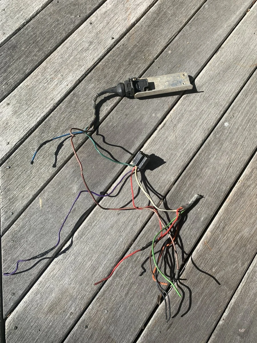

This was definitely a hack job, spliced into the ECM plug.
I didn't have the time or energy to figure out exactly what wires, but the Jeep still runs fine without!

It looks like it is factory installed. It is in the same branch of the wire harness as the Airbag control Module, PRNDL Lamp, a ground, & Parking Brake Sensor. The cable is about 7 inches so I'm thinking its an unused attachment or something else. It was just a weird looking connector.
