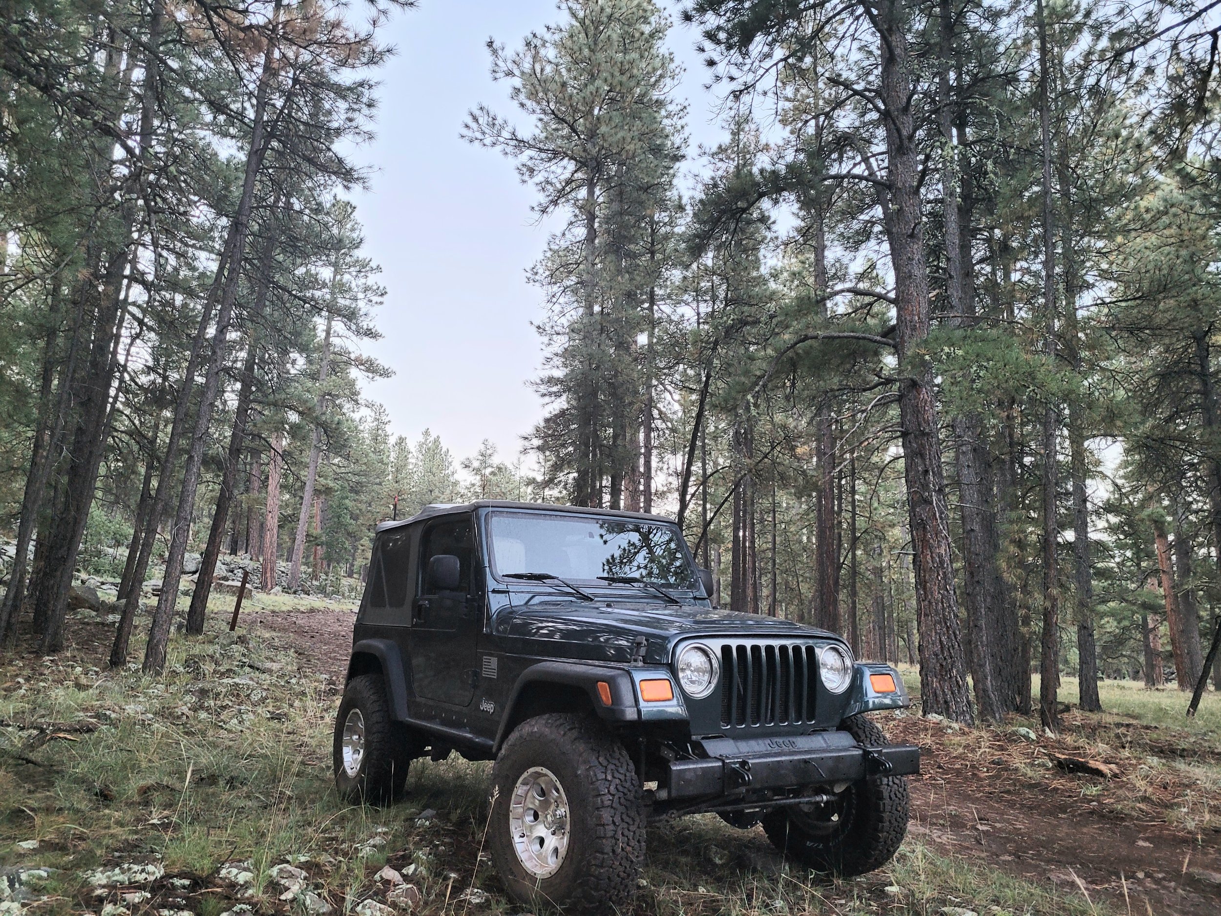

33x10.5-R15 KO2s on 15x8 rims with 3.75" BS. I'm running 2-2.5" lift OME springs that netted ~2.7" of lift + a 1.25" body lift.
Tires stick out just under 1.5" past the stock flares. No rubbing under any conditions. Rubicon/Sahara flares would just about cover the tires. Rough Country also now makes flares that are the same width as the Rubicon/Sahara flares.
