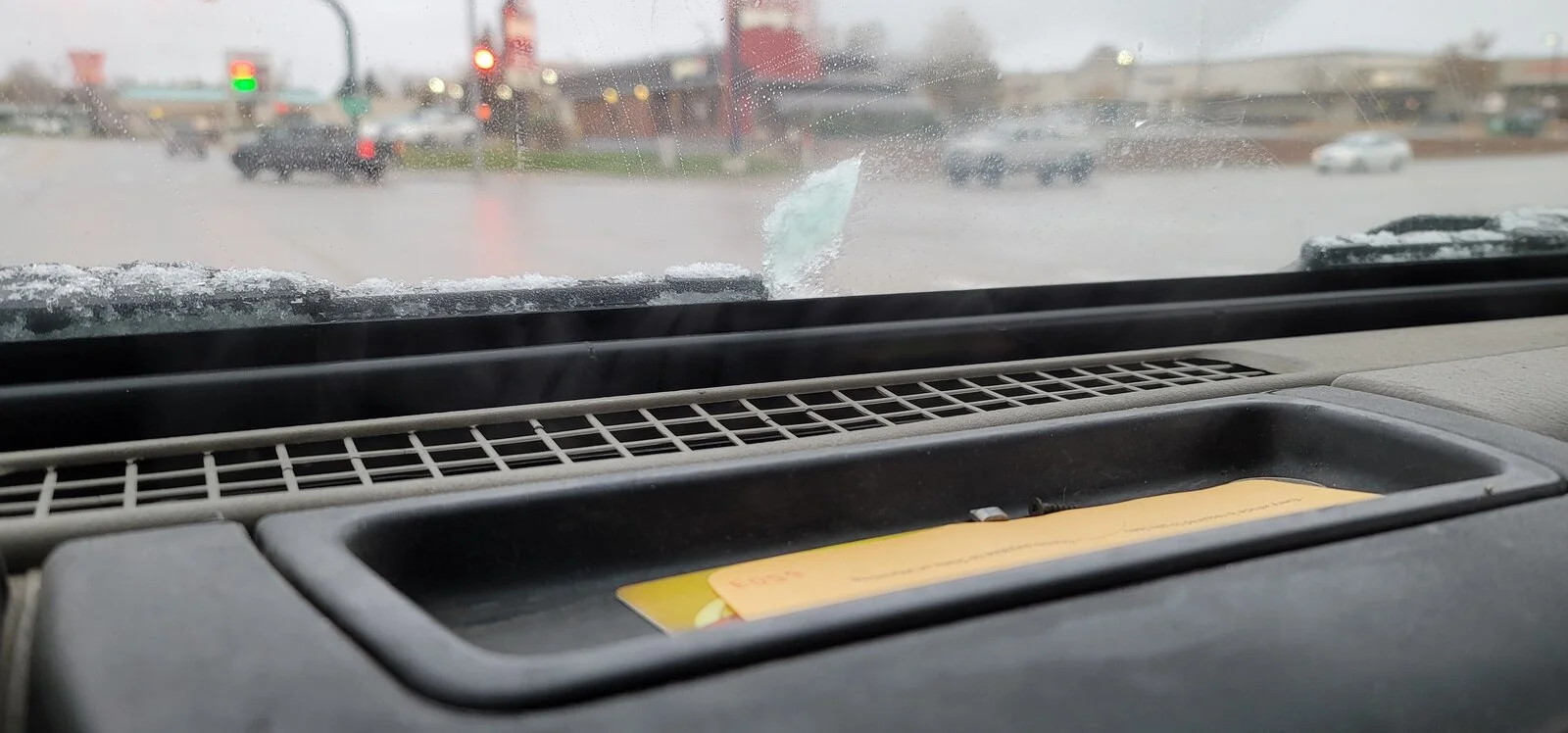

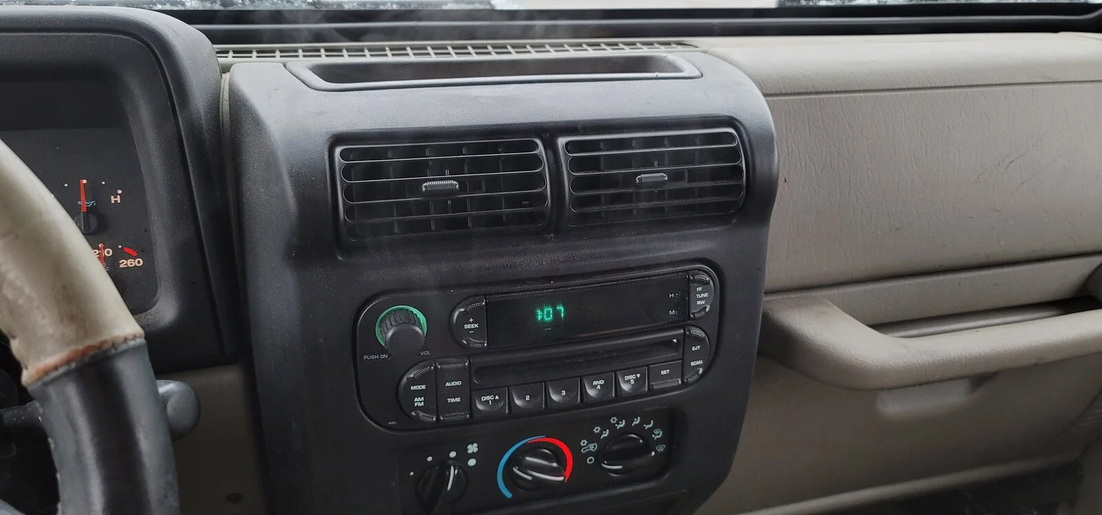

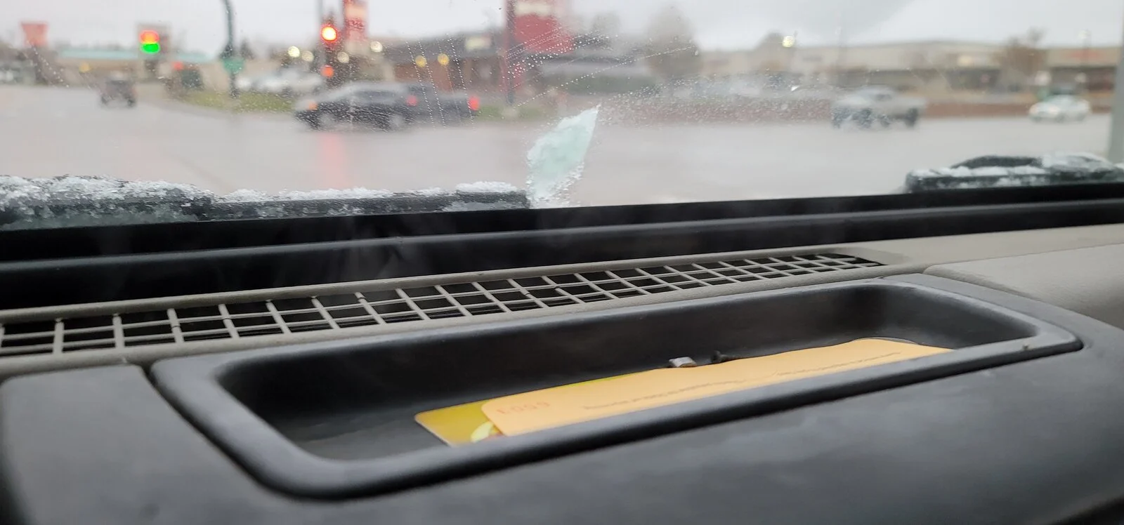

Just saw this while driving this morning.
Heater was off, no vent or anything. But this smoke/steam was coming out the vents
That steam is normal, Jeep typically does that spooky stuff around Halloween time 👻
Looks like you guys have settled on leaky heater core, regardless of whether that is the cause or not, i always lose coolant when temperature change. From hot to cold and cold to hot, it does what it does and magically poofs from max to min worth of coolant in reservoir.
