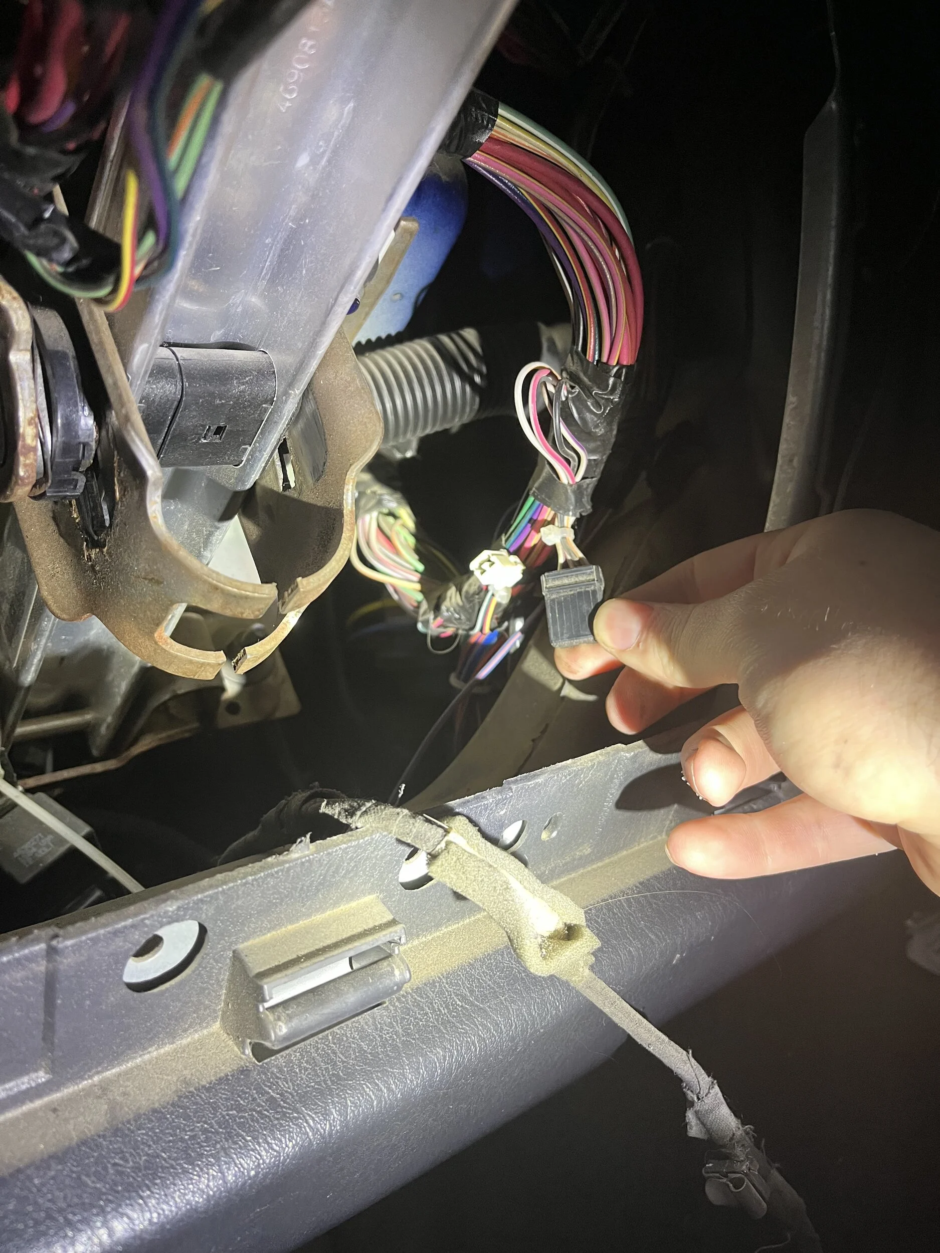

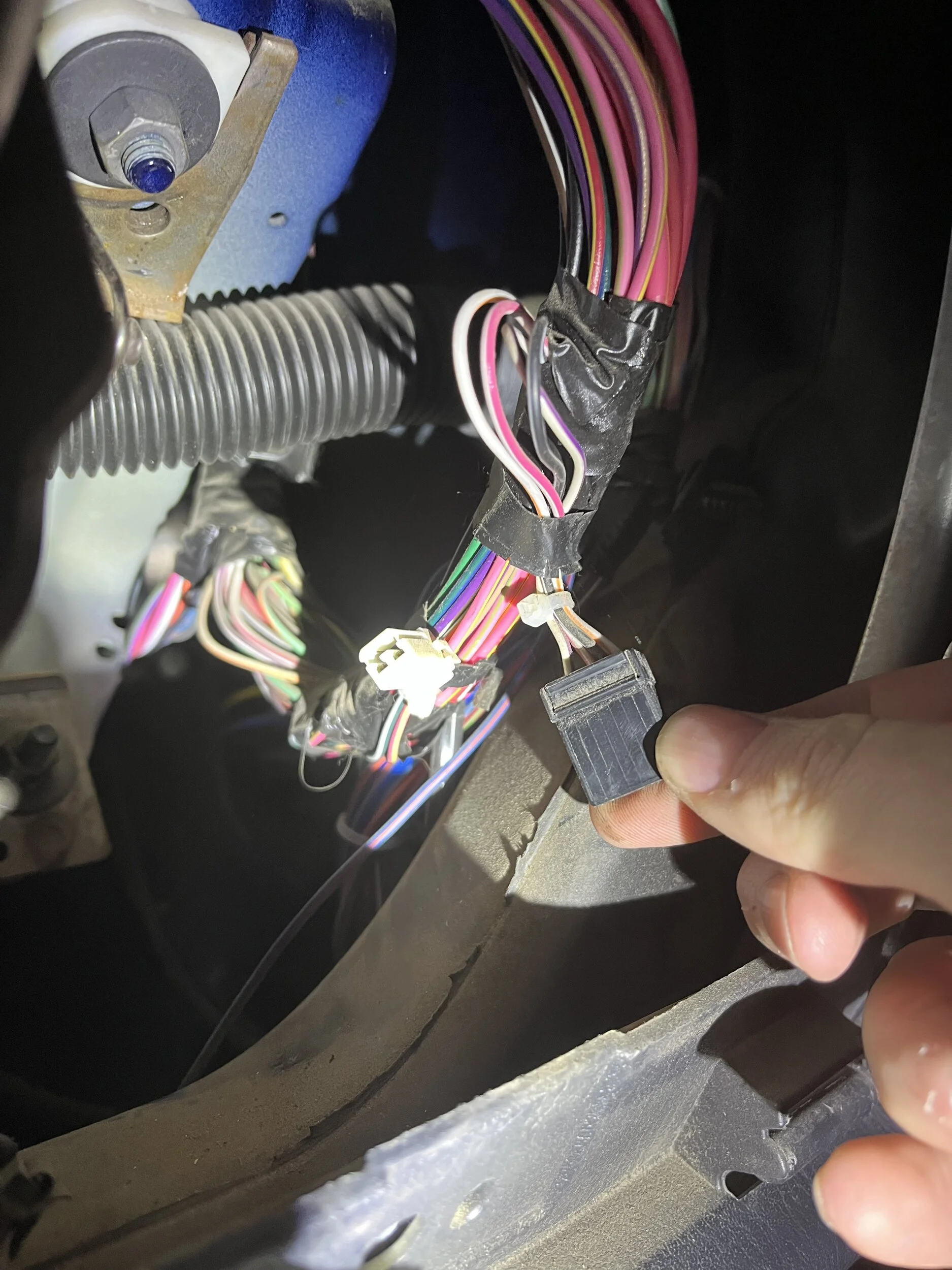

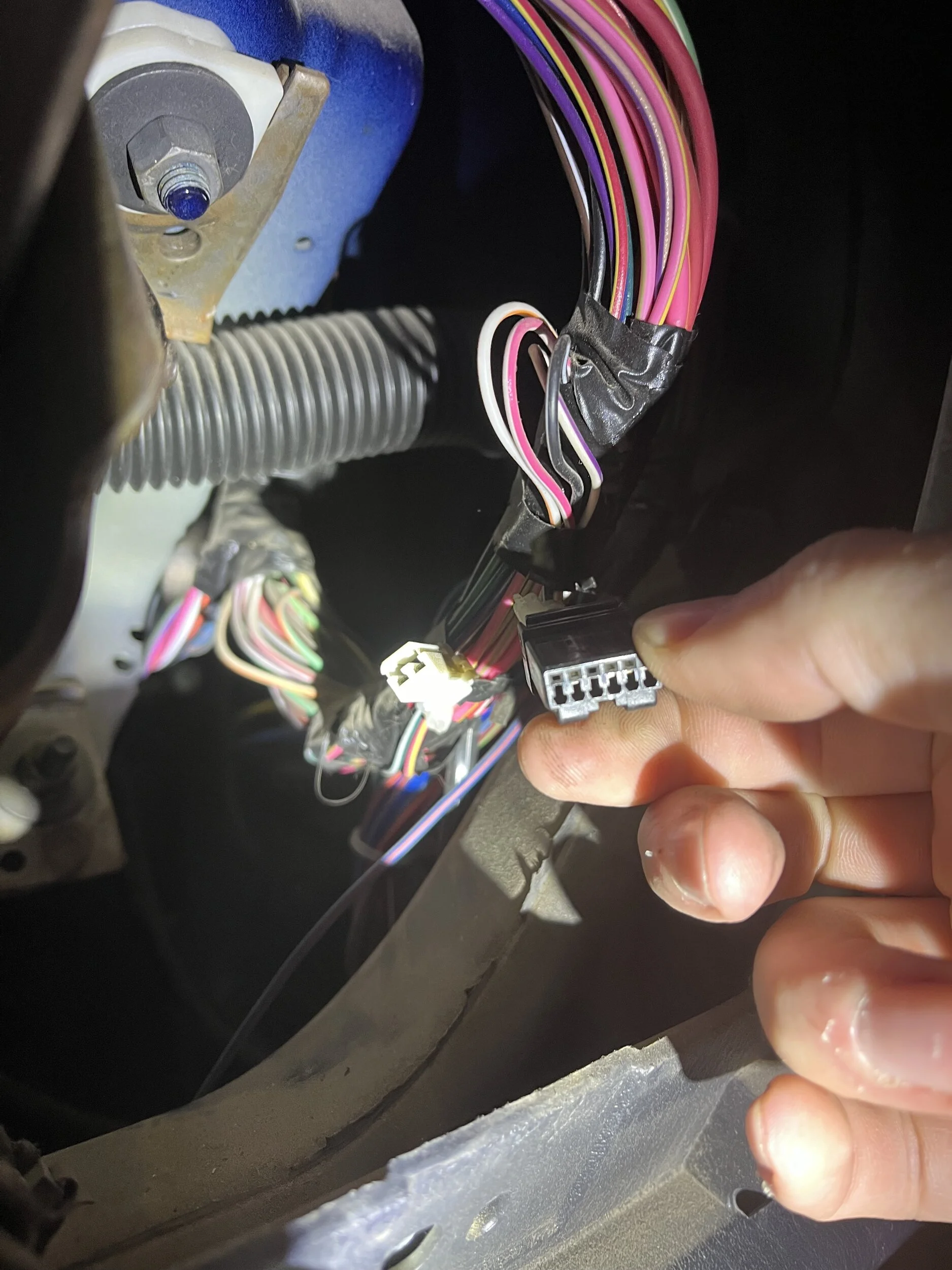

I’m working on installing cruise control and when I got under the dash I found these connectors chilling. Was wondering if anyone knows what they’re intended for?
Black connector: white w/ orange - black w/white - white w/ pink - white w/ violet.
White connector: green w/white - pink w/ yellow
the service manual, which you can download here, has wiring diagrams. That is quite helpful for these questions, and in the process of researching where those wires go you will learn a lot more about your wiring. That will come in handy later.

Note: @Tytanium94 it would be good practice to see if you can find these plugs in the manual using the info you listed in your first post. It's worth mentioning that the official wiring color of one wire was PK/WT instead of WT/PK. That's a good lesson for when we search for things...if you can't find a color combo, flip the colors or consider if one of the colors aren't what you think they are.
