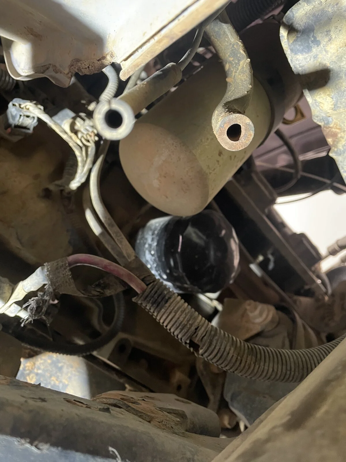

The hose to the reservoir has a crack on the boot. I unplugged it from the reservoir and plugged it with a golf tee, but that doesn't seem to affect operation. I'm going to double check those tests here in a little bit. Is there a good replacement for this boot/hose, or do I just get some hose from the parts store and cobble together fittings to get the sizes right?
Here is an assortment. Check the line right at the firewall I have found a lot of leaks there, bend the hose a bit to look for cracks.
