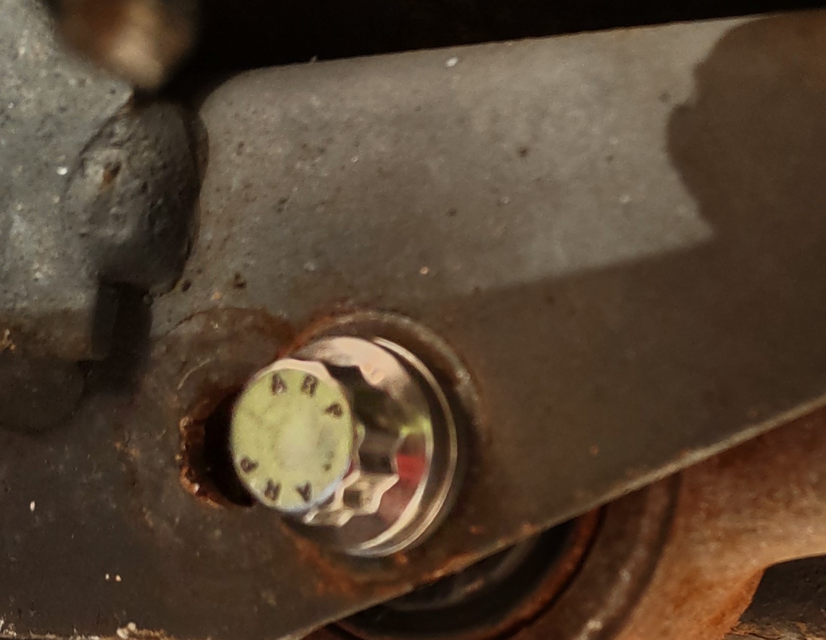

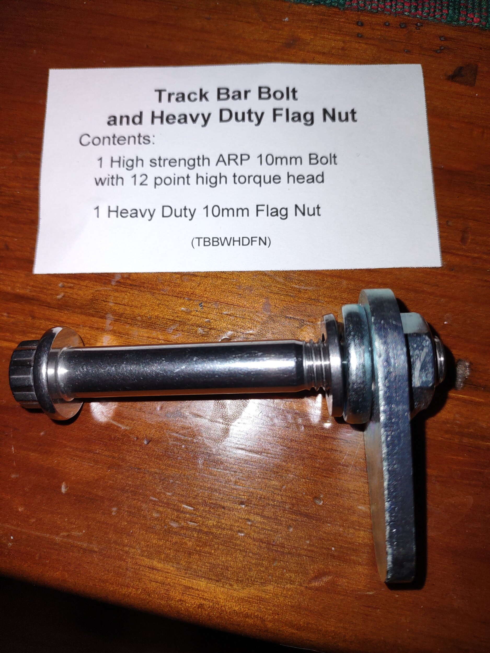

Mine's been like that for 7 years.
BMB HD flag nut and bolt keeps it secure after torquing it properly.
