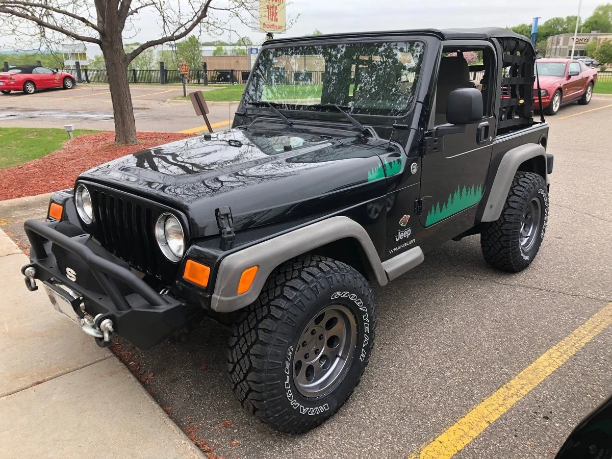

If you're running stock suspension, then a 31" tire is about as large as you'll want to go in order to prevent any rubbing.
BFGoodrich KO2s or Goodyear Duratracs are tires with a good reputation around here. Personally, I'm running with 31" duratracs and love them. You do get a bit of tire noise, but it's not bad and the wind noise from the Jeep's stellar aerodynamics (lol) tend to drone that out at high speeds anyways.
Here's what mine look like, although you might have more room above your front tire if you don't have a heavy front bumper and winch like I do:

Nice looking Jeep. I like the look of those tires. I think I will go with 31s for now and spend my money on mechanical issues. I've got a grinding 2nd gear that I have to deal with now! Thank for your help and the link.
