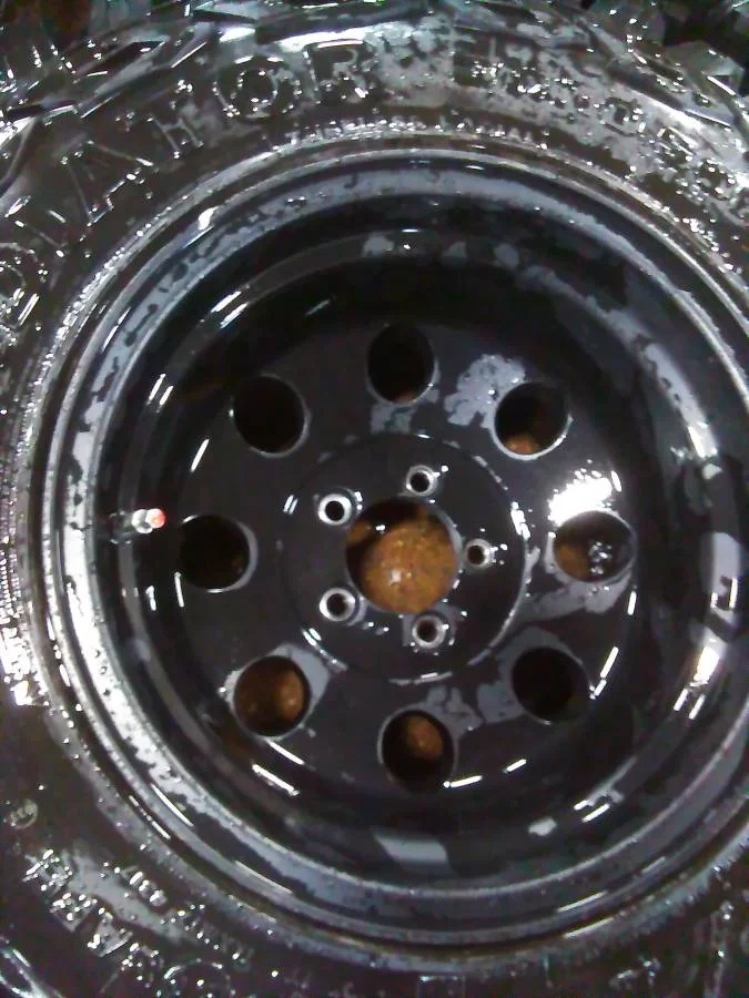

I wouldn’t recommend buying tires or anything else that is wet to make them look better. Need to see them dry to spot dry rotting and real condition. I’d pass if I were you. Don’t by tires that are posted with tire dressing either. Just some friendly advice

And I agree with chapman. Do not waste time on anything polished to look like something it is not.

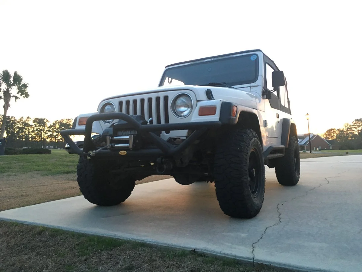

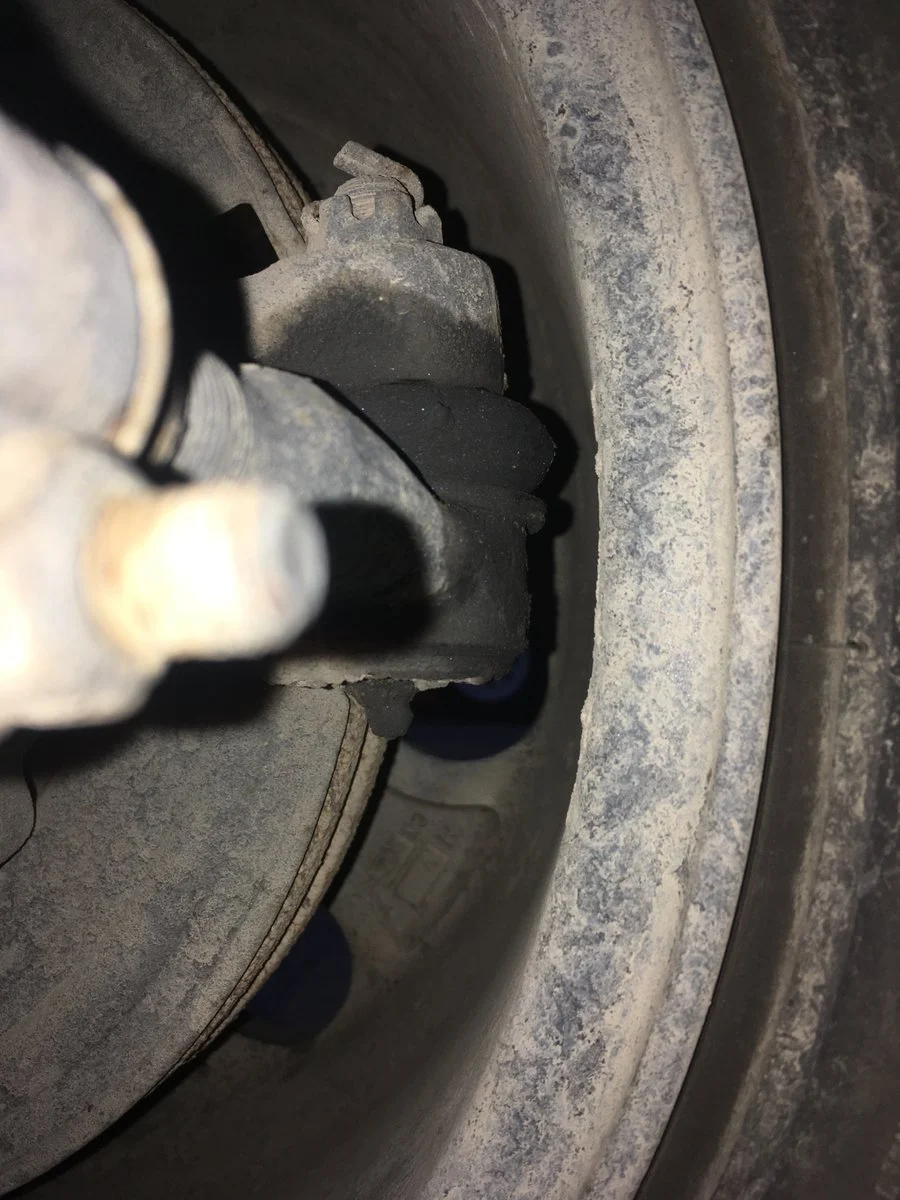

I run the 8x15 version of these same wheels with 31x10.5 tires on my 99 TJ with a 2" spacer lift an 1" body lift. My wheels have a +20mm offset which gives the wheel roughly 5.25" of backspacing. I am old school and like my wheels tucked in under my fenders. With this amount of backspacing, it definitely comes real close to the tie rod ends, but I am happy with where they sit.
