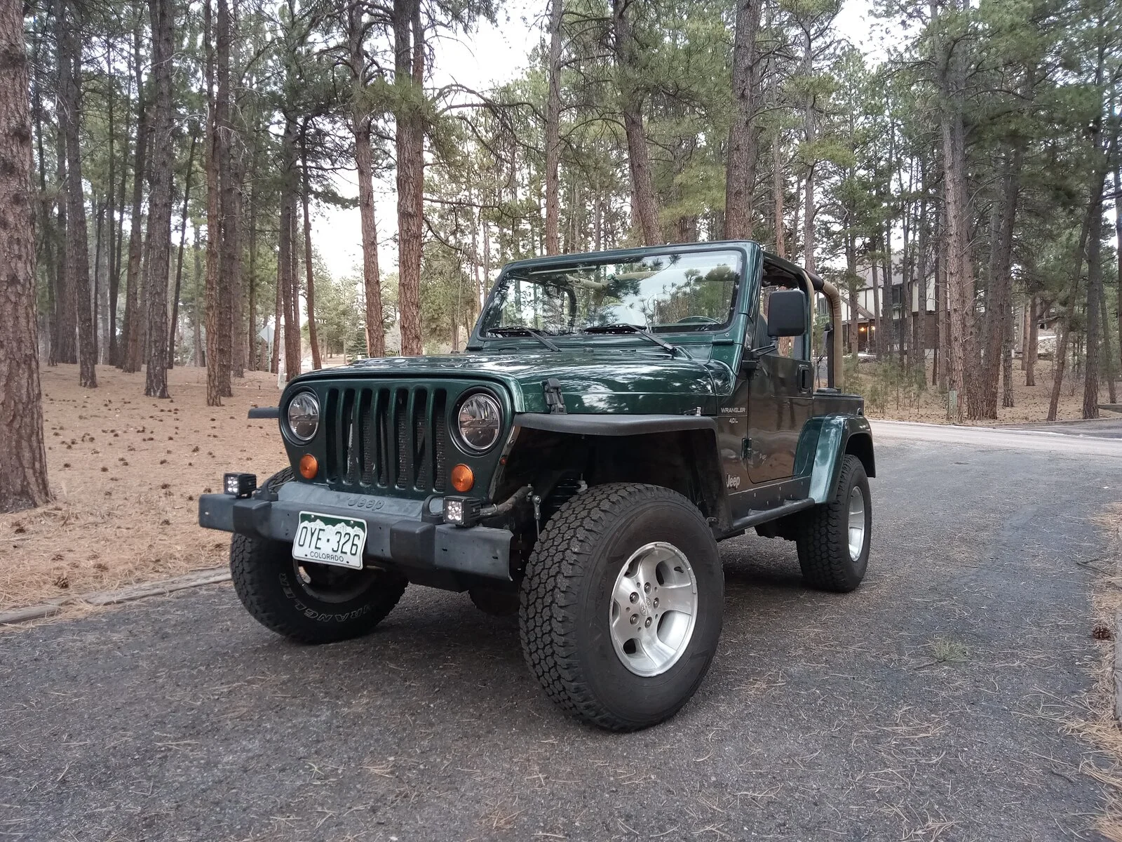

I want to run a set of rims from a Golden Eagle on my Sport. They have a 5.5 offset versus a 5 for the factory Ones I have now. Running 31x10.5 tires and a 2” ome lift. Am I going to have a rub issue?
X2, that 5.5" dimension is the wheel's backspacing dimension. Don't confuse that with Offset which is a different measurement. I wouldn't run a 10.5" wide tire with 5.5" of backspacing but it can be done if you add a washer or two under both of the steering stop bolts.That's called backspace not offset. Big difference. But I have no idea about the fit, but don't think the 1/2" would be a problem with your 10.5's. if they rub, adjust the steering stops.
To a point, unless you have to parallel park into tight parking spaces as I sometimes do.As that guy that specializes in Black Magic often says, the rub at full lock steering lock is nothing to worry about, just let off a little and it wont rub.
again...backspace is what you need to worry about, not offset.Both sets of rims have a 5.5 backspace but one is a 15x7 with a +38 offset and the others are 15x8 with a +25 offset so there should only be 3mm difference between the 2 if I’m figuring this correctly. Should be good to go I think.
