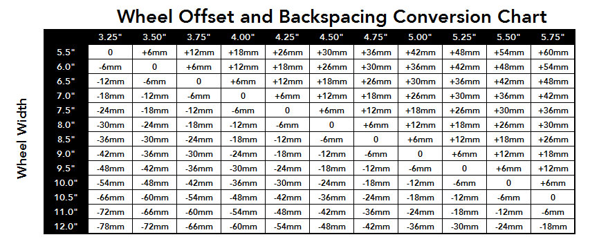

This chart may help as well:

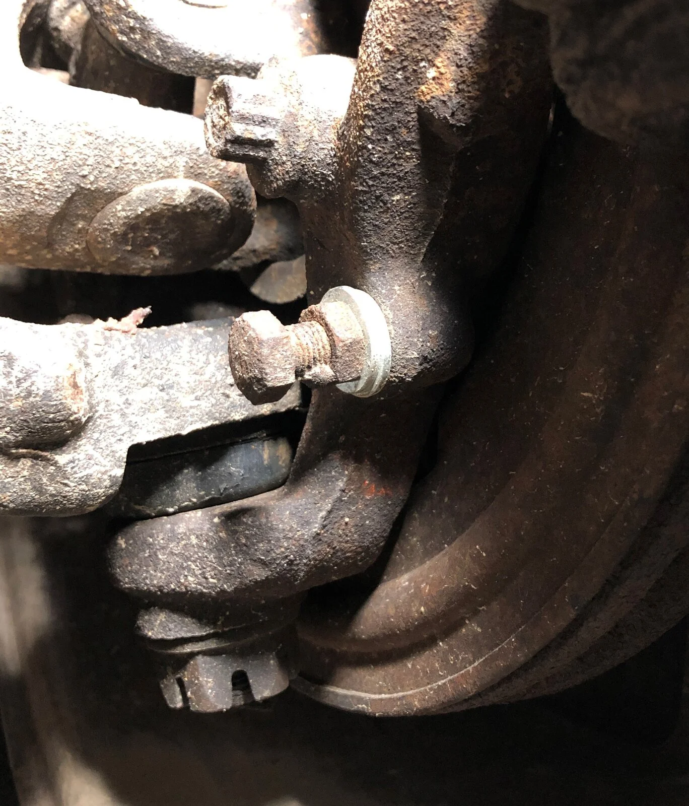

I was worried that I may have issues with my factory Grizzly wheels, which are considered 5.5" backspacing and 15x7. It has been a non-issue. I did put two washers on the steering stop bolt and I have had no rubbing at all and no significant diminishment in turning radius that I can tell.

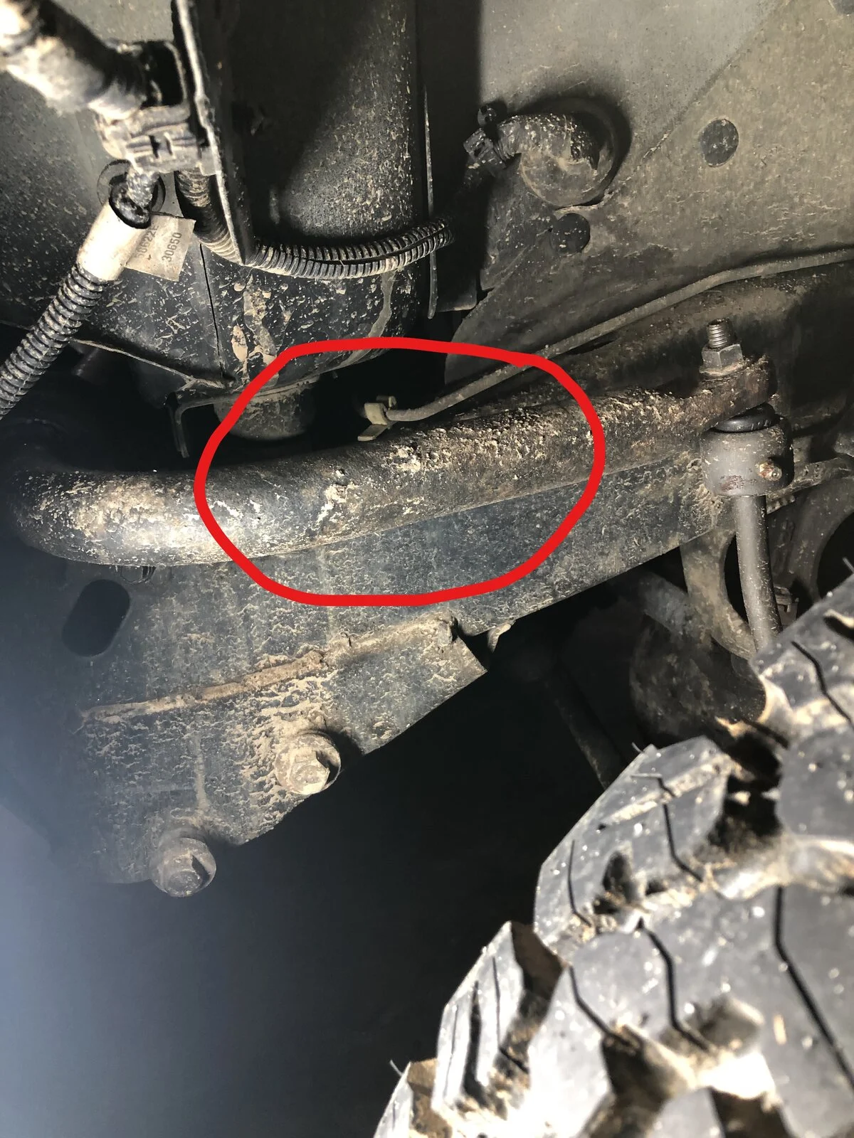

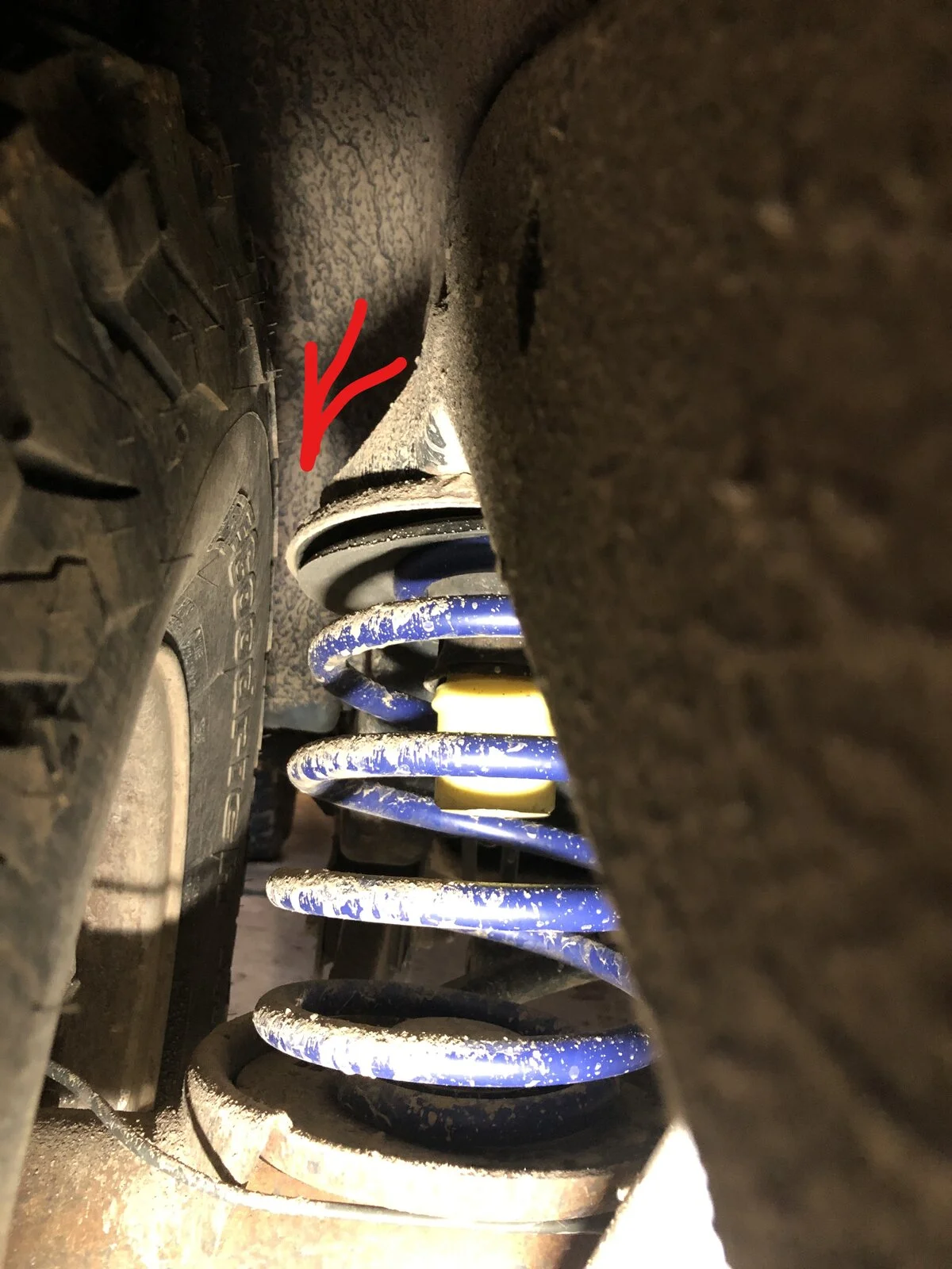

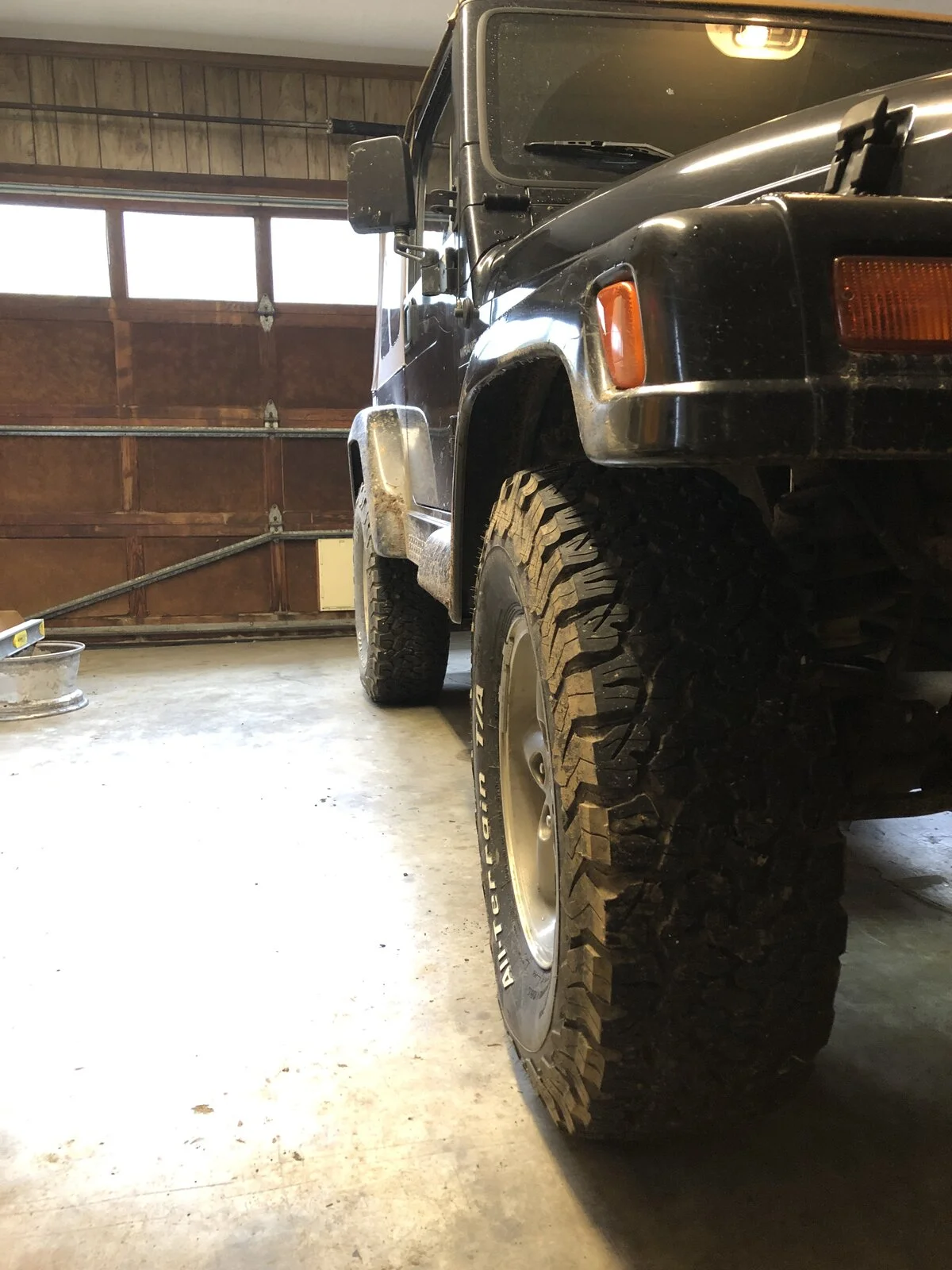

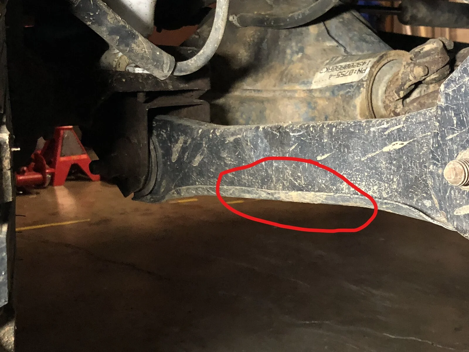

These are 31-10.50-15 BFG's and I wanted to maintain the tire under the flares. Including photos to hopefully illustrate.
Rear upper spring perch clearance on drivers side, which is the tightest since 1" lift springs do offset the rear axle just a smidge to the passenger side
No rubbing on front sway bar
No rubbing on front lower control arm
Two washers on steering stop cure all.

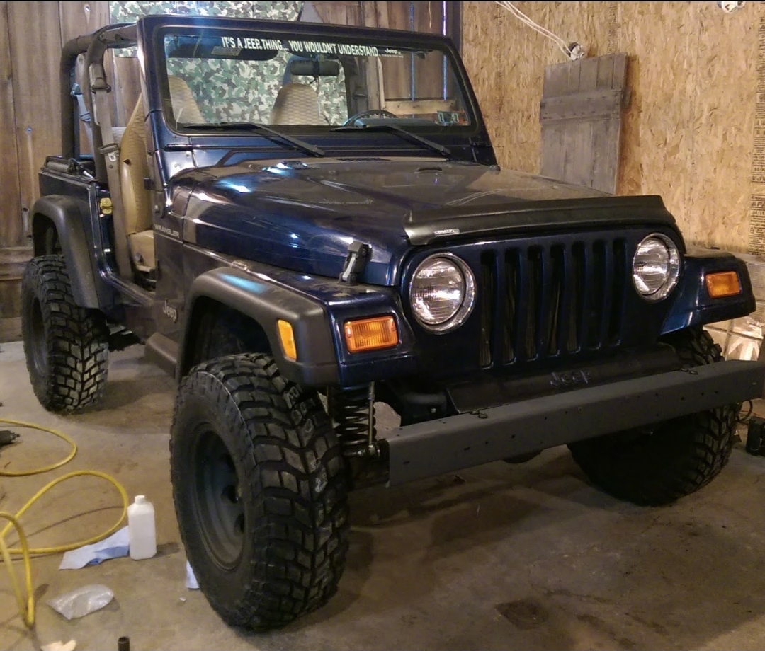

When I bought my 2003 X, it had 235/75R/15 tires on wheels that had 5.5” backspace. I didn’t like the wheels plus I wanted a little more aggressive look. I went with 31x10.5x15 tires on aluminum wheels with 3.75” backspace. Wheels are 15x8. My suspension is stock. I like the look and it rides and drives with no issues.

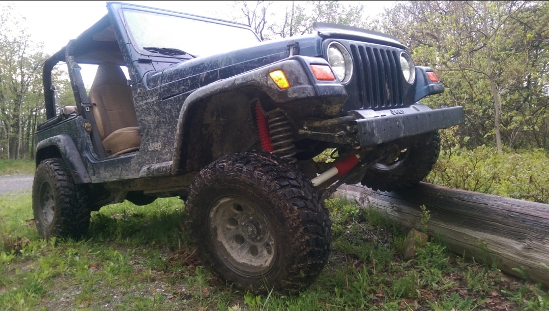

I've run these on several TJ's i owned and installed many for customer.
Look great...the finish holds up really well..pretty damn tough too

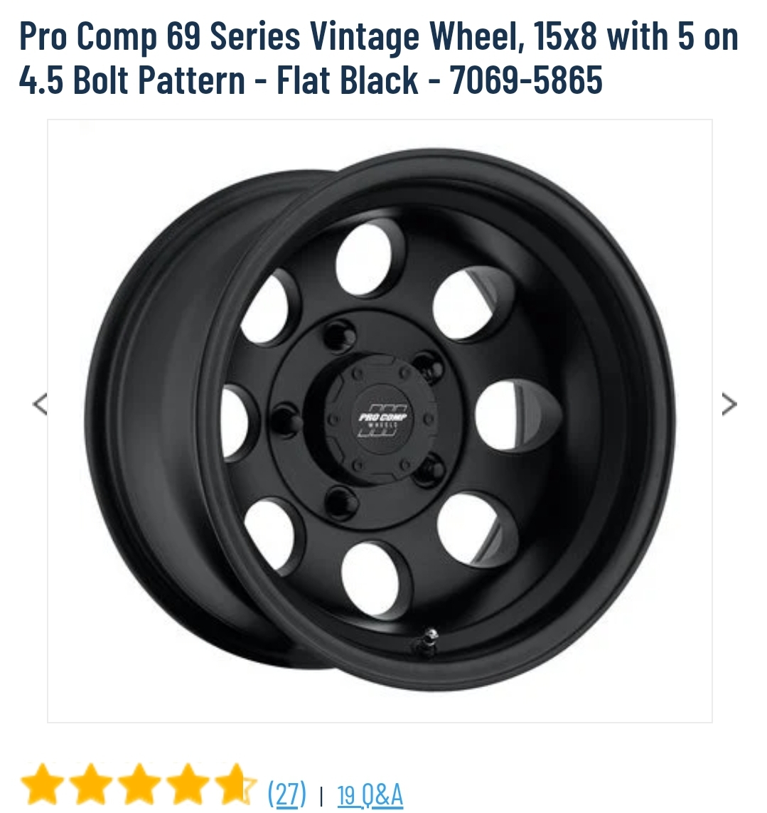

I don't know if these guys are sponsors and I'm not in bed with them other than a vendor of ours but here is a retail link to some 3.75 BS in 15x8
https://www.4wd.com/p/pro-comp-69-s...6!3!389350609662!!!u!293946777986!&s_kwcid=AL!{7836}!{3}!389350609662!!!u!293946777986!&ecmp=s:google&utm_source=google&utm_medium=cpc&utm_campaign=shopping&emlprox=out&ppcfon=1&gp=1&gclid=Cj0KCQiA1KiBBhCcARIsAPWqoSqHzRr7raqkrC83PXqotik3G_F3SaesULvRY8OvU-7USOhiALjSbHoaAhHMEALw_wcB

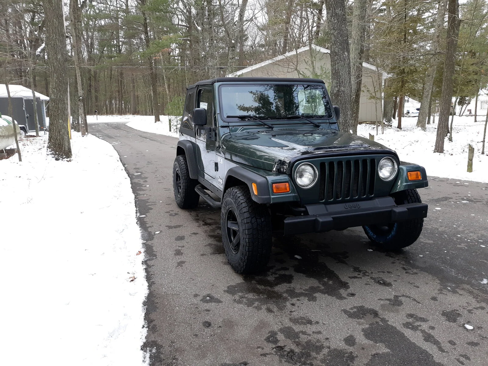

Just know the 3.75BS will be out past your flare but it's a small amount. It's not ignorantly out too far like some weird ass mall crawler.
The photo is with a 31x10.50x15
Here’s a couple pics.
Reactions: TJim
