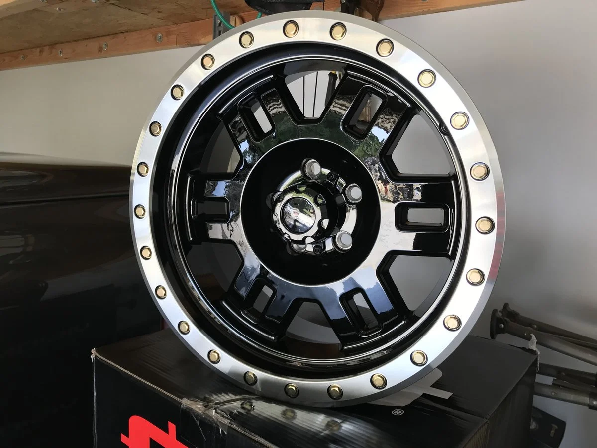

I went against the grain on the forum and went with a 17x8.5 one piece aluminum wheel made by Vision (been in racing ind. since 1975) I plan on running an AT 60 on a 32 or 33, I'm not a fan of the balloon look. My jeep never leaves the road. I paid $130.00 for these at Extreme Customs and would highly recommend them for their service and prices, no one could touch 'em.
