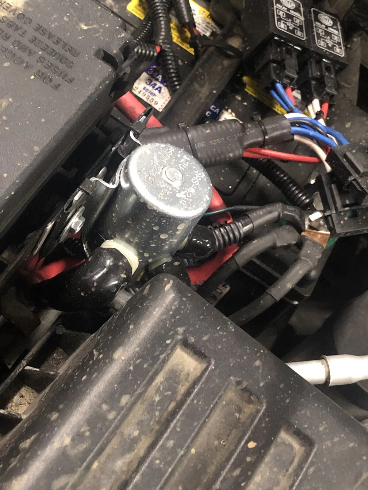

I was looking at this location in my '06 for the same purpose. The wiring loom and vacuum lines are routed differently and make this a bit more difficult. But now that I've seen this picture, I'll take another look and see if I can reroute them.I am looking at the firewall as a possible mounting location for my winch isolater solenoid.

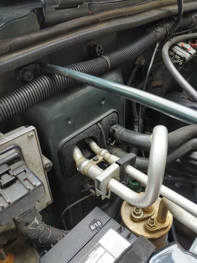

I noticed 2 divots above the AC lines, and wondered if anybody knew the clearance behind them?
as I want to install 2 riv nuts.

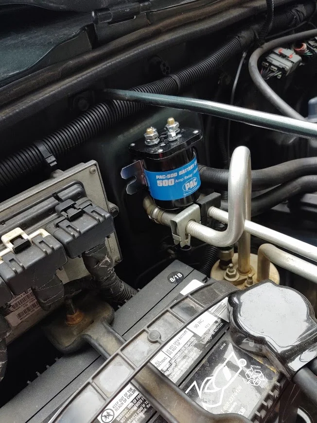

this is what I am trying to install in that location

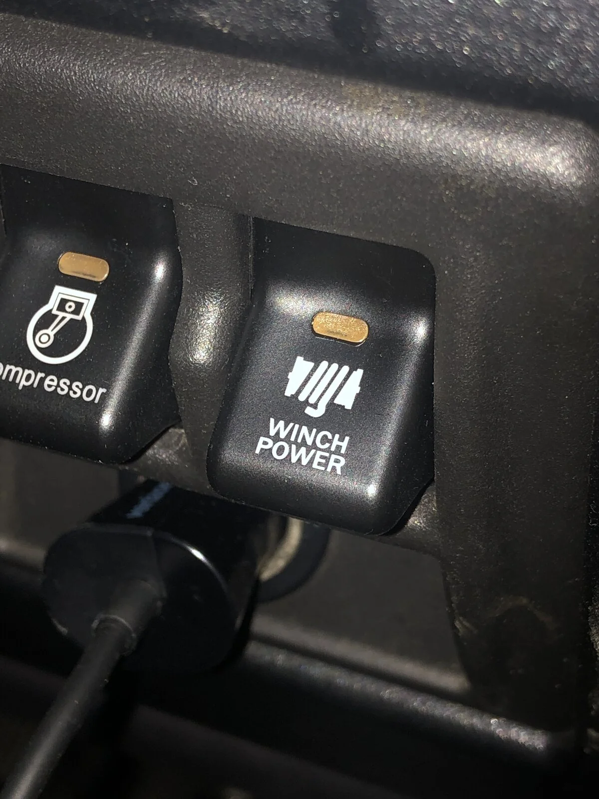

I JUST DID THIS, I used the warn kit,(Amazon) 70.00 I mounted it to the outside circuit box.and used a tj style switch to turn it onI am looking at the firewall as a possible mounting location for my winch isolater solenoid.
