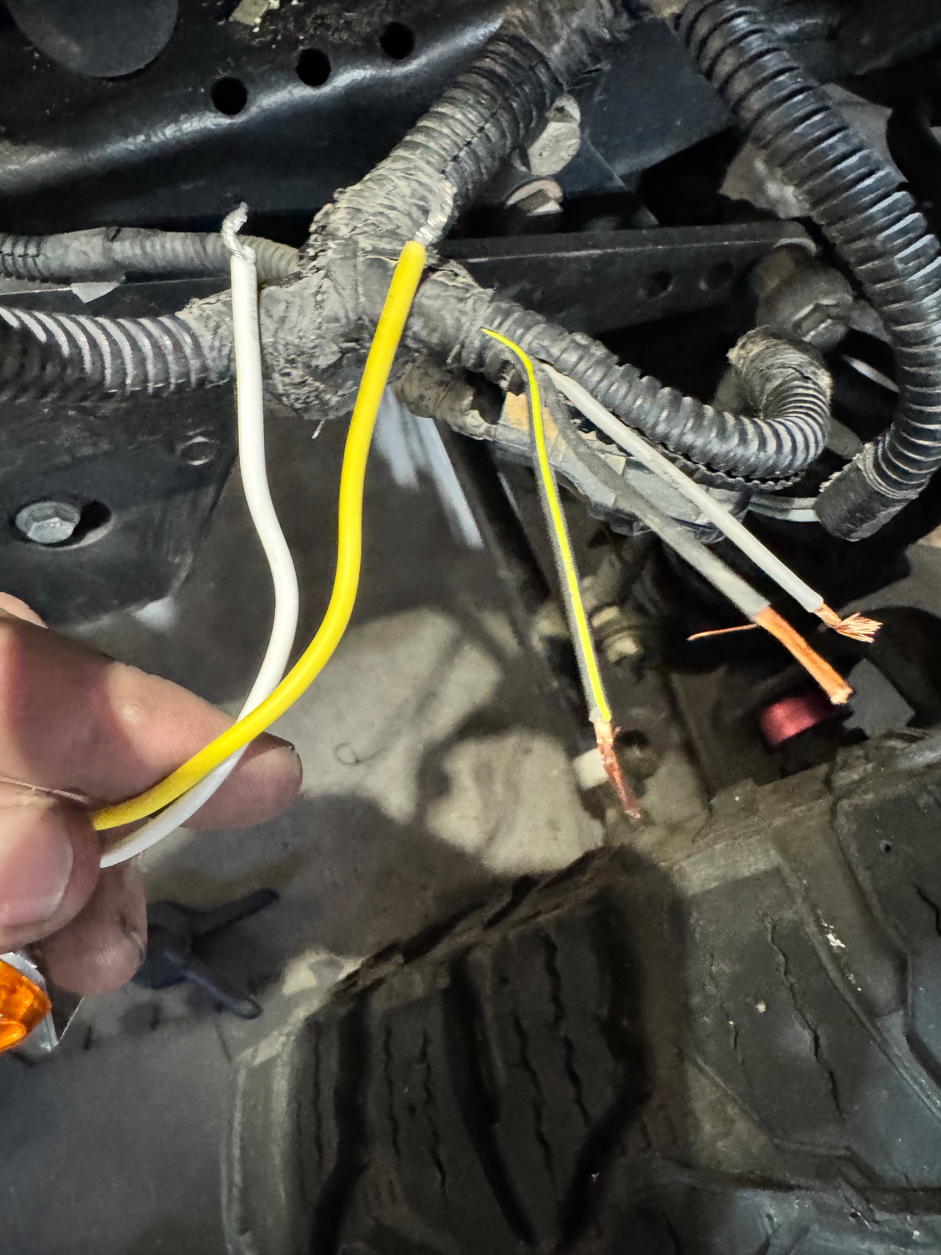

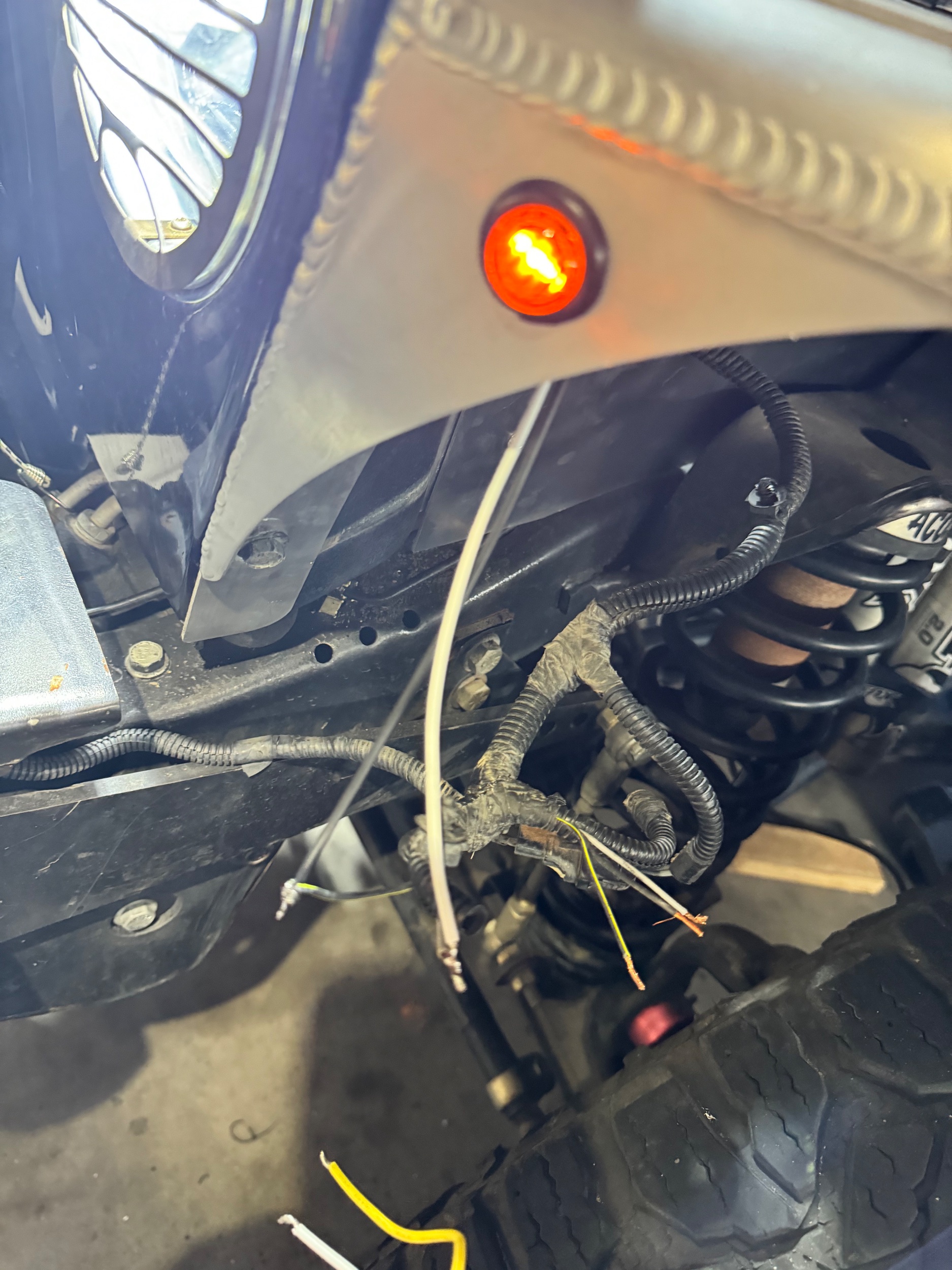

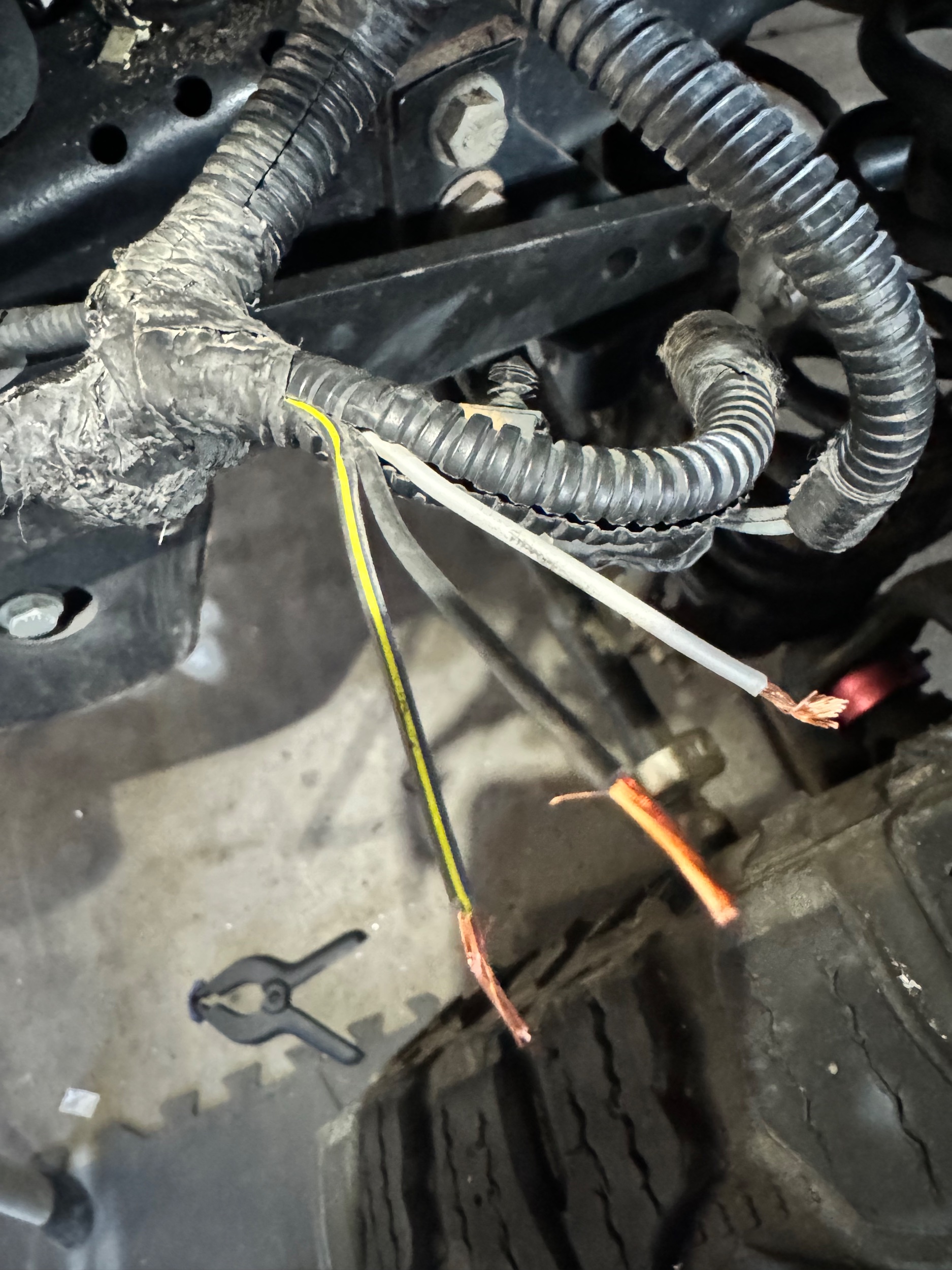

installing Genright fenders with the light kit. Prior to me touching it, everything was working.I hooked the little round ones back up to ones I had there before and have running lights. I cut the wiring harness (3 wires) and now I can't get anything to work. I can get running lights but can't get anything else to work. Rear blinkers are out now too, can't even get little green arrow in cabin to light up, hazards are out as well. Can one of you please color coordinate me

If I recall correctly the front turn signals and running lights switch polarity. Took me a minute to figure it out and get mine patched in right.
-Mac
You'd think postive to postive and negative to negative but then you switch on the headlights and the polarity reverses. I'll do some forum searching and edit this post with a link.
-Mac
