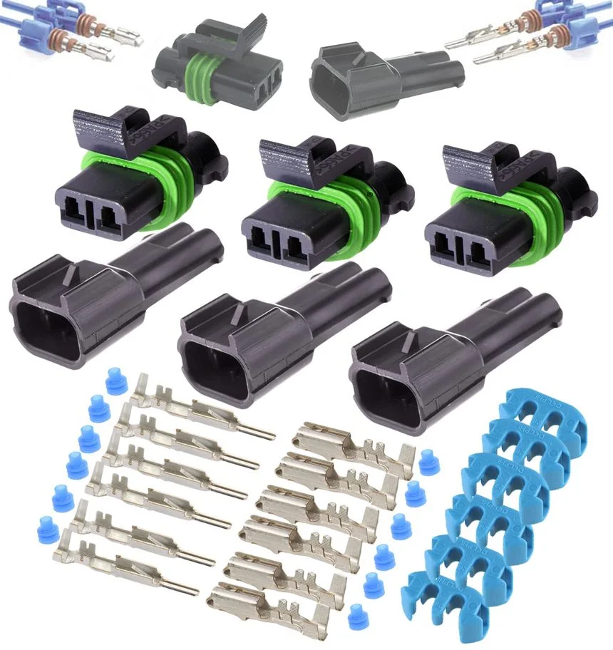

I havent seen every Jeep connector but I use these for weatherproofing connections on rewire jobs
The termination is the only area of ingress typically on a circuit unless its compromised sheathing.
Weatherpack / Metripack delphi connectors
