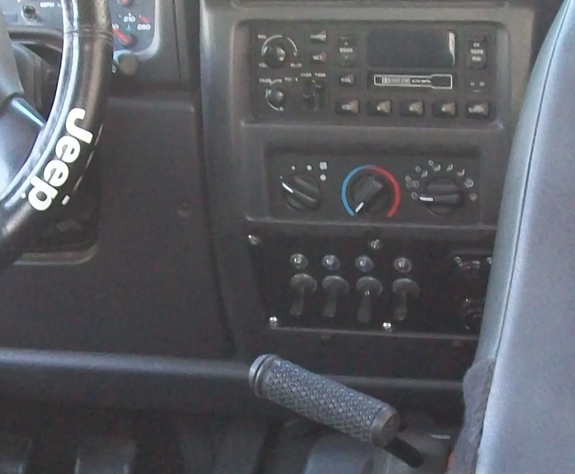

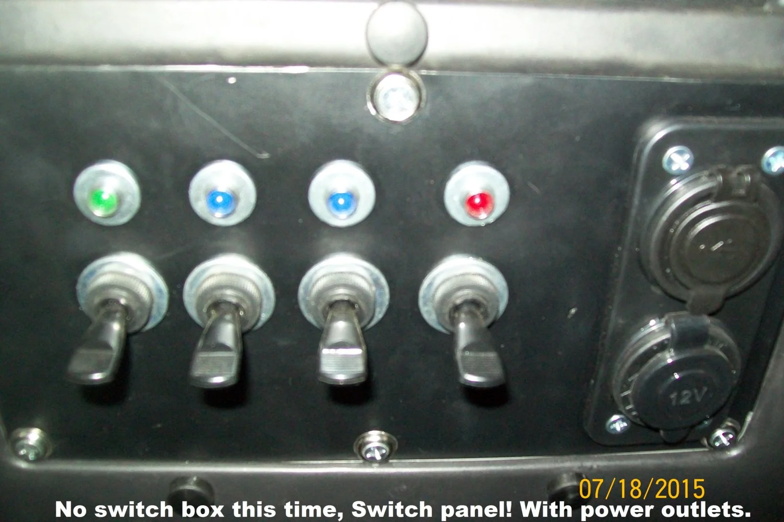

My set up:
It wouldn't be hard to use the switches you want.

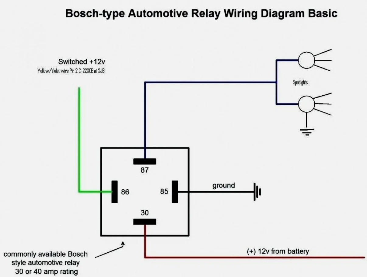

Whatever switch you choose to use, make sure to use a simple 4 pin relay and properly rated in-line fuse (between battery and relay) for each switched component. It's a super cheap and easy safety measure.
Are the lights LED or halogen? Lower power LEDs don’t necessarily need a relay, but most halogens and higher powered LEDs will need a relay due to the current draw.
