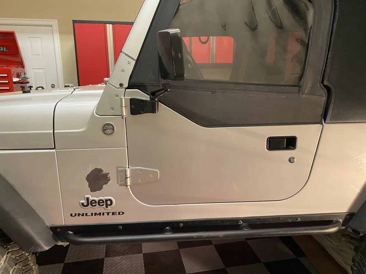

Ya, I scored. Usually I see them for about $500 without uppers and in a bit of rough shape. I happened to be browsing craigslist car parts with a "jeep" filter and saw the ad just an hour or so after it posted.
Silver doors, no rust at all with one tiny dent. Black interior panels and black upper doors too. They are missing a few trim pieces, but otherwise in great shape. Unfortunately, I have a green Jeep with tan interior, but when I saw them I called immediately and met him just an hour later.

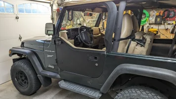

I wrapped mine last year. Used some 3M vinyl, did it in my kitchen. I had never done vinyl wrapping before. Maybe a smidge sloppy around some of the edges on the backside but most will never notice and it's holding fine. Of course my Jeep is just a mishmash of different shades of black so no concern at all was given to that aspect. $76 for a 5x4 sheet of 3M 2080 series from rvinyl.com

I had to drive to Madison for these doors. But it was worth it, they're pretty.

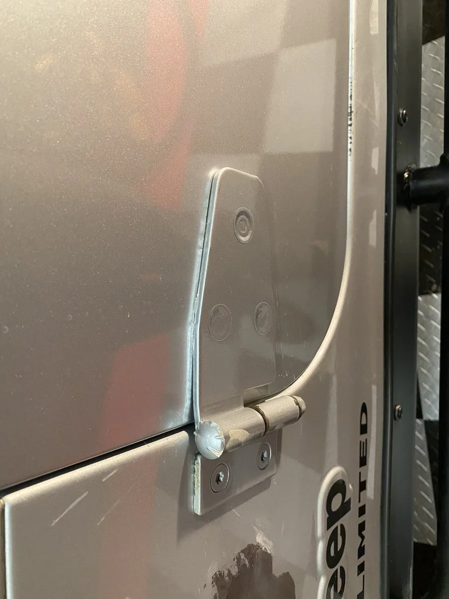

I did do the wrap. I had never done it before, but the flat Jeep doors made it pretty easy. I used 2 rolls of 3ft x 5ft VViViD 3MIL matte black from Amazon and it turned out well enough that I still have it on. My TJ is green, but I thought a flat black would look better than an un-matched green.
The hardest part was probably the hinges. I dismantled the door, but getting the wrap around the hinges was hard and is the worst looking part, but again, it is not a show car, so is good enough for me. The top of the door was also a bit hard to get to lay flat with all of the different Angeles, so I have some bubbles there as well.
