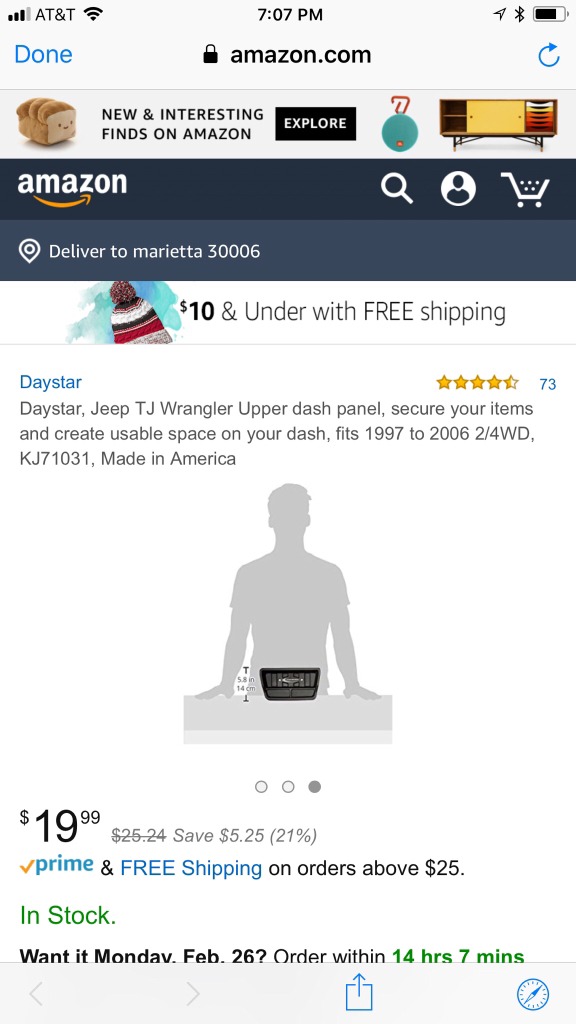

I find this to be very handy, and only 20 bucks. Daystar dash box.
https://www.amazon.com/dp/B001O0FY6A/?tag=wranglerorg-20
Why do they have to represent the size of this dash tray by showing how it would cover your junk?
Sent from my iPhone using Tapatalk Pro

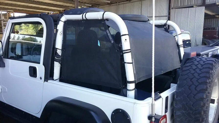

Would a Spiderweb shade/Alien shade be considered a low cost mod?
Which do you have and how do you like it? I’ve been thinking about a Trektop NX frameless and one of the suggestions was to get a spider shade or TJ-kini for storing the windows overhead when running safari style.
One of the best low cost mods I've done to date. I have the TJ kini on 24/7, and some Spider sides to contain the dogs when they travel with me.
