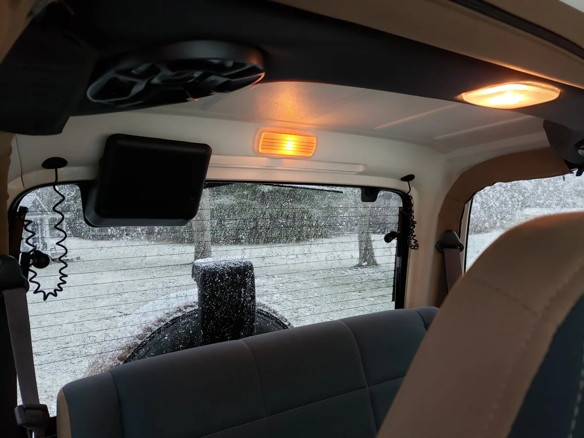

Thanks Chris, this is really helpful. What about the interior bulb that's built into the hardtop? Some may call it the cargo area bulb?
Just thought this would be a handy thread to have as reference. The light bulb types / sizes for the 1997-2006 Jeep Wrangler TJ are as follows:
Mine does...is this not a factory hardtop? I have a '99 Sahara:
