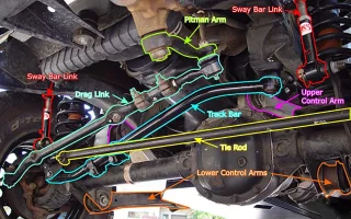

It absolutely could be caused by an imperfectly balanced front tire. Especially if one of the rod end joints on the drag link, tie rod, or track bar is worn and loose.
With the tires on the ground have a helper do repetitive quick short left right turns while you closely watch the steering system for sideways slop at the rod ends. Rotational play is normal for the drag link and tie rod but not sideways play.
