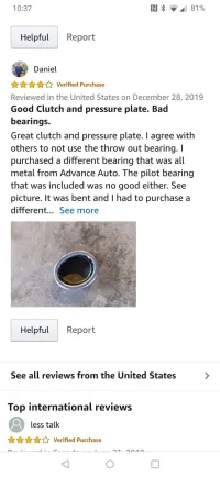

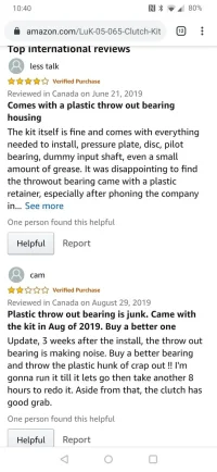

What fooey said ↑. The National throw out bearing is better than the one that comes in the Lux kit which is junk. The Luk TOB I got was milled and assembled with an elliptical orbit. It never would have worked.
I ordered the National ahead of time based upon advice here. The Luk clutch is good. Get some Red Line MTL and change the gear oil while you are at it.

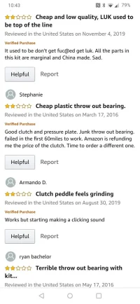

The reason I chose Sachs over LuK, and this is a Coke/Pepsi debate, were the reviews. So many LuK reviews complained about thier throw out bearing, not one or two reviews, but a boatload of complaints. Sachs had none, granted not many reviews, but nothing negative. That was the tipping point for me to go with Sachs.

A good alternative throw out bearing if you don’t want to use the one in the LuK kit:
https://www.amazon.com/dp/B000BZIQ4Q/?tag=wranglerorg-20

The Sachs kit has a metal throw out bearing so no need to buy a LuK kit and an upgraded ToB, but good idea to recommend changing that piece.
