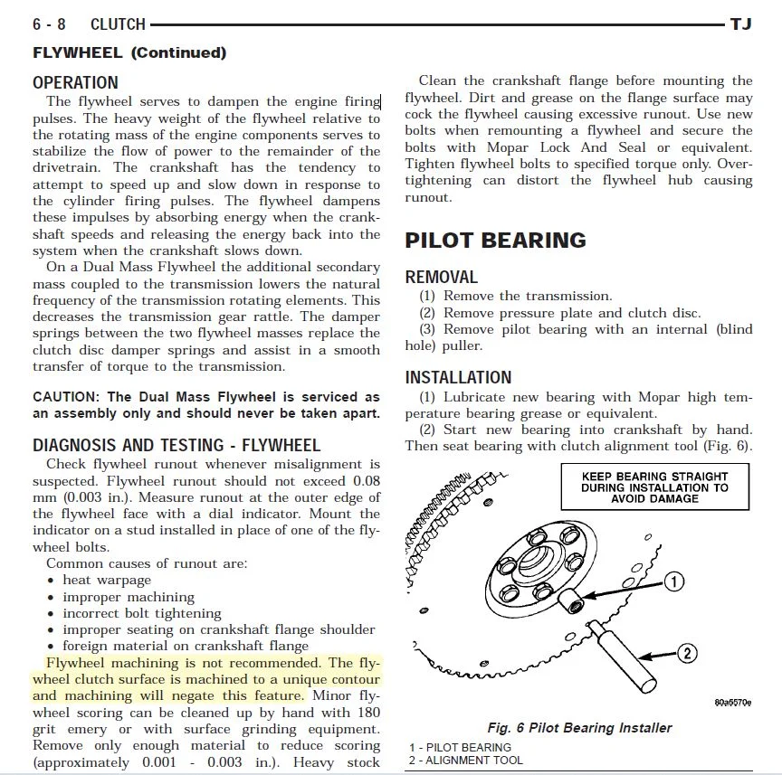

The kicker is, the shop that the PO took it to resurfaced the flywheel and I've read on here that it's not recommended to do so. I've also seen some threads that point to the LUK throwout bearing not being as good as it once was? Do you all think the flywheel could be the culprit for both the chatter and pedal stickiness when fully engaging the clutch or is there something else I should look into?
