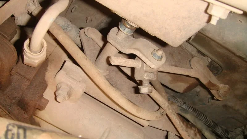

I have a 01' Sport that was having intermittent clutch problems. If I was shifting it would work properly. If I sat with the clutch pedal pushed down for any length of time the clutch would re-engage, and will not disengage until motor is shut off so the clutch pedal can be released. I checked the solenoid. Which seemed to be working properly. I figured it was most likely the throw out bearing. Dropped the trans which was a fight, and a story for a different day. Throw out bearing and fork look good. The clip that holds the fork had come off but was not rusted or broken..... Fingers on the pressure plate look good. Not sure what to do. Should I replace the clutch with a LUK kit since I'm already in there? Or just reattach the fork with the clip, reassemble, and hope for the best? Any advice would be appreciated!
