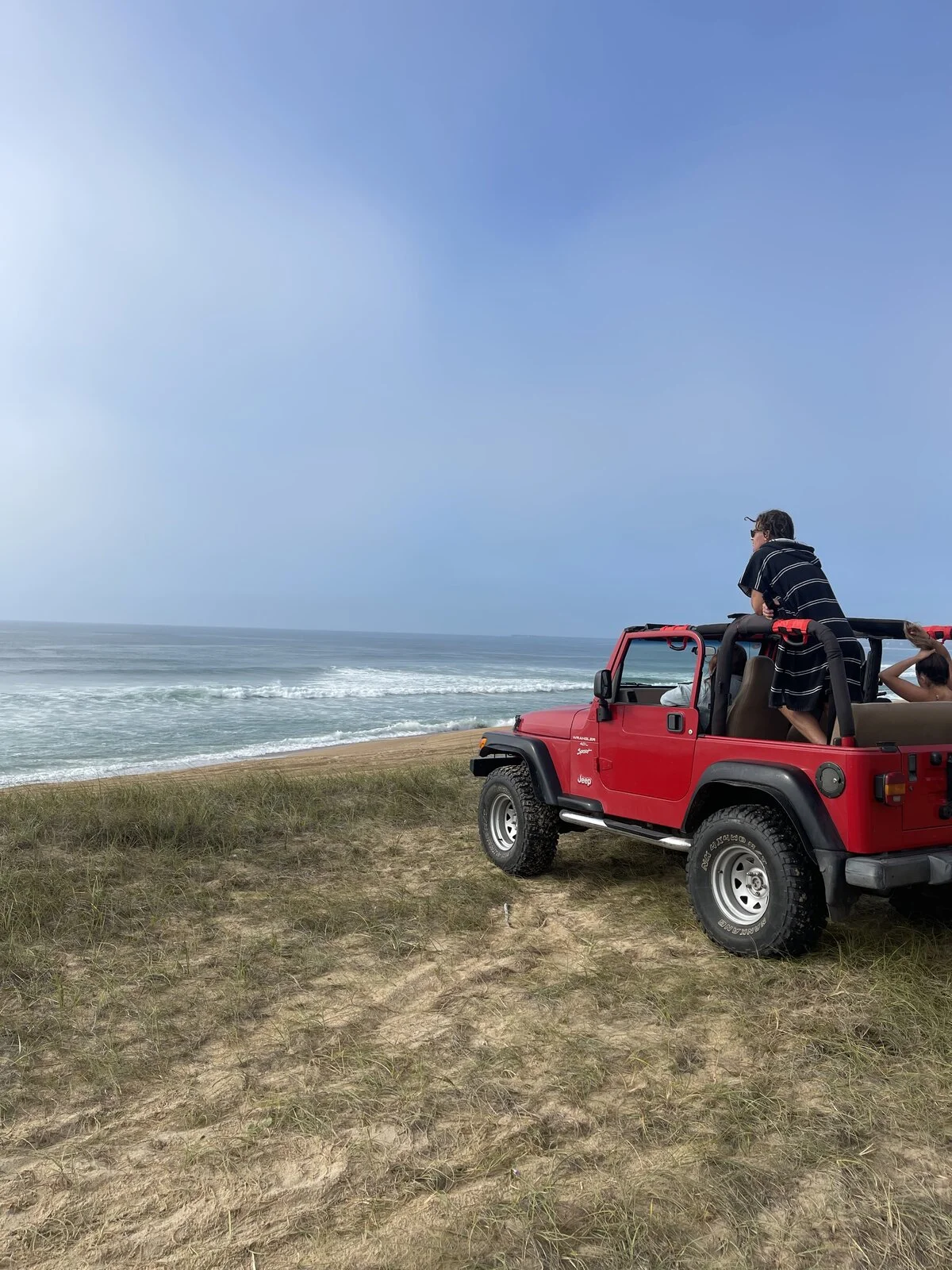

I live 2 minutes from the beach, with beach access for 4WDing around the corner. Miles and miles of open beach for driving, camping, fishing, surfing, day trips etc. First day I bought the Jeep it was on the beach, and didn't miss a beat. There are a few good trails around my area as well, but I haven't taken advantage of those just yet....

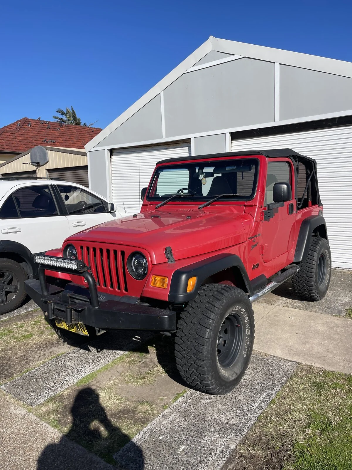

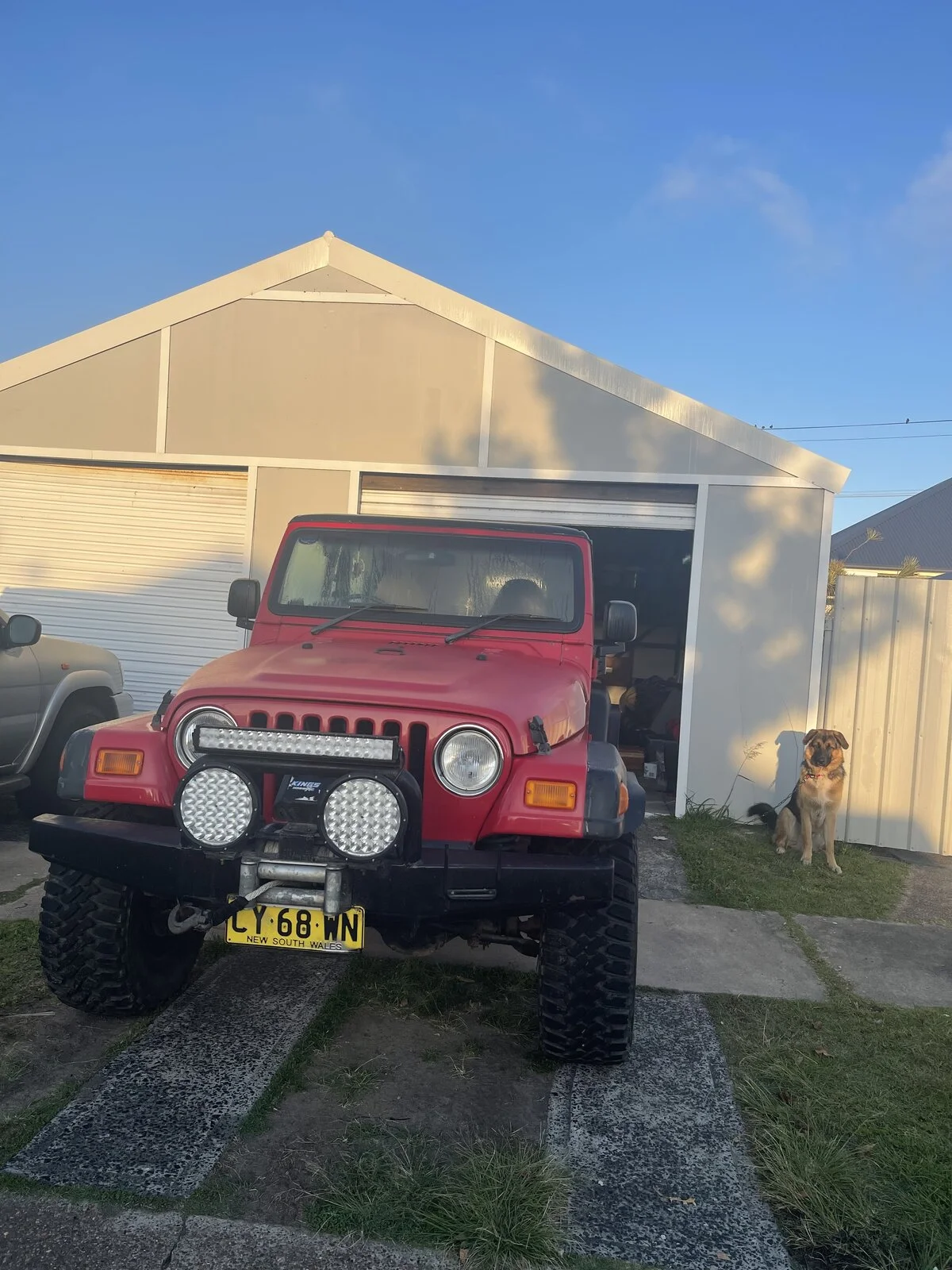

Attached are the photos from the first day I bought it and the first day it was on the beach. First few (purely cosmetic) things I did were:
  • Removed the 2 MASSIVE spotlights on the front.
  • Painted the wheels matte black. (I love black, and black and red look better to me than black, red and silver)
  • Painted the front bumper same color as the wheels
  • Got the spare wheel bracket off, just until I get a wheel to put on there.
I also did an oil change, a radiator flush and switched the radiator fluid to the GOAT stuff, and just a general clean up and got the back seat out.

Next up, I replaced my headlights to start going to a more blacked out look. I blacked out the headlight surrounds, repainted the flares, and sprayed the wheels matte black.
The Jeep also didn’t come with front sway bar end links, so I had to grab those and while doing so I got new rear sway bar end links and new rear sway bar bushings.
The winch that came with the Jeep was also completed faaaaarrrrked, so that needs to be replaced. I’m not sure if I’m a fan of the custom front bumper either, I’m a big fan of the little compact Smittybilt XRC, but in the spirit of not excessively spending money due to my baby arriving soon, I’ll hold off on that upgrade.
I seem to be having a u-joint problem at the moment which I have a different thread about. My goal is to just make sure this thing is reliable on the road and the beach before going too hard on cosmetic upgrades. Once I figure my u-joint issue out, I will start gearing up for a new rear bumper (still running the stock), and I am keen on getting new side steps.
