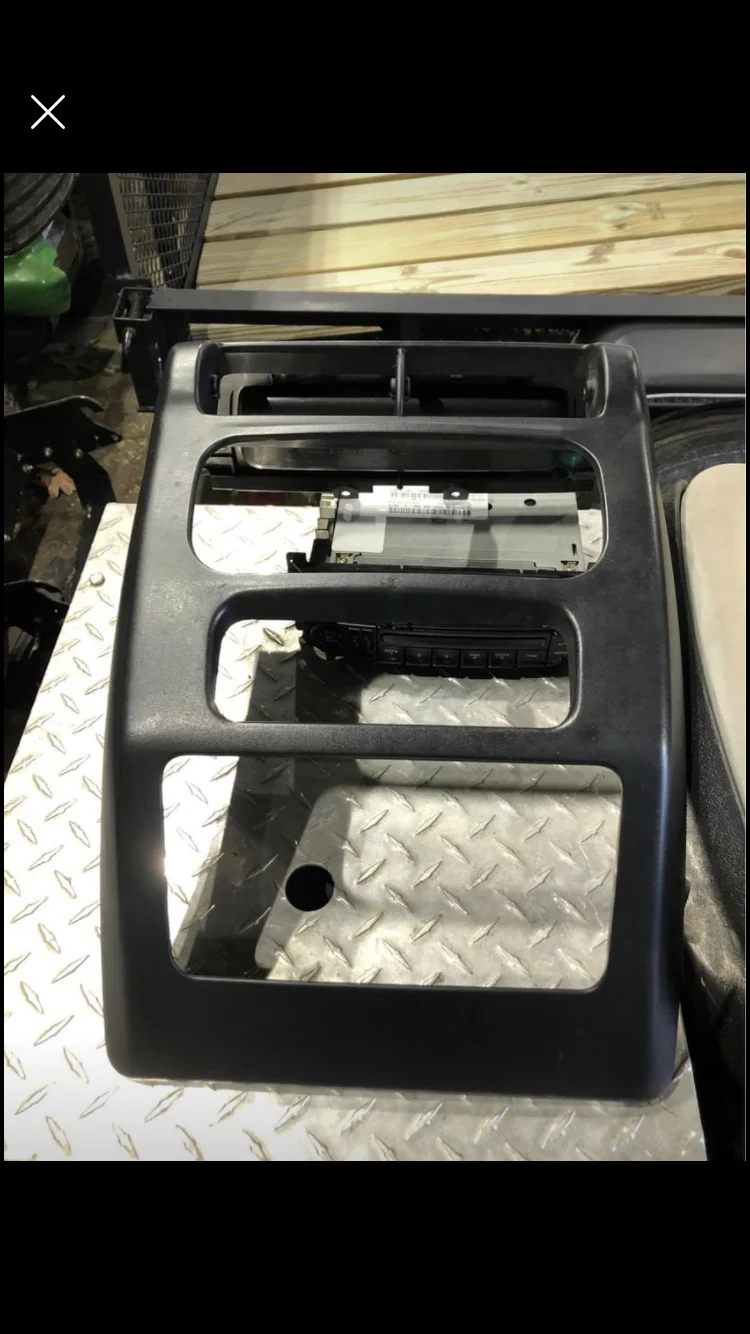

I have an 03-06 bezel for sale if you’re interested. In like new condition already packed up for shipment

No sir, just the bezel. See pic below
Are the vents included as well?
