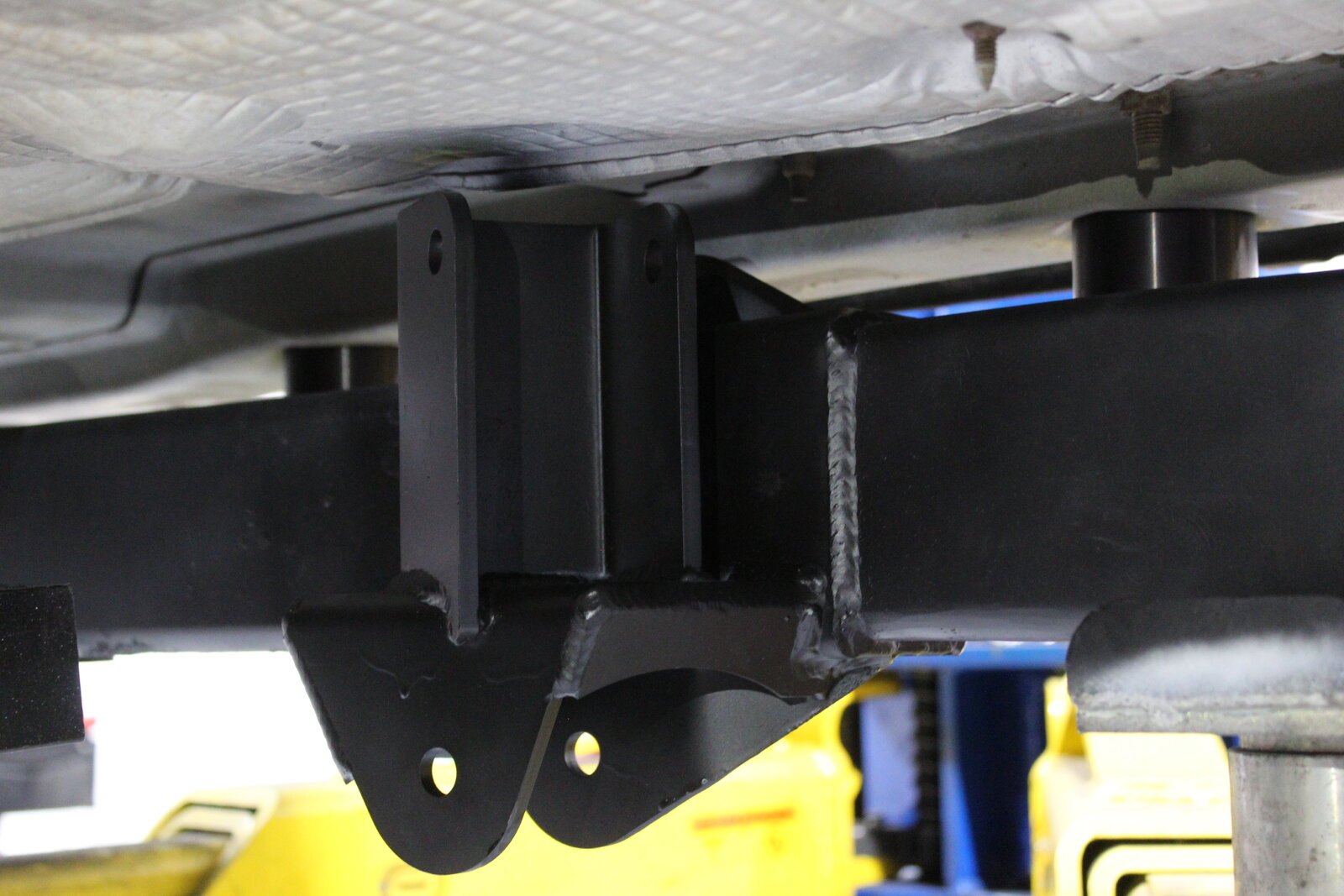

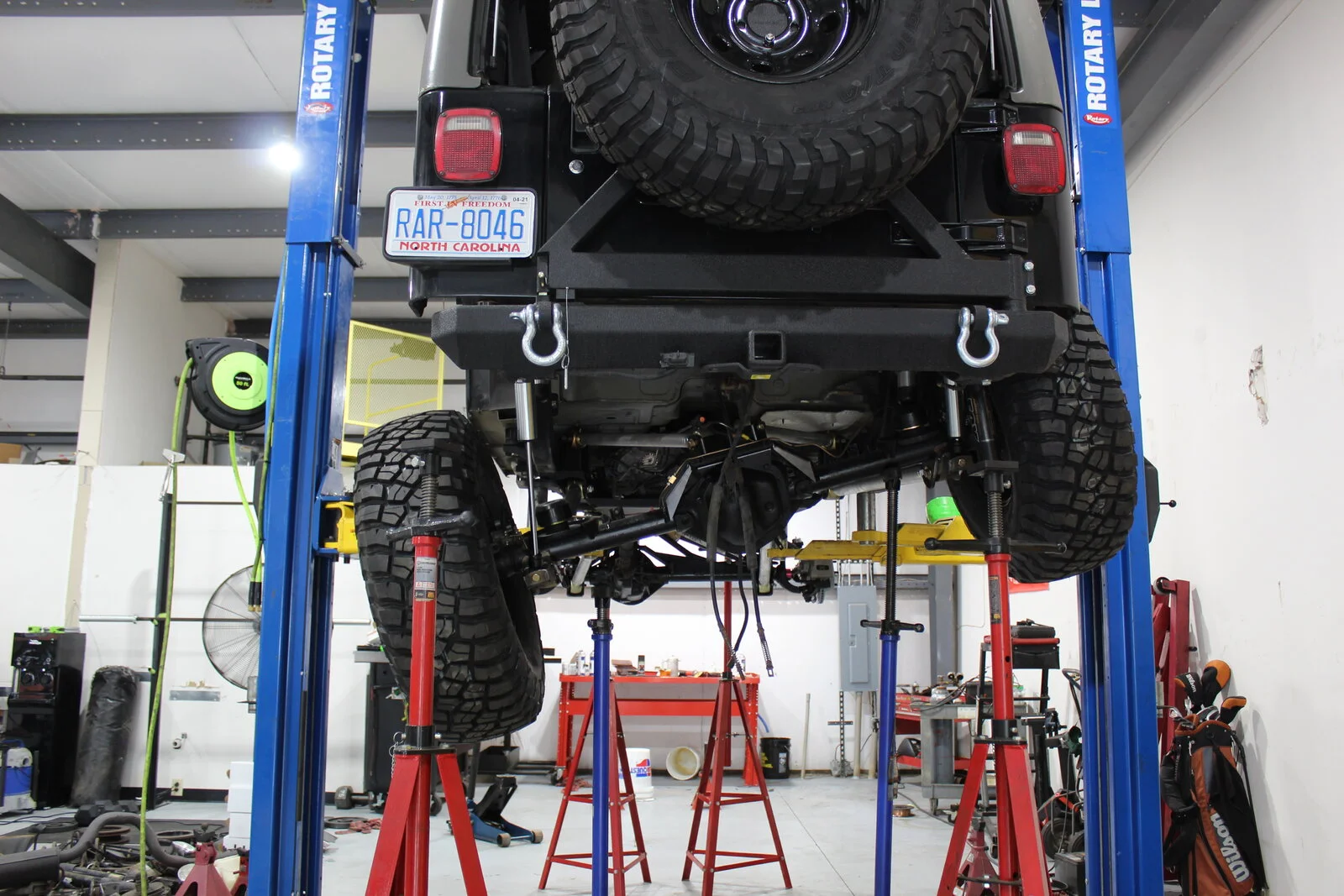

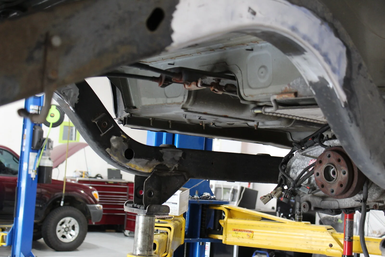

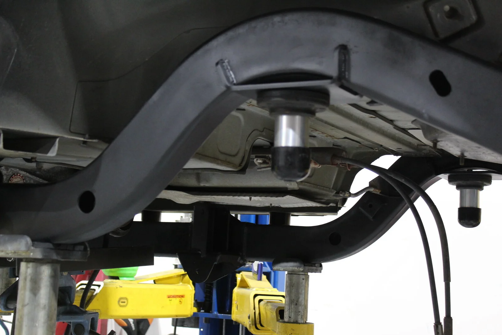

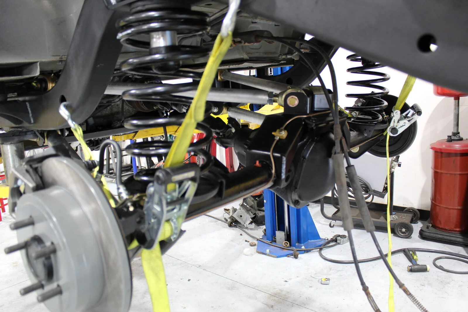

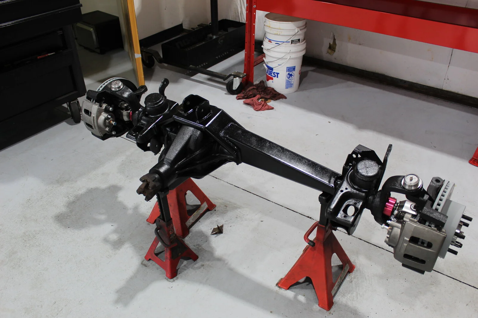

you do NOT mess around!
Really clean work man!
looks good!

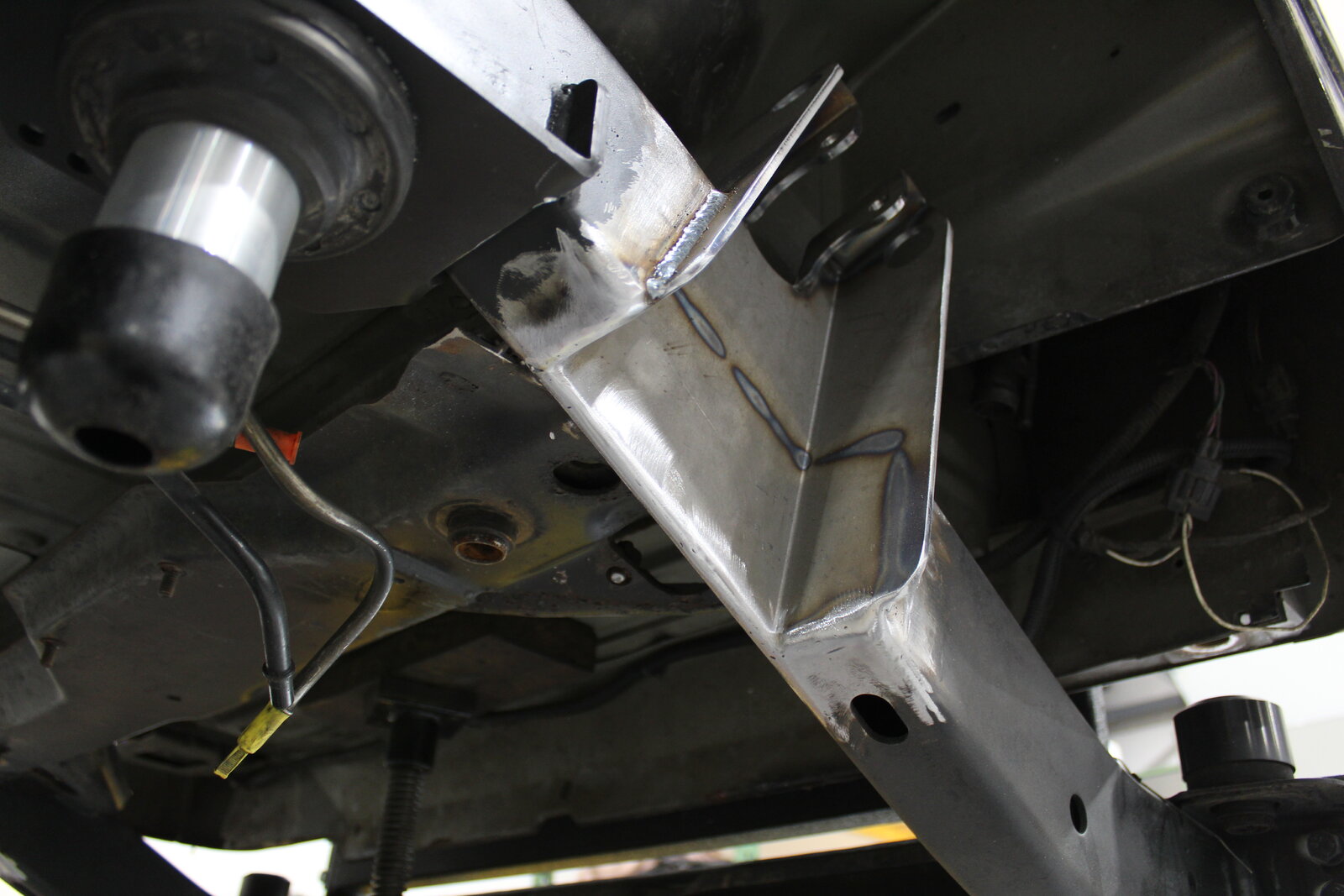

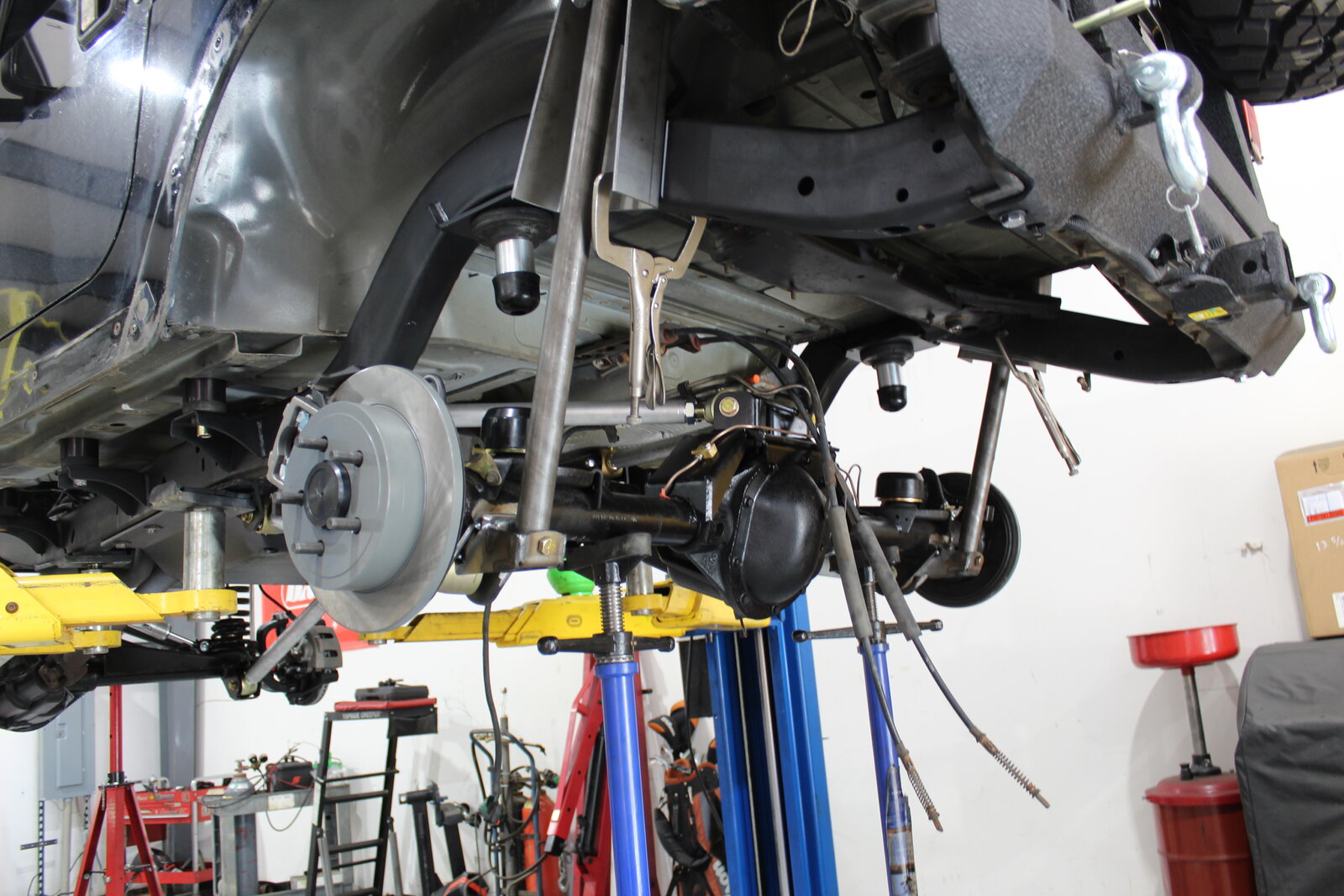

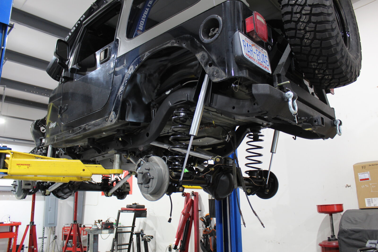

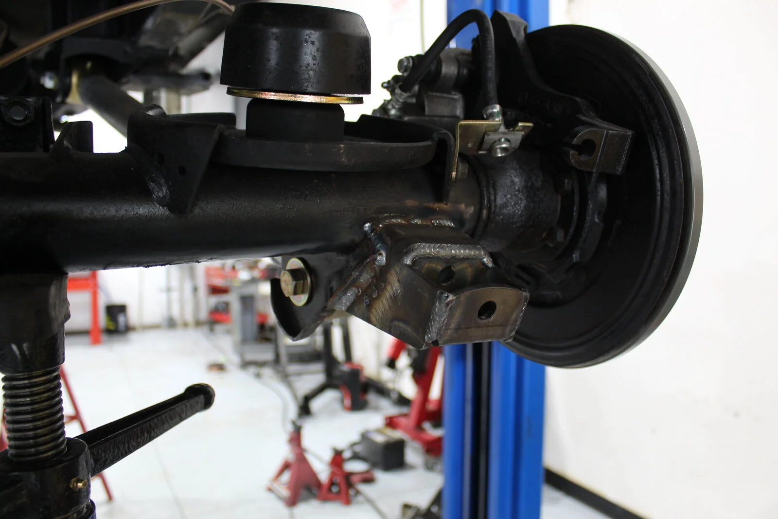

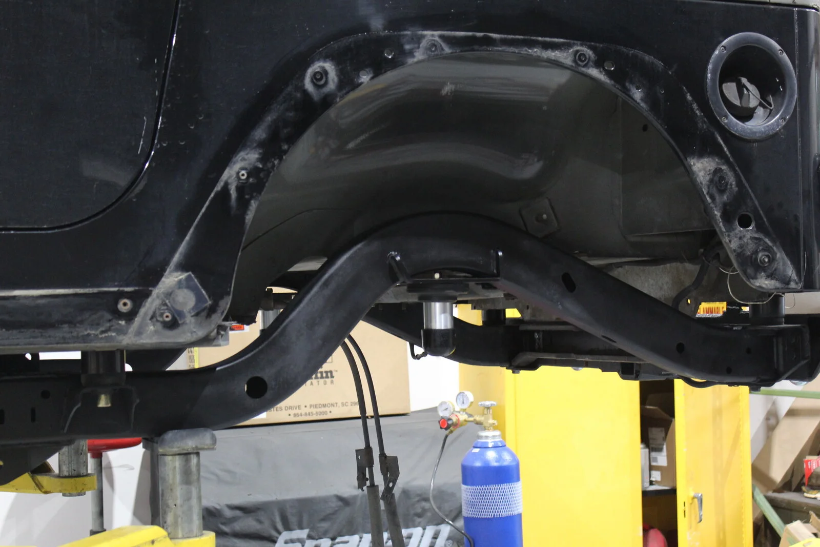

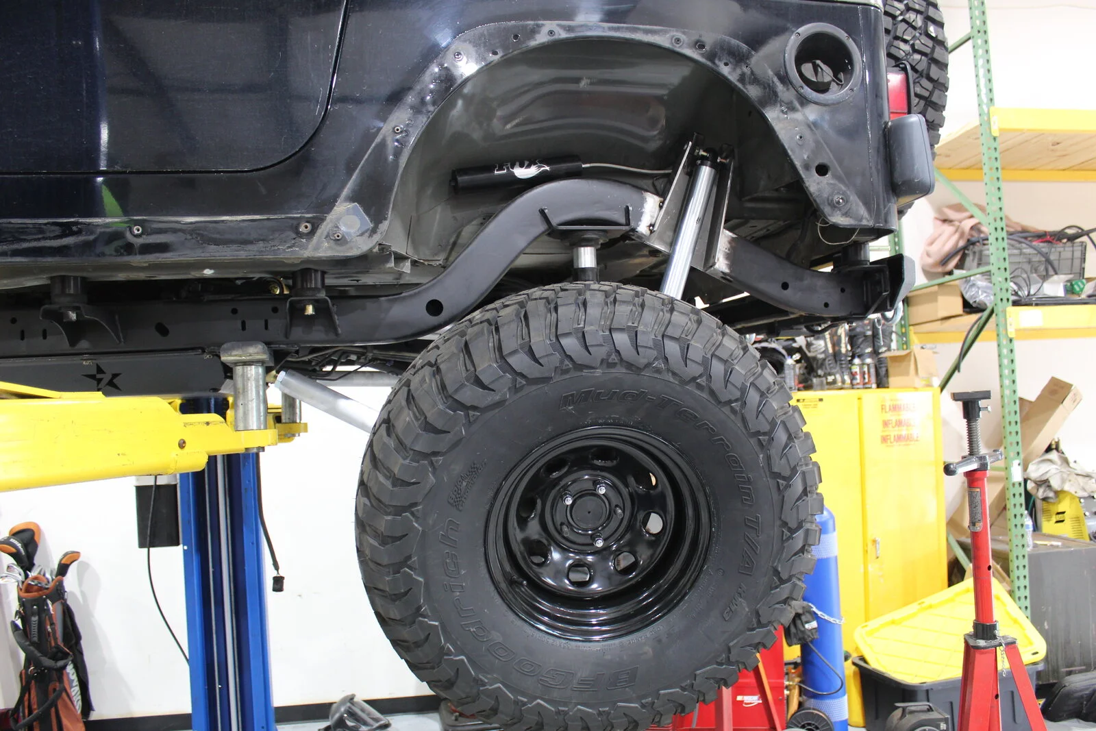

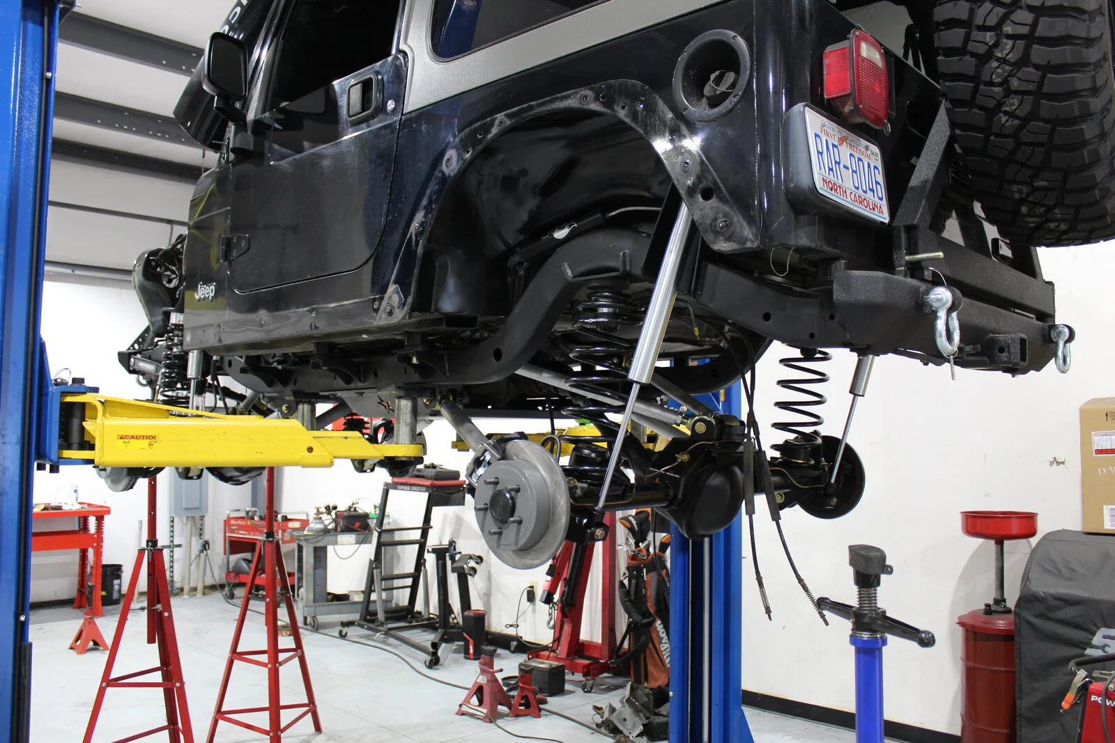

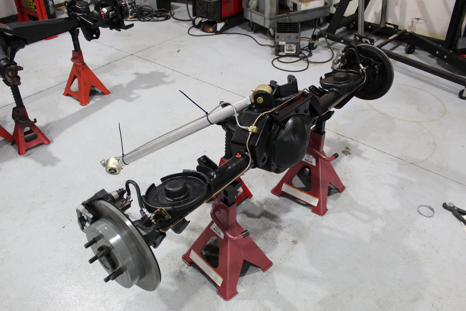

the only issue I see that could arise in the coming days is the hard brake line on the rear side of the axle, when you begin to figure out where to weld in lower shock mount when doing the outboard, those brake lines might be in the way...
Yea, it’s still dry and I planned on removing them to weld. I might relocate them all together. They are much lower than I thought and I’m worried they will snag something.
You are far more likely to back into a rock and crush them than snag them.Yea, it’s still dry and I planned on removing them to weld. I might relocate them all together. They are much lower than I thought and I’m worried they will snag something.
