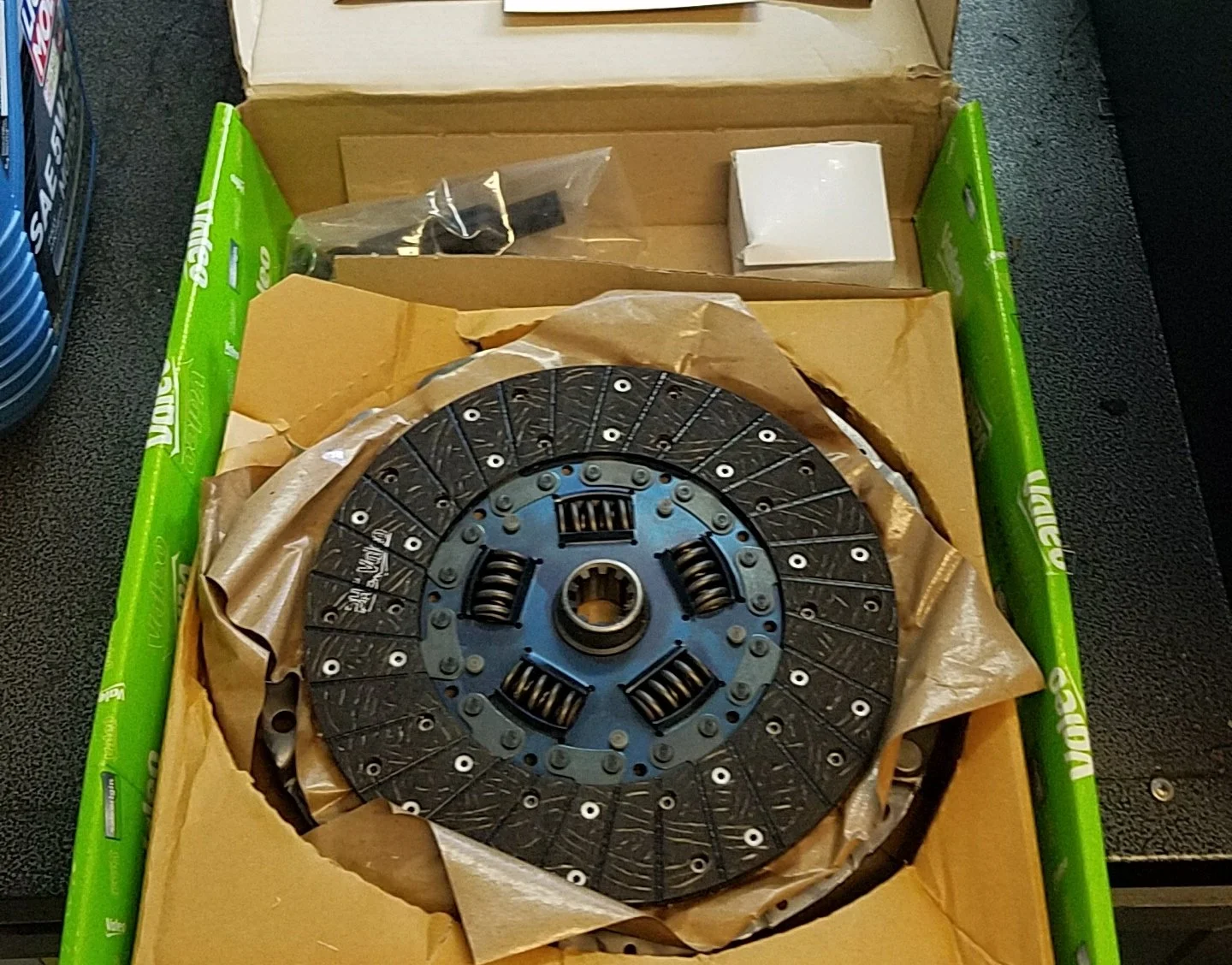

I used a Valeo kit. Everything was perfect. Only thing I did as well was change the transmission fluid.
Reactions: Chayton
