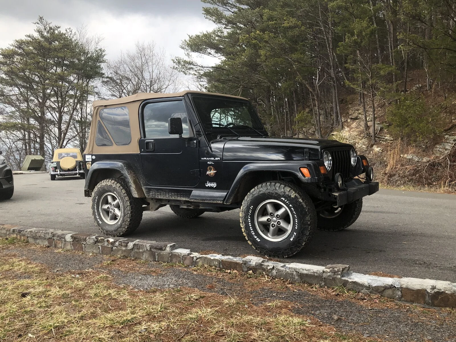

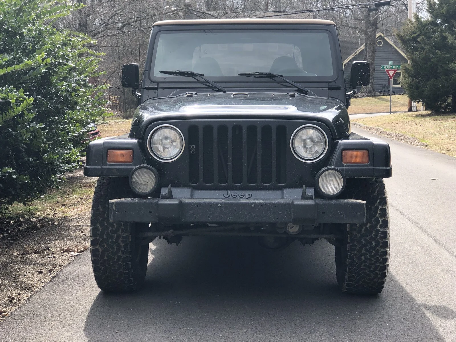

I just did the 1" H&R with Rancho RS5000X on my '98 with 125,000 miles on the stock suspension. Obviously, I have nothing else to compare it to, but freaking love how it turned out. I know everyone reports some different results in the lift gained, but I saw about an inch and a half gain. I didn't change or add anything else except for now jounce bumpers to replace the old ones that were basically gone.
It now has the stance I've always loved with a TJ and factory Grizzly wheels and 31 BFG KO2's

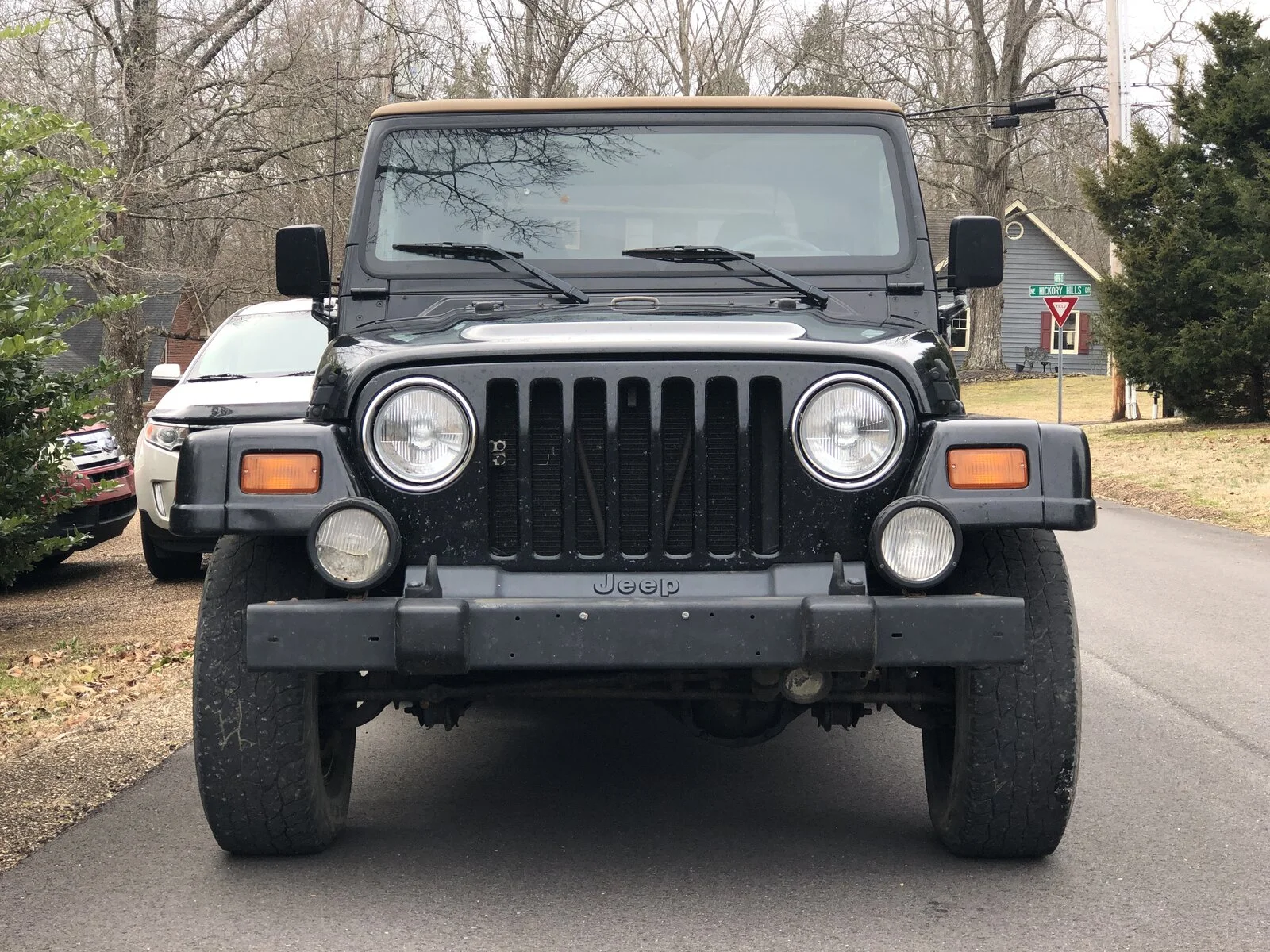

Stock with 235/75-15 tires
Looks awesome mate!
