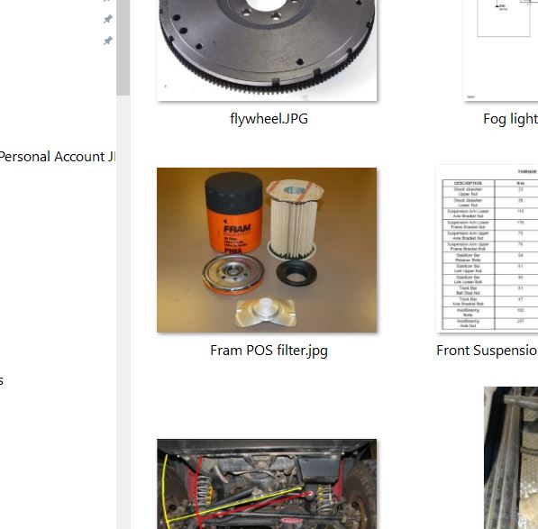

Pure bullshit. I used to think Fram filters were shit too.
I keep this photo as a reminder of how much I hated them at one point, it's a snip of where it sits my huge collection of Jeep related photos. Look dead-center...
As in Fram Piece Of Shit filter. I actually believed that at one time. In fact I looked forward to telling others how terrible they were... now I just feel stupid about it.
Unrelated to my feelings about Fram, I was one of about a dozen who were invited to visit the Fram R&D facility in Dayton Ohio where they tested their filters against all other filters. I was pretty shocked at what I saw and it totally changed my opinion. In fact I switched all my cars to Fram's better oil filters and I have been running their Tough Guard TG16 on my TJ ever since.
This documents my trip to Fram...
https://wranglertjforum.com/threads...it-to-frams-r-d-facility-in-dayton-ohio.1358/
Disagree with me all you want but I've been there done that and I learned my lesson. And nope, there is NO cardboard in any Fram filter. It might look like cardboard to some but it's not. And know too that the most basic Fram filter has a 95% filtration efficiency which is what many far more expensive oil filters have. Better Frams like the Tough Guard and above have a 99% filtration efficiency which is as good as any any similar cartridge style oil filter out there. Not many claim a 99% filtration efficiency.

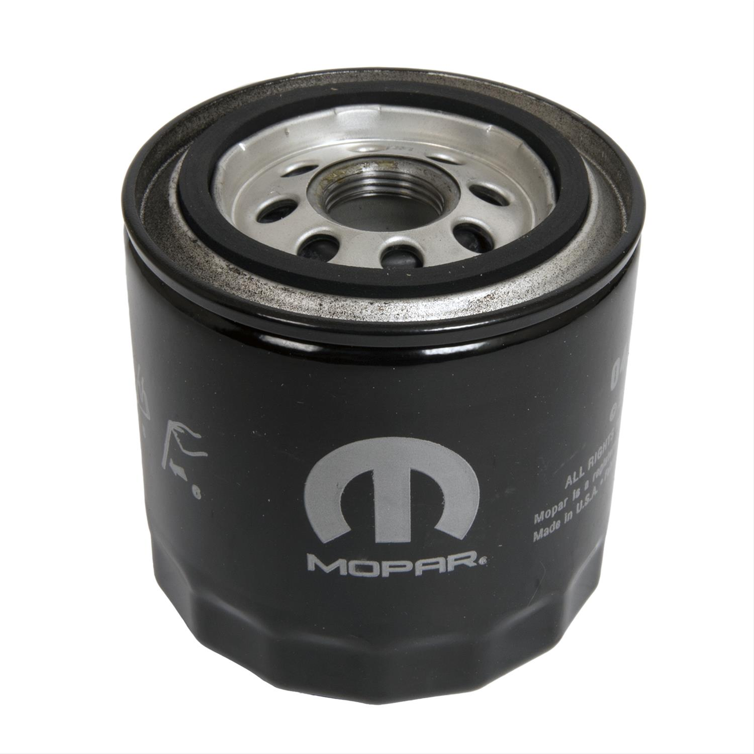

These articles are meaningless. Oil filters change construction so often depending on who the parent company of the brand is. OEM filters like the Mopar are usually a bit better, but that also depends on how the manufacturer specs the filter. The Mopar filters for example are nearly identical to the Motorcraft filters, but without the silicone anti-drain back valve. Both are made by Purolator.
Fram filters are pretty decent now. Those "fiber" end caps actually bond really well to the glue holding the filter media together. I've cut them open and getting the media apart was tough. I've cut open several Purolator filters with torn media. As always the higher end filters are usually better, but all brands have their not-so-great offerings. Wix used to be my go-to, but they recently were bought by Mann-Hummel and have been made much cheaper. The last three I used leaked at the base plate seam and were made in China.
