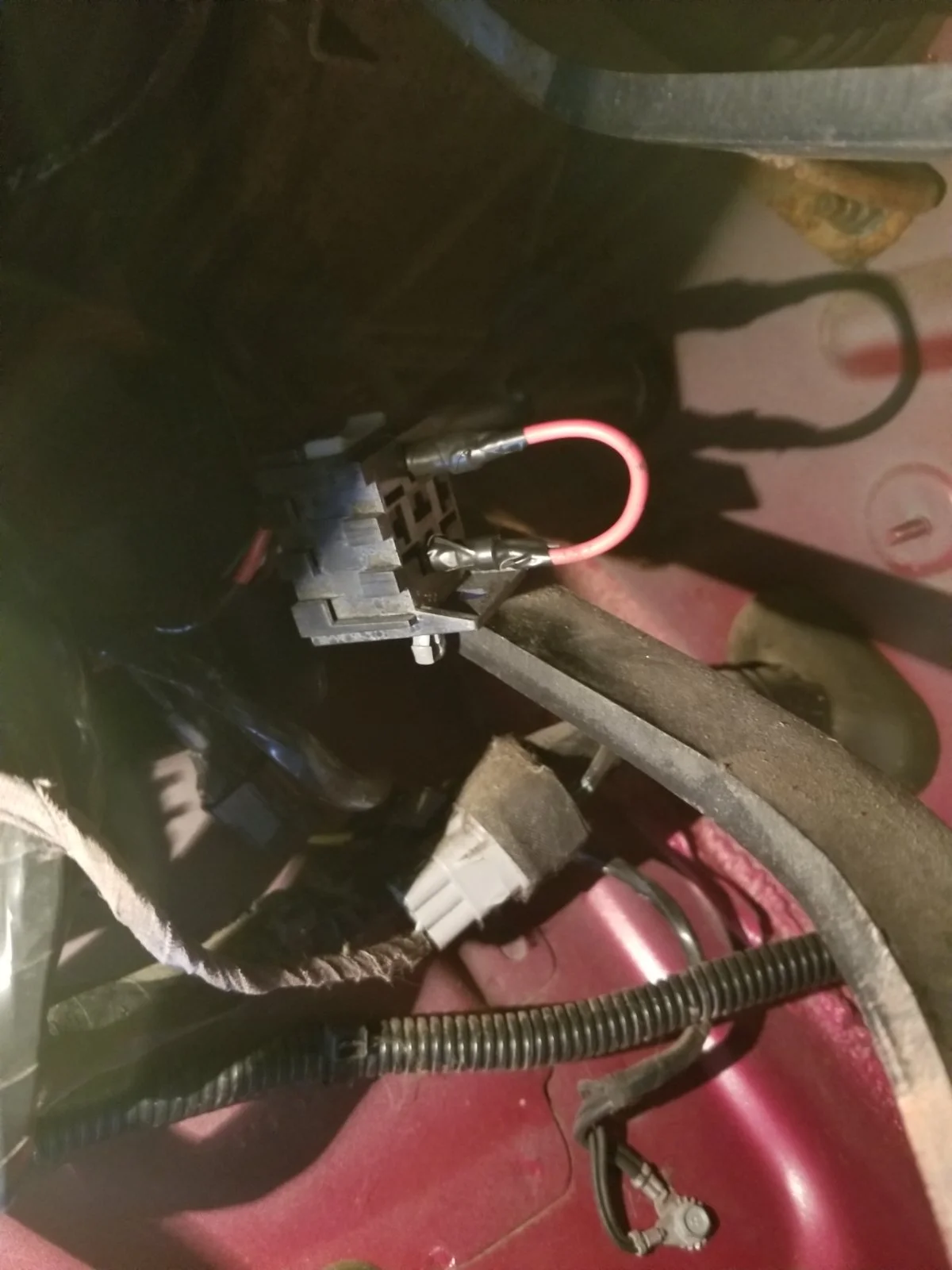

12 volt constant power from cigarette lighter
Black_Valkyrie
Mar 4, 2018
91
Internet
So easy little project... not sure if its been mentioned here... relay for lighter is under dash on driver's side on a bracket beside steering column. Pull the relay out and make a male to male jumper and install bridging terminals 87 and 30. This enegrizes your cigarette lighter socket regardless of whether or not the key is in the ignition.
