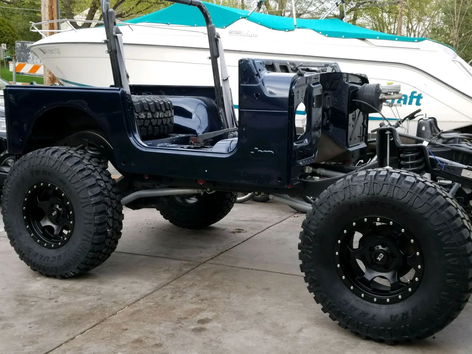

Hi finishing a build on a 1998 tj with LS1 5.3 ,4l60 tranny, liberty transfer case, has some custom work just got it driving down the road highway speeds . Has 37" tires . Zeus off road did the LS1 swap
Rockford MNRockford Michigan? That thing looks familiar...Nice Jeep! I like the CJ grill.
Right on. Sweet Jeep...And someone in Michigan has something similar!Rockford MN
Thanks
How much forward?How much did you pay for that LS swap? Looks awesome!
What's up with the bowing in the front coil springs? Looks like maybe your axle needs to come forward a bit?
The swap is crazy moneyHow much forward?
How much forward?
Looks like about a 1 1/2"No idea, you’d have to get under there and cycle the suspension to see how far forward it can go without things contacting, or the bump stops becoming misaligned with the jounce bumper.
