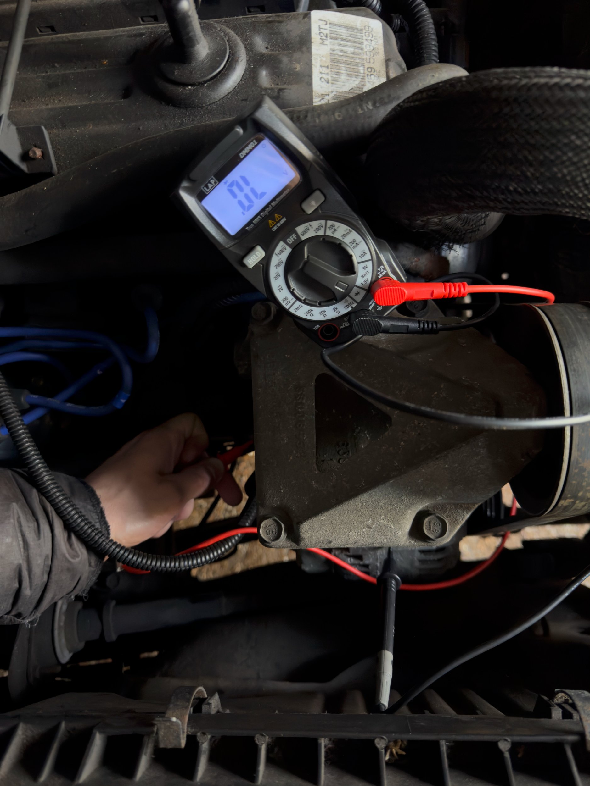

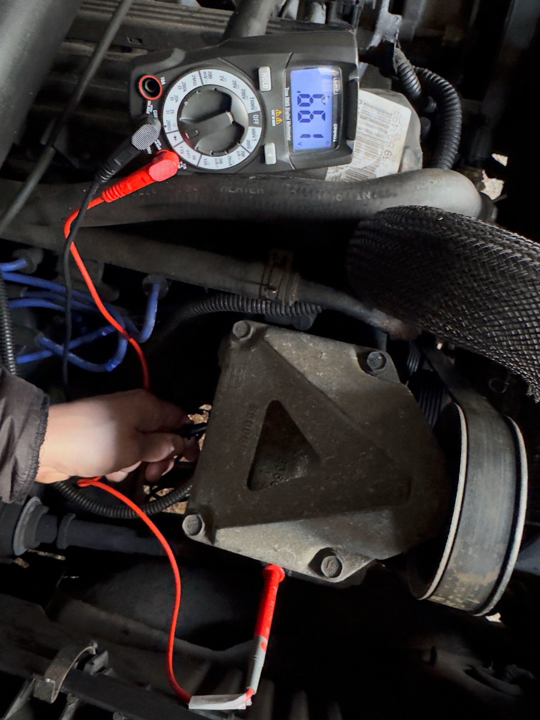

Putting the idle issue aside, I'd like to identify the parasitic draw.
I followed the tutorials on parasitic drains – disconnecting the negative cable, running a multimeter in series, with all doors closed, left off for 30 minutes etc... which resulted in a reading of 0.22 amps.
The battery reads 12.8V across the terminals with the engine off, 13.93V when the engine is running.
I have been charging the battery with a maintenance charger intermittently.
Following advice on here, I read the voltage across each fuse in the fusebox behind the glovebox and under the hood – nothing.
I pulled every fuse one by one, keeping an eye on the amp reading – but no change.
I pulled every fuse and relay all at once – still no change, still showing 0.22 amps.
I removed the interior lights, aftermarket radio and checked for any aftermarket alarm etc – still no change.
Further advice pointed to the alternator, starter or PCM, so I disconnected the wires to all of them – still the draw persisted.
Most recently, when I charge the battery and turn on the ignition, I can hear a relay under the steering wheel clicking on and off randomly.
Using a jump battery, it still starts, but it's rough as hell and stalling out without applying some gas – I assume this is because I am leaving the battery leads disconnected, so the PCM is resetting each time?
Any other ideas what could be causing this, or what I'm doing wrong?
