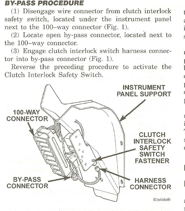

Have you installed the bypass for that as described in your Owner's Manual? It's what allows the starter to be engaged without the clutch pedal being held down. It's done either by moving an electrical connector above the driver's side footwell like shown below. Or it's done by installing a fuse in either the #4 or #10 position behind the glove box, I forget which. How the clutch position switch is bypassed changed from moving the cable connector to inserting a fuse but I don't recall when that change happened.
I can hear and feel the starter relay open in the PDC when i have someone turn the ignition. yes, too, the bypass done is with moving the fuses behind the glove box.
