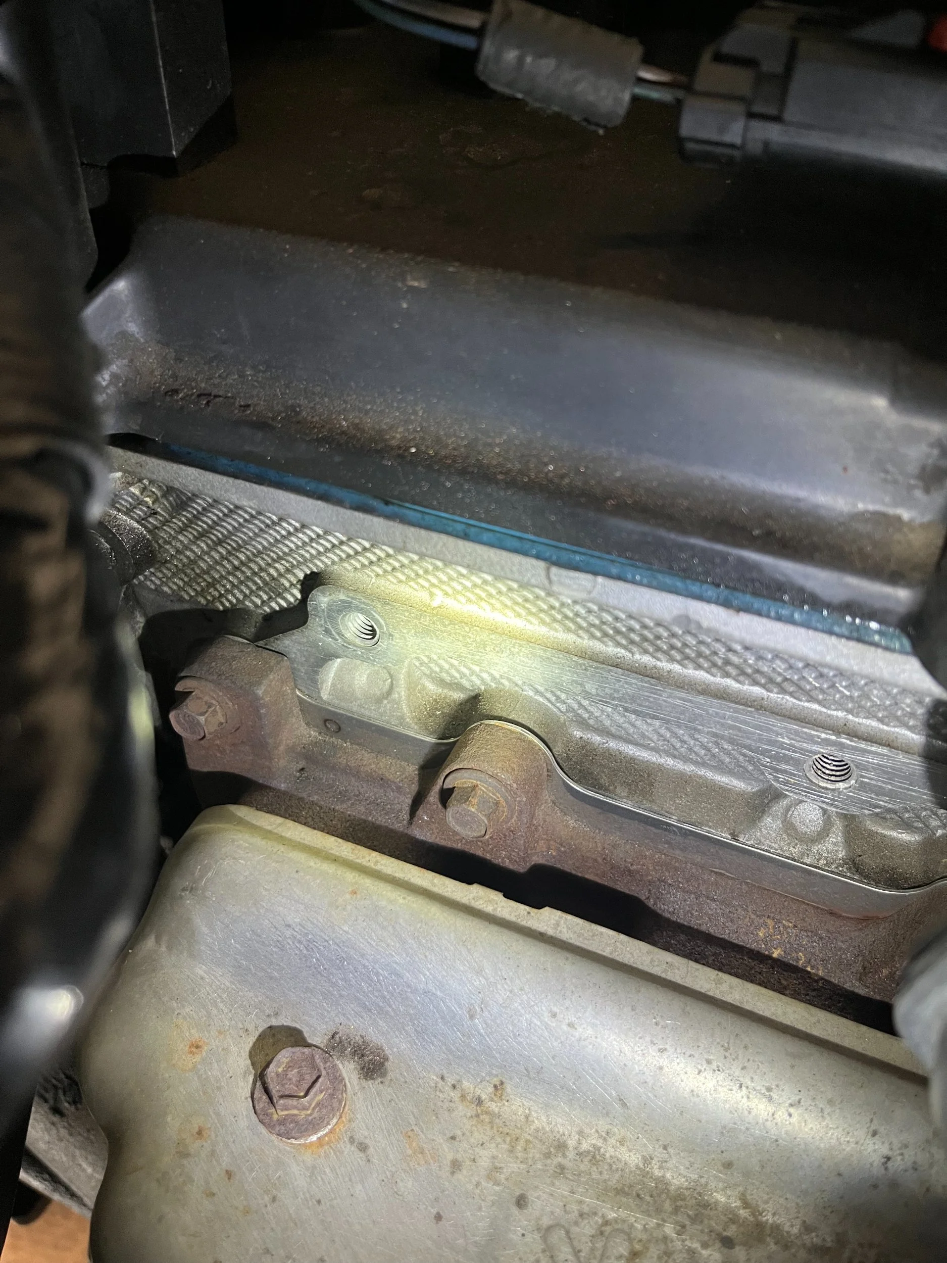

Hi! wondering if someone with the 2.4l could help me find out if im supposed to have a ground in this place of the engine block?
There are two holes with thread but the one in the left has a mark around it like if something was there before. I know that the 4.0 has one ground around that area and one in the back.
Any info will be very helpful,
Thanks
Hi sr, wondering if you have any luck solving the problem? It was the pcm bad?
The most probable factor in restoring mine to running was splicing in a new connection to ground for the PCM directly into the wiring harness near that plug. PCM was not bad
