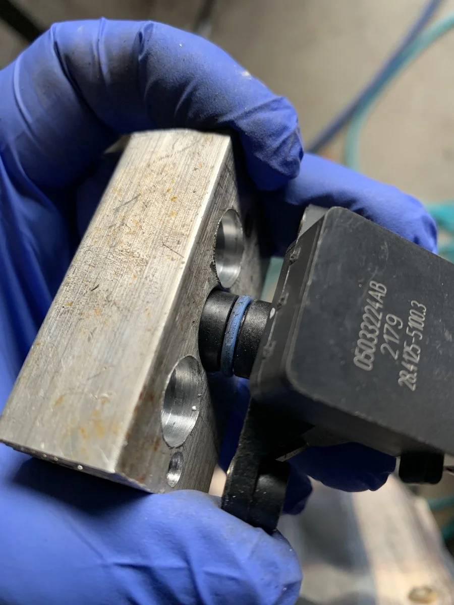

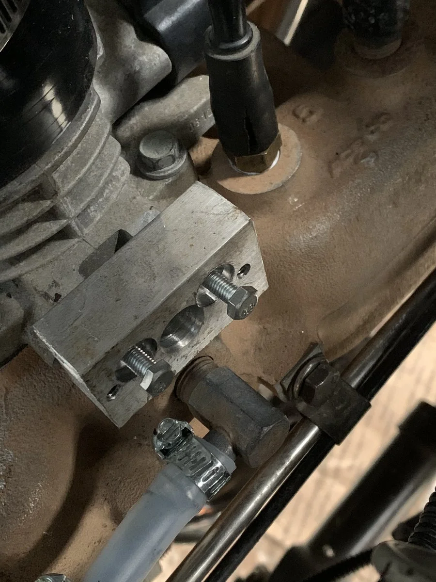

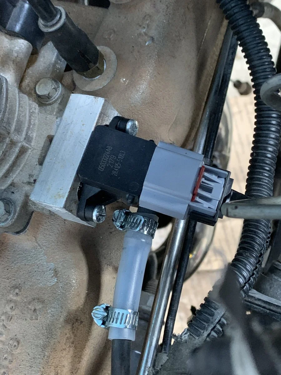

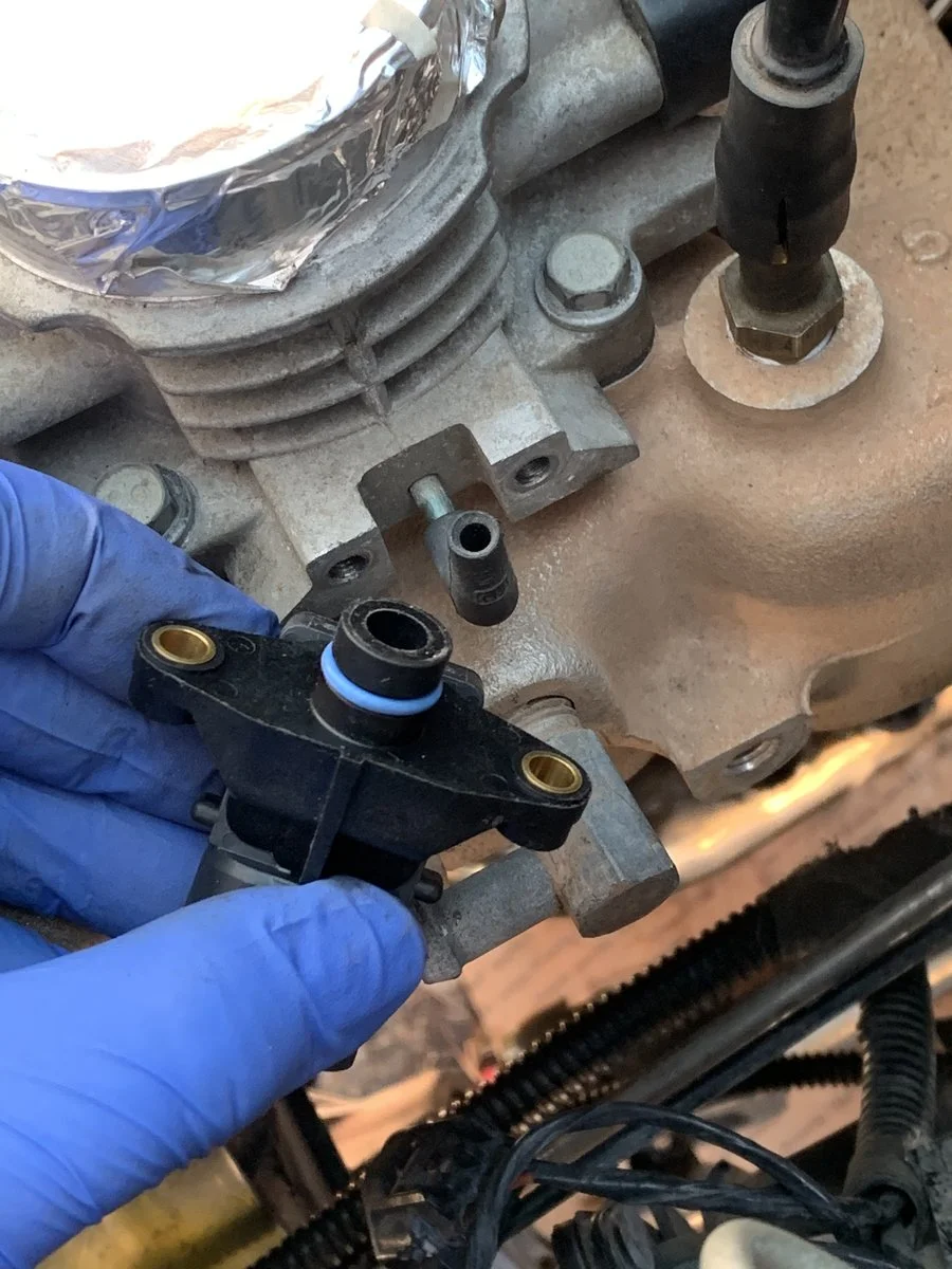

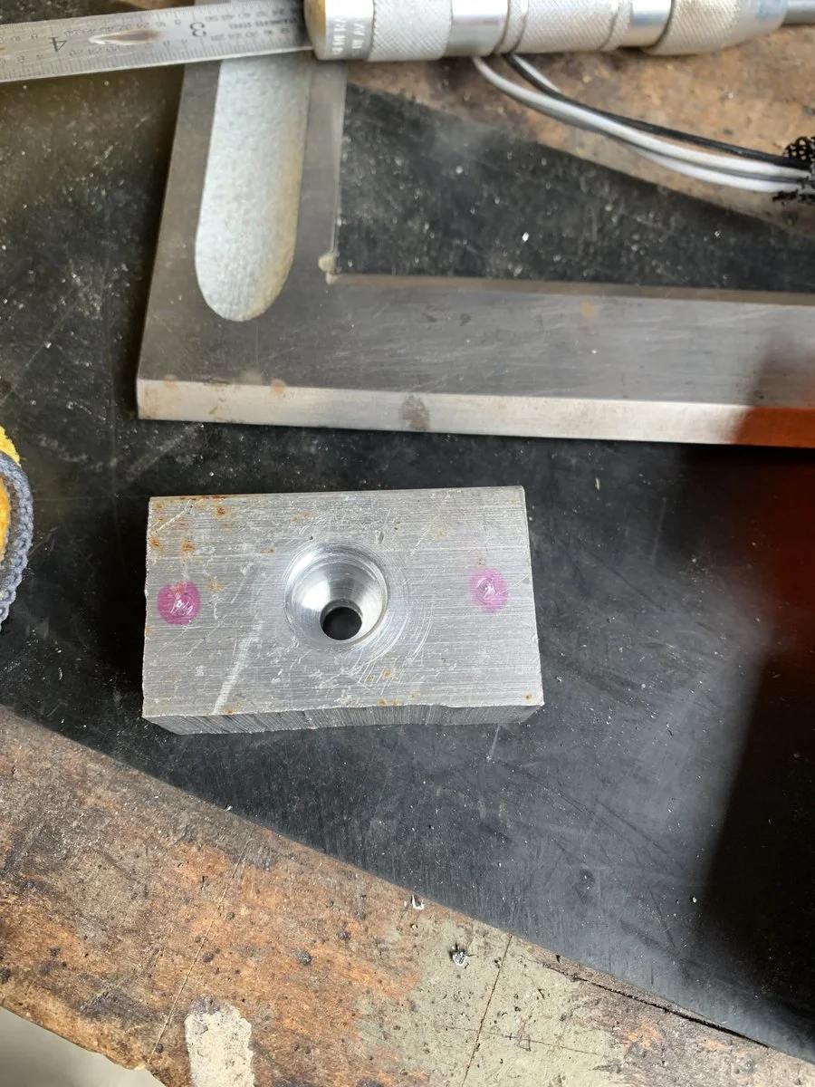

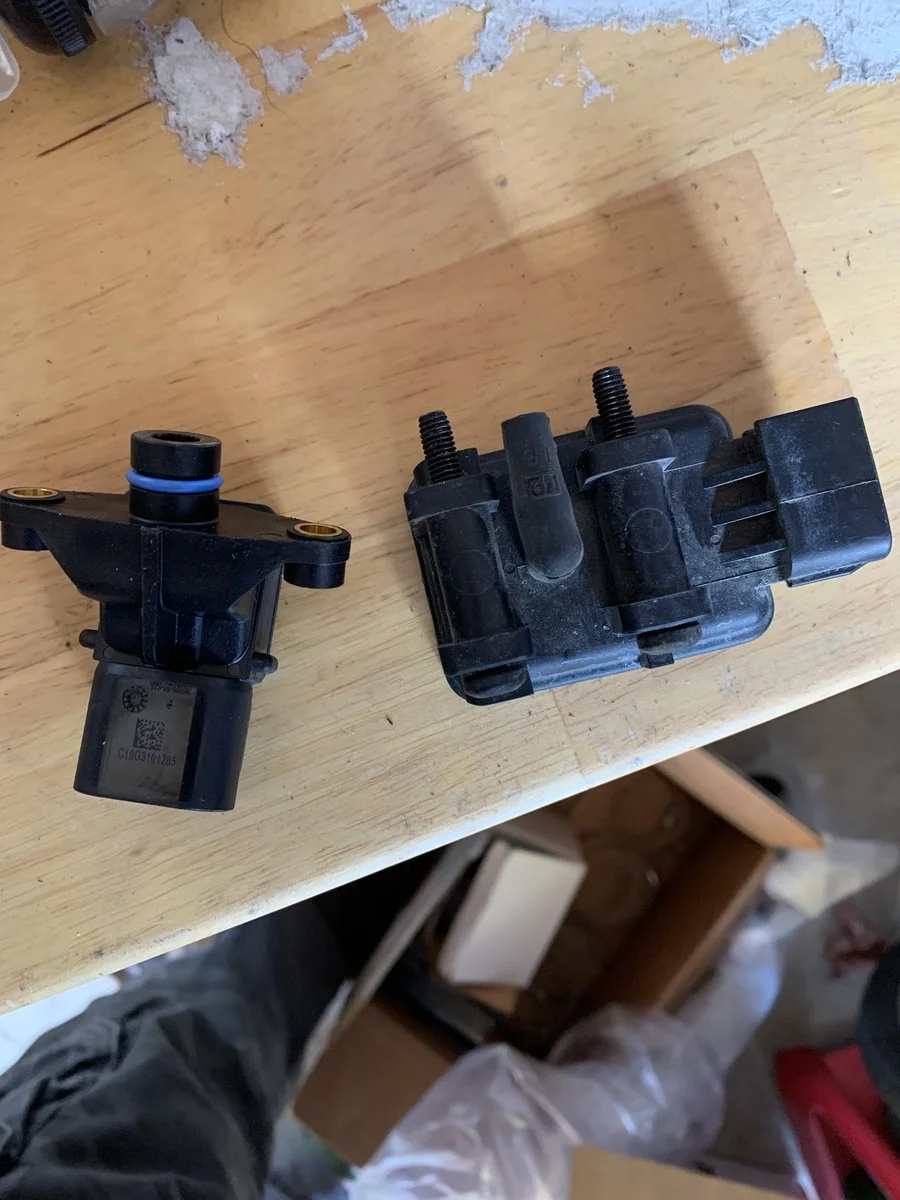

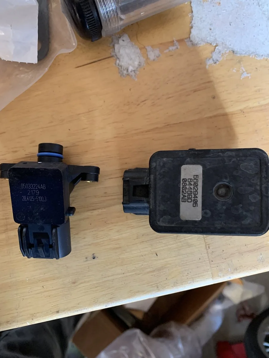

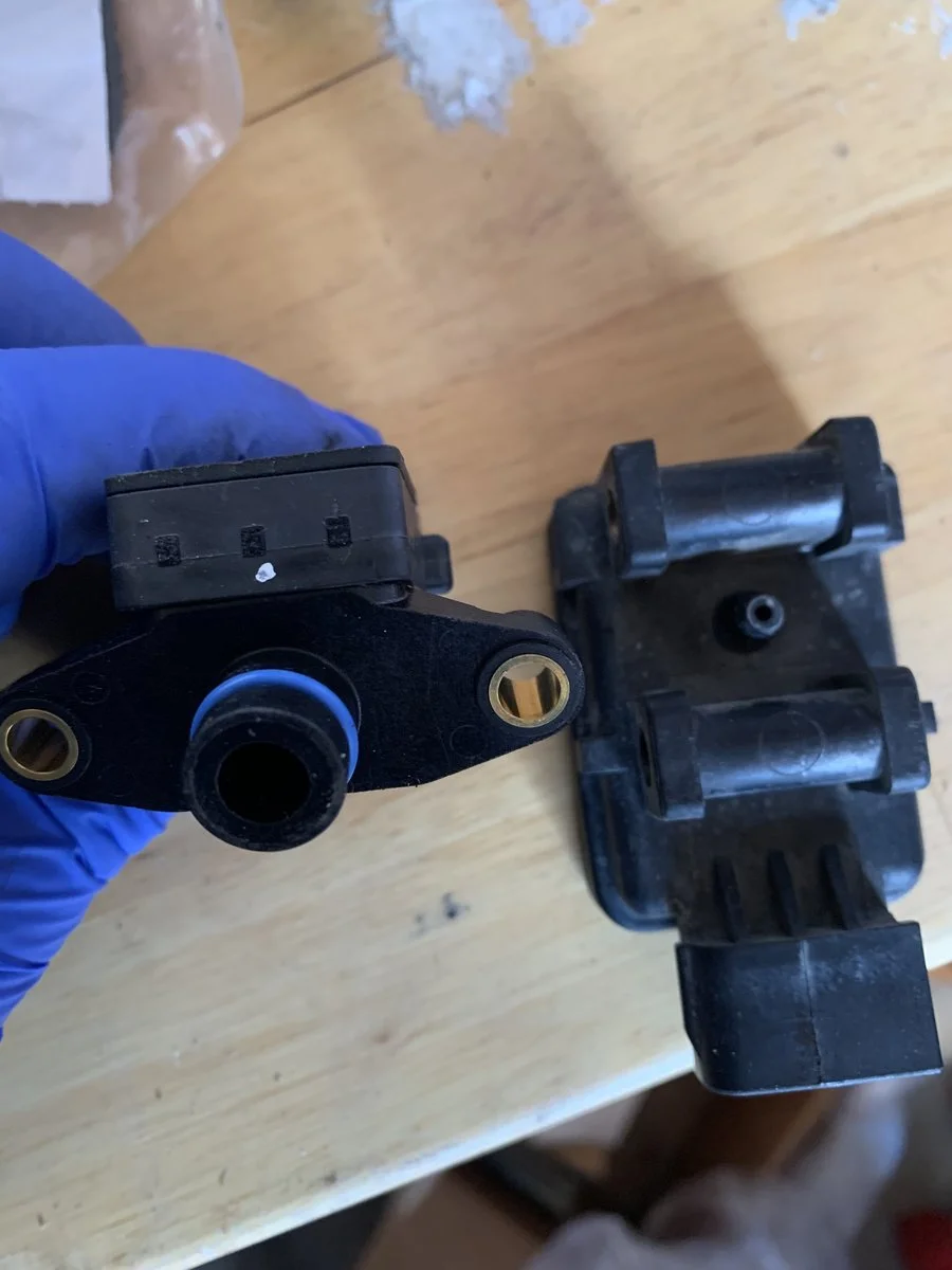

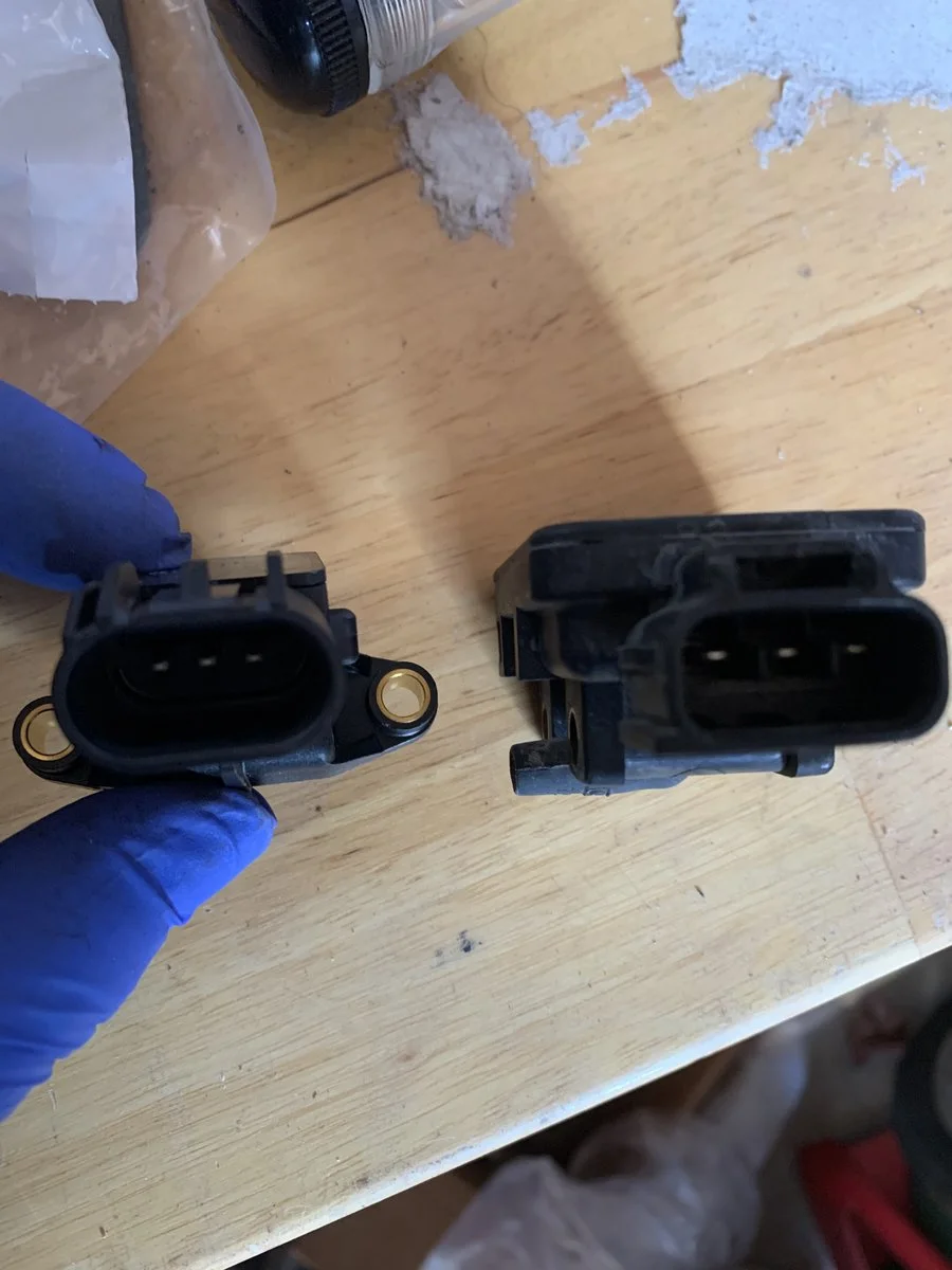

I ordered a 2 Bar Map sensor to with the turbo and larger injectors I’m putting on but it’s not the same as the old one. Is there and exact matchup or do I have to make and adaptor?
It’s a Mopar part I think for an SRT. Stock one is on the right.

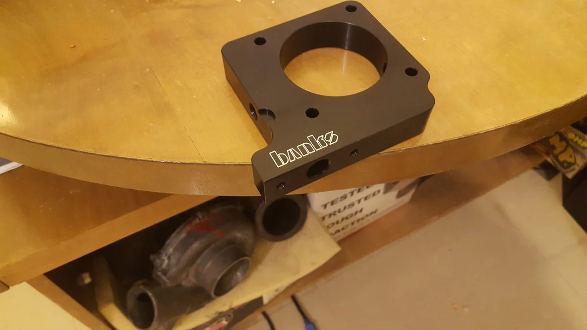

I just got the banks MAP sensor throttle body thanks to the information in this thread , its not 40 $ more like 90$ but still worth it i guess .
