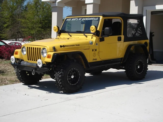

NOBODY knows what you're using your Jeep for. The only thing that matters is "what do YOU think of a 2" lift with 33s and BushCracker flat flares?" It's your Jeep, don't ask other people their opinions unless you like negative comments. Flat flares are an illusion of more clearance. Having 4" of lift with 33s doesn't make any difference for mud, maybe for rocks. There is no given setup that is a must for everyone's needs. Here's a 2" lift with 31s and flat flares. You would have 1" less tire/flare clearance with 33s.

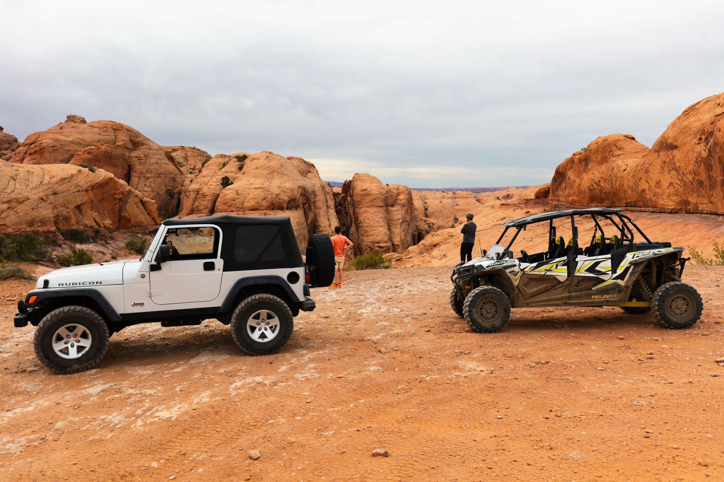

Depends on how you're going to use it. Daily driver for me often on mild unmaintained access roads to dispersed camping locations and outer beach soft sand. No rock crawling.
I have 2.5" SL.. no BL.
33x12.5's on 15x8.5
BW flat flares.
Zero issues.

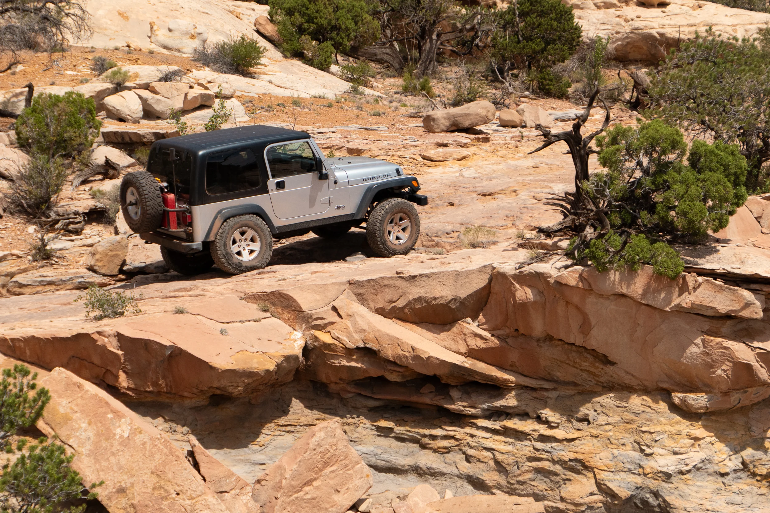

I run 33s with a ~2.5" lift and Rubicon flares and have for a long time. They can rub, particularly in the back when the flex is pushed, but they serve me well in the way I usually use the Jeep. Usage similar to @MikekiM minus the beaches and the commuting. I can confidently drive to any trailhead in the Colorado mountains, but know my limits in rock crawling.
No body lift.
2.5" Rancho springs. Replaced tired stock isolators with 0.75" polyurethane ones.
285/75R16 BF Goodrich TAKO 3
Loaded down extra heavy going far into the Maze w/front axle swaybar still connected.
Normal ride
