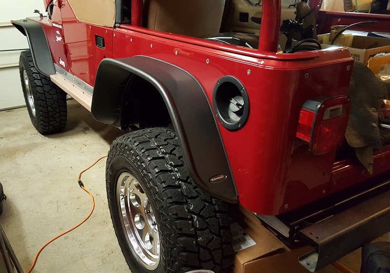

I did a test fit on Bushwacker flares and didn't like the look. Ended up removing them and going with stock flares.
If I were looking for replacement flat flares, it would probably be MCE.
https://www.mcefenders.com/products/jeep/tj
Thanks for sharing that pic! I was a little worried about that super wide opening look too.

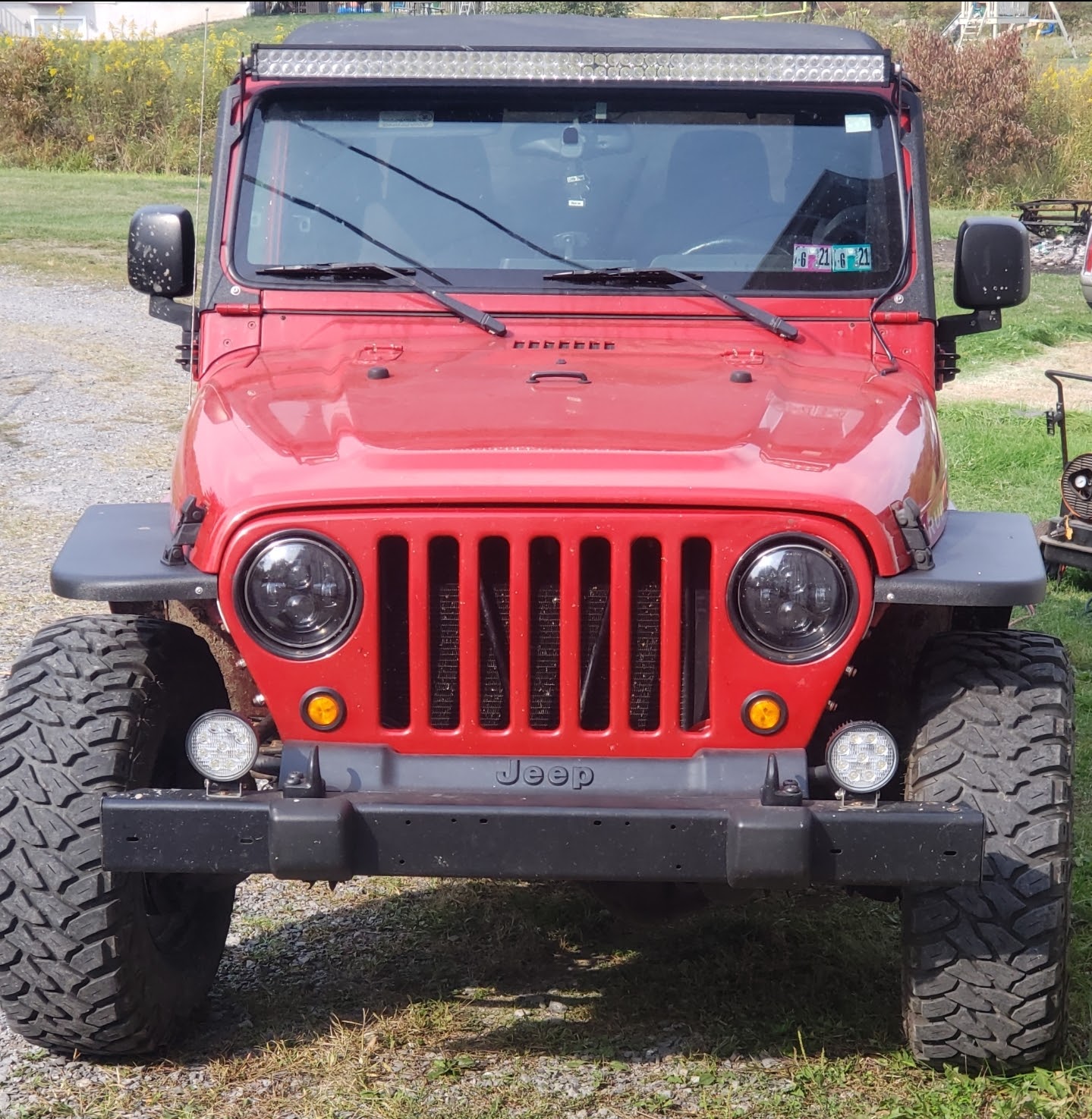

MCE help some with clearance since they allow upward flex replacing the stock fender. @jjvw problem is his keep blowing off.
Reactions: WHBNM
Only the rears blow off if installed normally.
The fronts will only start to flex under articulation with 35s and more than 11" travel and 6" of up. Very few are ever going to have that. I'm still working on it.
