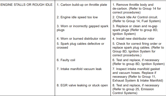

Just checked the 2000 FSM
Guess i'll check these...
